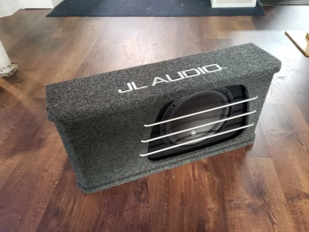

I'll give JL credit where due, the box looks fantastic and I understand why they kept the pocket but that little pocket is killing the ability to get down low, it's probably halved the box's volume.
If JL sold these bare for about $250-300 without a sub I'd buy one and modify it to remove that pocket, I'd guess you could get close to 0.75 cubic feet doing that.
I've got a really nice Alpine sub that works great in small volumes and my DIY box fits and looks ok but this is CLEAN.
The only way to come close to .75 cubic foot for a box under the rear seat. Is to use the entire space under both sides for a single sub.
I would say if you utilized every square inch of space in that under seat storage area you might come close to 1 cubic foot.
Exactly, the JL box without the pocket maybe will give you .3-.35. groundshaker or the cheap eBay option are much better routes
I agree. I have the Ground Shaker box for the p.s. and I believe it's .45 cubic foot. I'm already kicking myself for not buying the dual box package for $310. Which gives you the second box for only $90, 2 is always better than 1.
Ford Maverick JL Stealthbox Install / Review 20241030_151136
You had me second guessing myself so I had to check back to see the photos I took when building my box and you're mostly correct.
I'd done a basic popcorn peanut volume measurement of the tub and each side was about 0.85 or so, that's probably where I got thinking about 0.75 for the JL.
