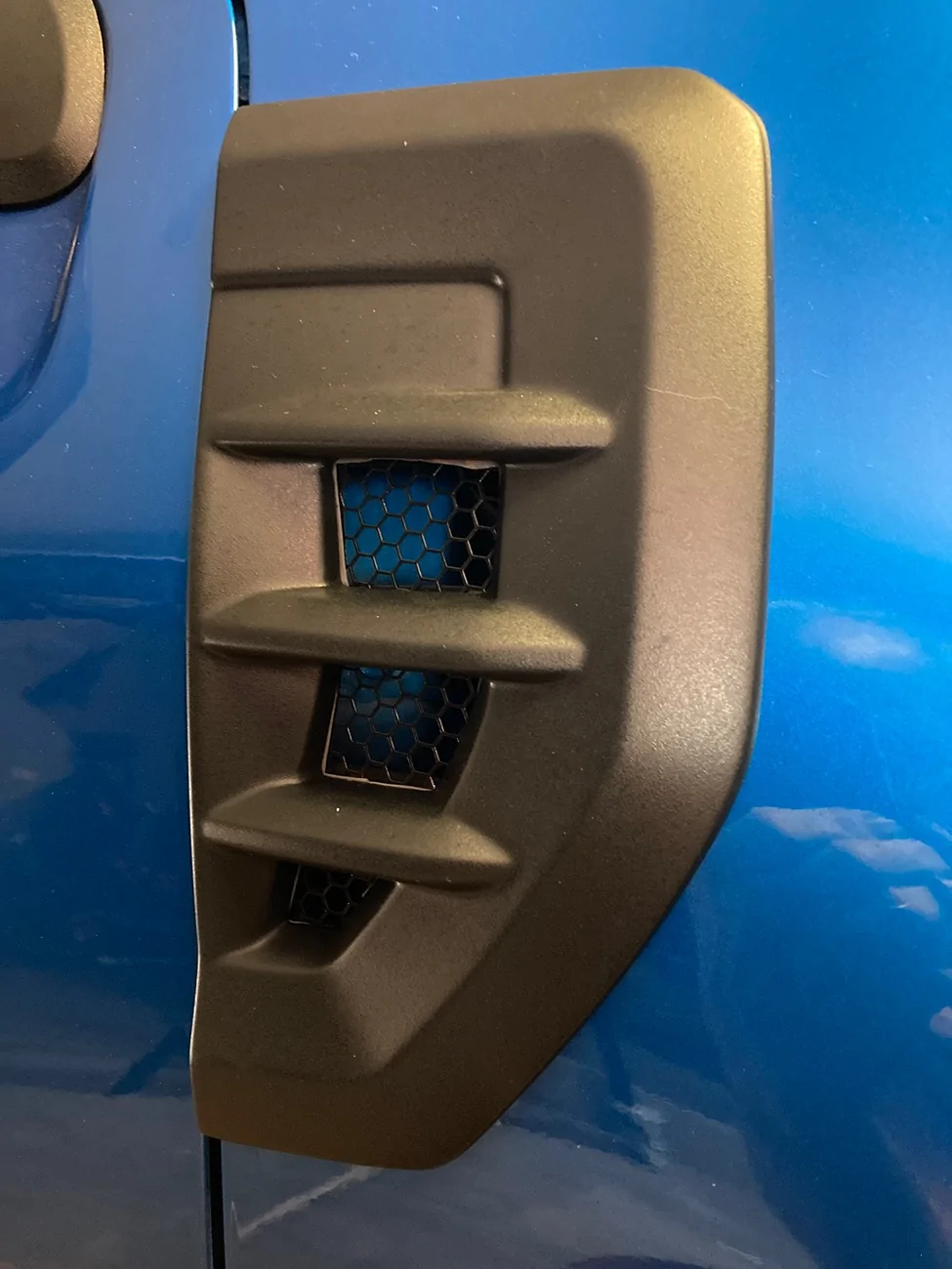

Decided to spice up the factory fender vents. I'm not a huge fan of the Air Designs ones, so I decided to add some mesh to my stock ones. I'm leaving this for anyone who wants to do the same. The only costs were $10 for the epoxy and $30 for the mesh, and that gave plenty extra. The only tools required are a dremel with a cutting wheel and sanding attachment.

Using a dremel to cut out the middle
Using JB Weld plastic epoxy to secure the mesh
Compared to the original

Awesome work! That’s exactly what I wanted to do!! Which side did you dremel the cover from, inside or out?
I cut from the back side and then sanded the sides to be flush. You could cut from the side but the tabs will get in the way.

I removed my Air Design Functional Vents and put the OEM back on. Air Design ones were a bit too big.
I did like the air openings however - and your DIY job looks fantastic!
Question - did you Dremel from the outside or backside of piece?
I was going to get the Air Designs ones but wasn't sure I'd like how much larger they are. I figured I'd try this first, and it's a lot cheaper. I cut from the back and then sanded the edges down flush on the sides. That was the easiest way. Cutting from the sides would probably leave a nicer finish but the tabs will get in the way while cutting
