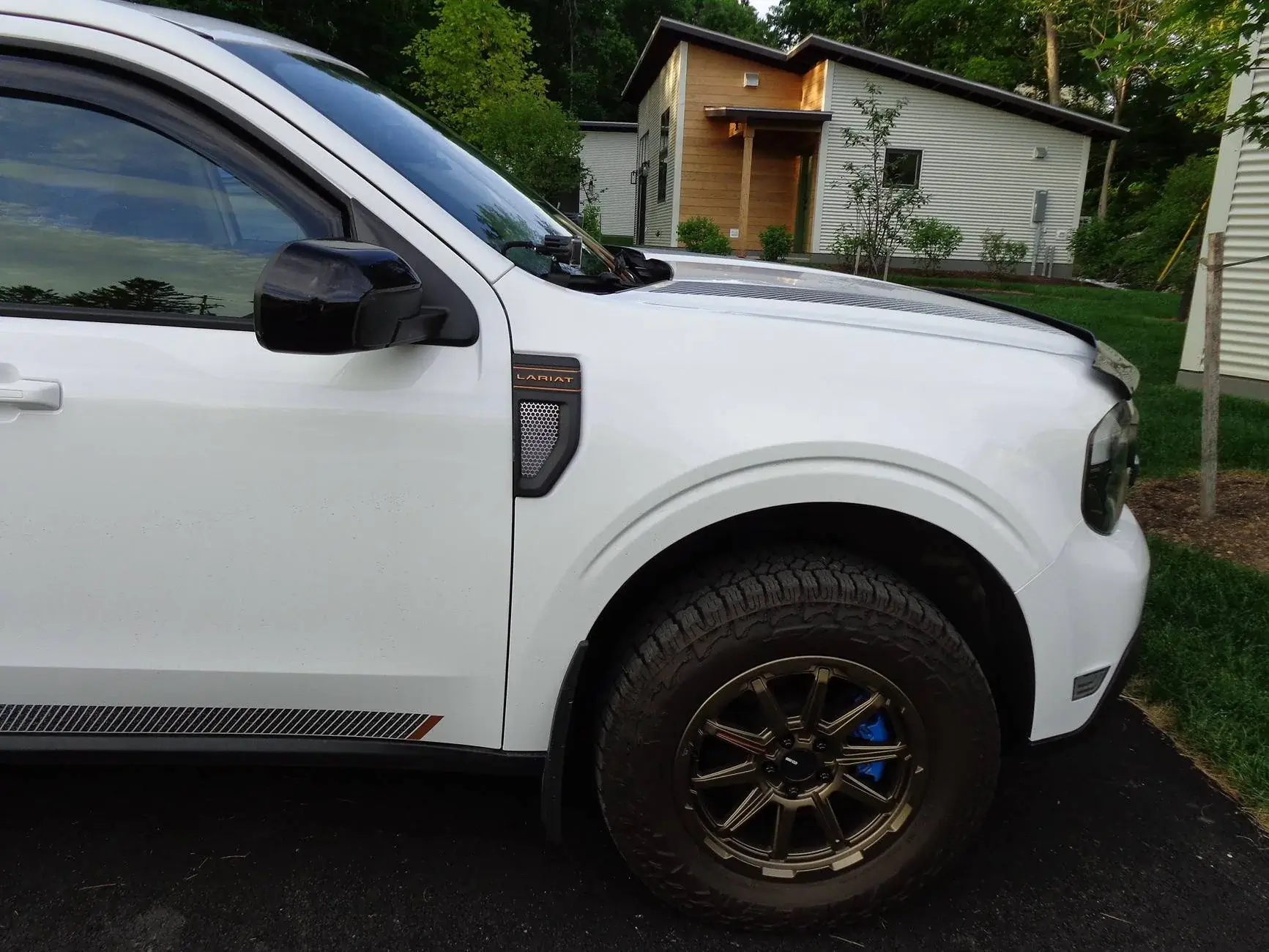

Ford Maverick Fender Vent Mod: Mesh Installed on OEM Vent 1764202767002-m7
An angle grinder with a flap wheel is the easiest way to do these.

I've painted the mesh black since these pics were taken.
Ford Maverick Fender Vent Mod: Mesh Installed on OEM Vent 1764203017469-30

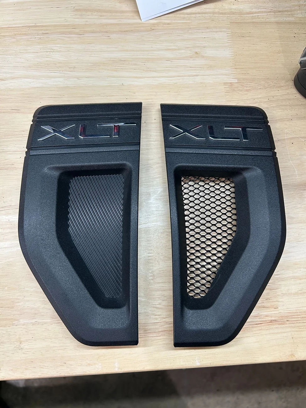

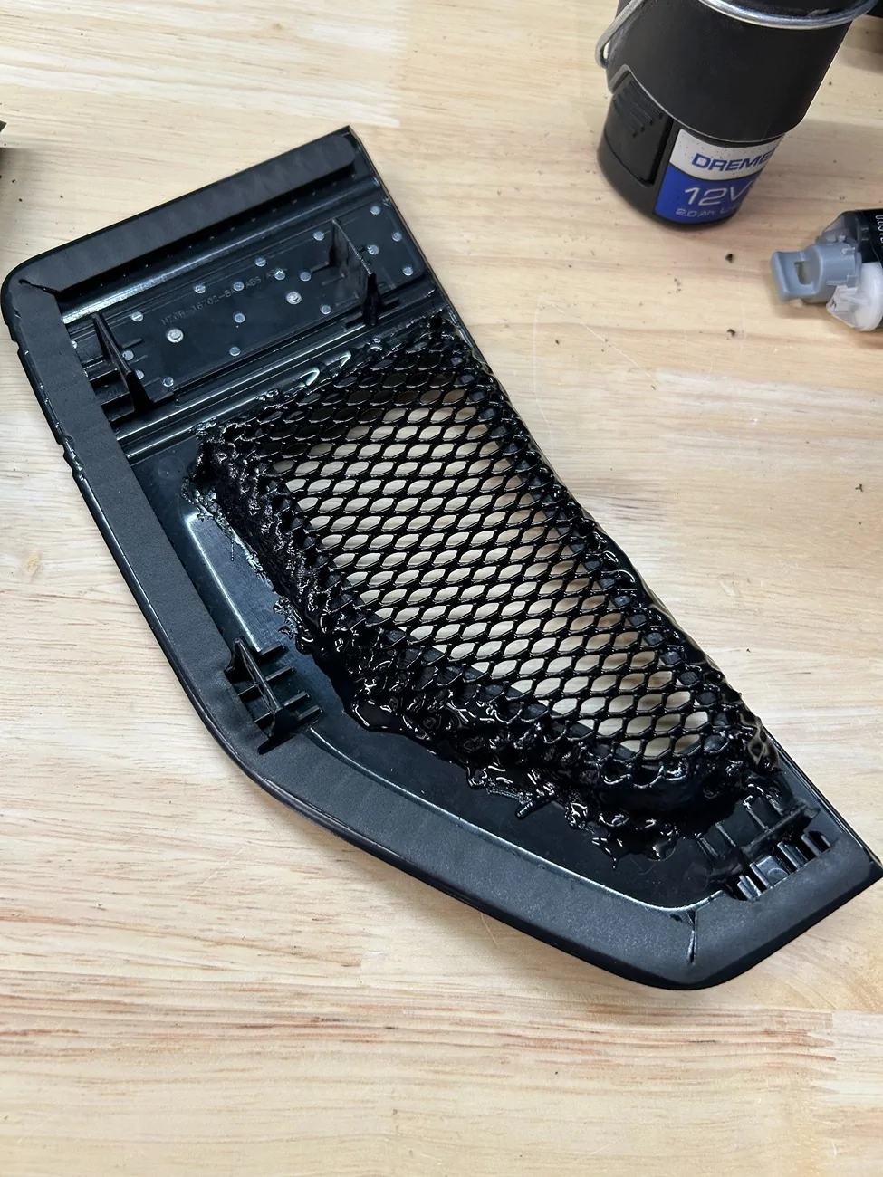

Decided to spice up the factory fender vents. I'm not a huge fan of the Air Designs ones, so I decided to add some mesh to my stock ones. I'm leaving this for anyone who wants to do the same. The only costs were $10 for the epoxy and $30 for the mesh, and that gave plenty extra. The only tools required are a dremel with a cutting wheel and sanding attachment.
BEFORE:
Using a dremel to cut out the middle
Using JB Weld plastic epoxy to secure the mesh

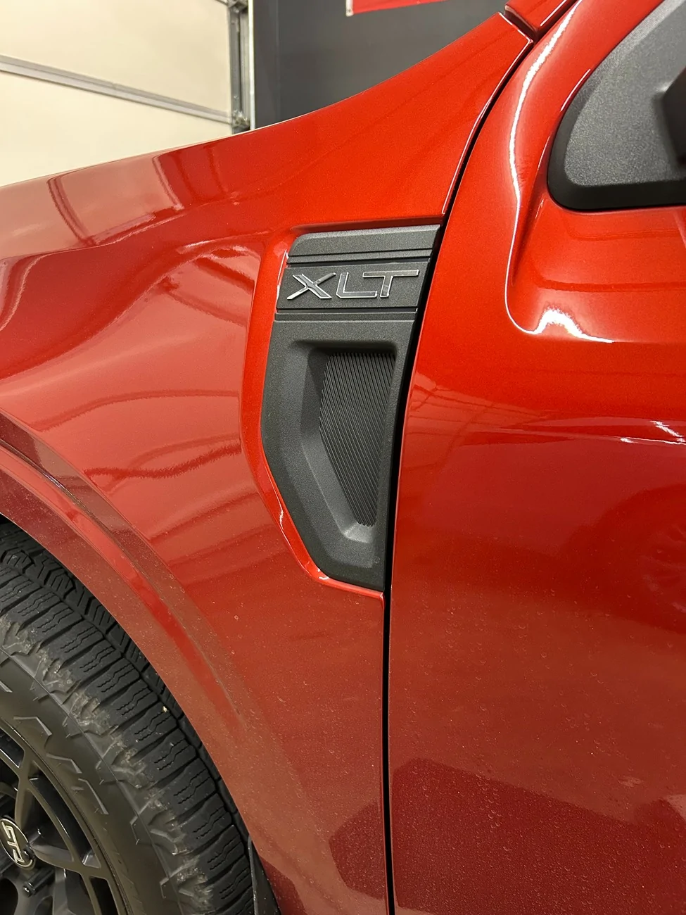

Compared to the original

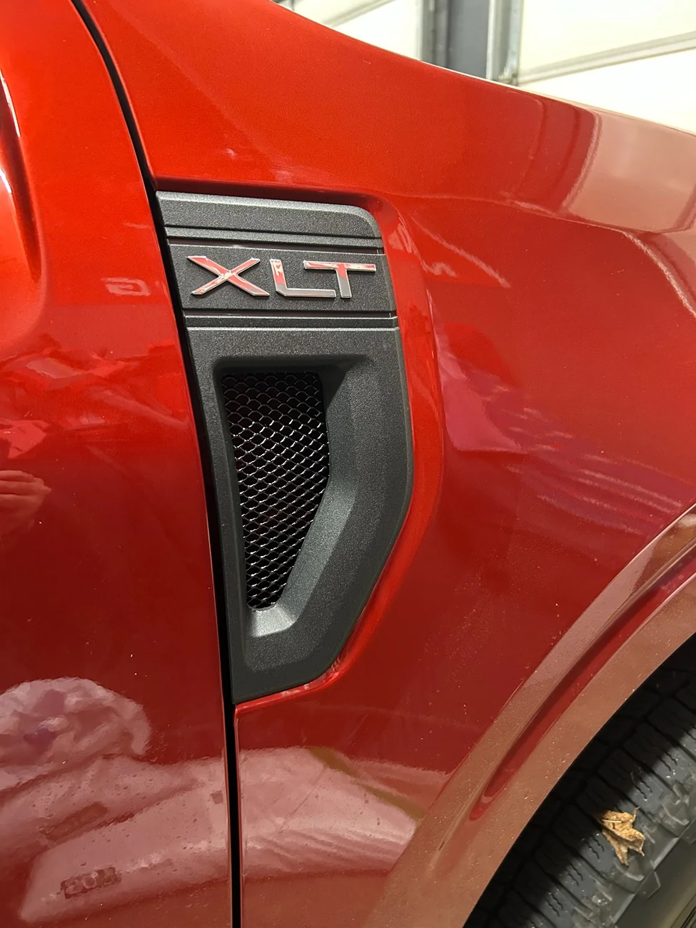

AFTER:
