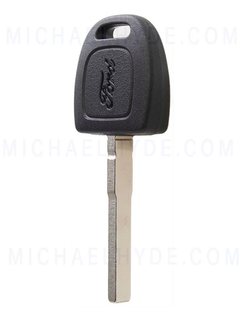

I have 4 keys made for my Mav.
2 originals where the metal cut key is inside the flip open fob. The ones that came with my truck. One of those I use daily. The other stays inside my house. Then I have 2 more, that look like an "old school" key. Like this....
Ford Maverick Extra key and fob 5940815web_800x1044
One of those "old school" keys refused to program, so is a "dumb" key that will unlock the door, but will not start the engine. The other programmed correctly and will both open the door as well as start the engine.
I have the "dumb" one hidden on the outside of my truck somewhere sneaky. Then I have the "smart" one hidden inside my truck somewhere even more sneaky. If someone finds the "dumb" one, they can get into my truck but cant start it. They will never find the "smart" one I have hidden inside. Unless they tear apart my truck. But if I am ever locked out, I can easily get to both the "dumb" and "smart" spare keys.
