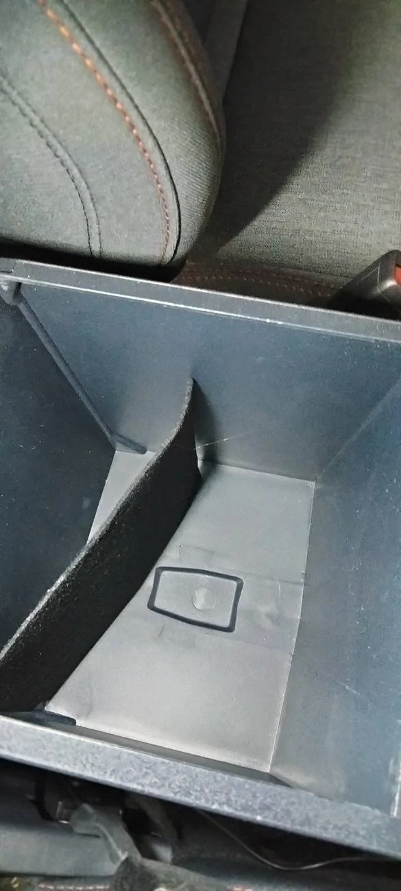

What I'm going to try and help you with is if your key fobs battery is dead.
Go to your truck open your center console clean everything out if there's a liner that has to come out to and please take a picture of what you see.
To start a Ford Maverick Lariat with the emergency key, you need to access the dedicated key slot usually located inside the center console, insert the emergency key blade from your key fob, put your foot on the brake pedal, and then press the start/stop button to start the vehicle; essentially bypassing the keyless entry functionality when your primary key fob battery is dead or not detected.
It should look like this when the felt liner is picked up. 👇👇👇👇👇
