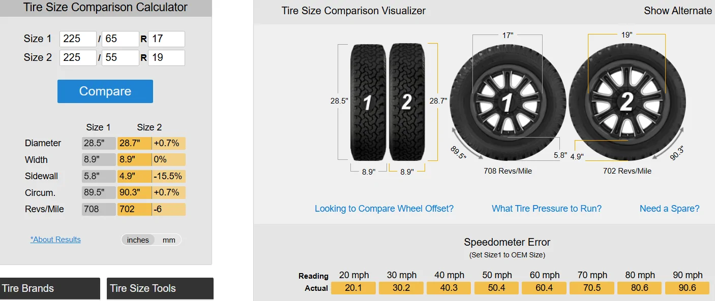

I am buying a set of 19x7.5 Lariat wheels and the OEM tire size is 225/55-19. Anyone go with a slightly wider tire on the same wheel. I dont want taller as I dont want to mess with the spedo and gearing. Just wondering what others may have accomplished?

On the tires comparison:
The Lariat tire will be a tiny bit bigger than the XL tire in diameter, 0.7%.
Thank you, this helps as I am trying to determine what wider tire i can put on the 19s and stay in the diameter range. Like a 235 or 245/50 19, so will look up in that chart and then check to see if those sizes will still fit a 19x7.5 wheel.
