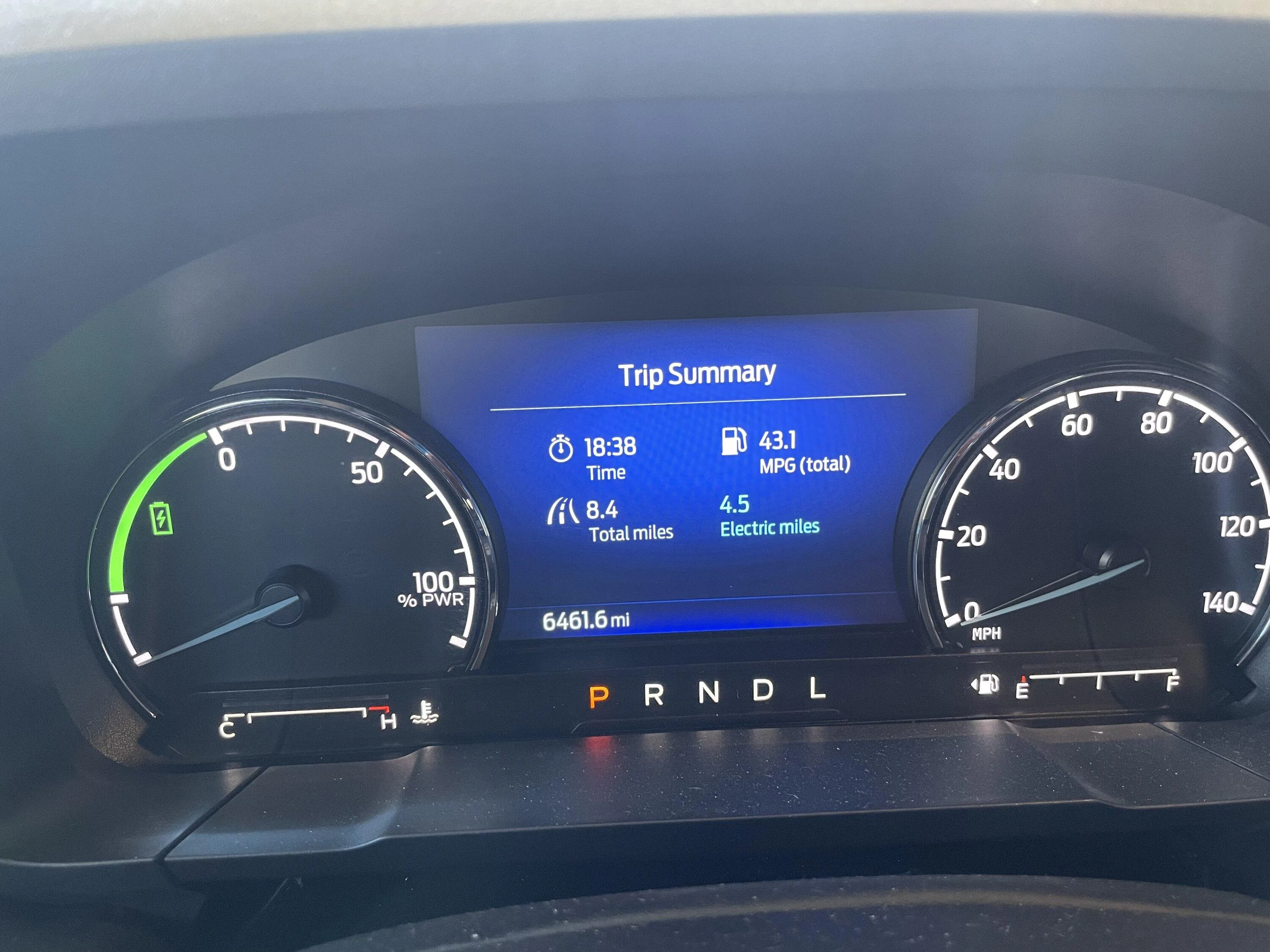

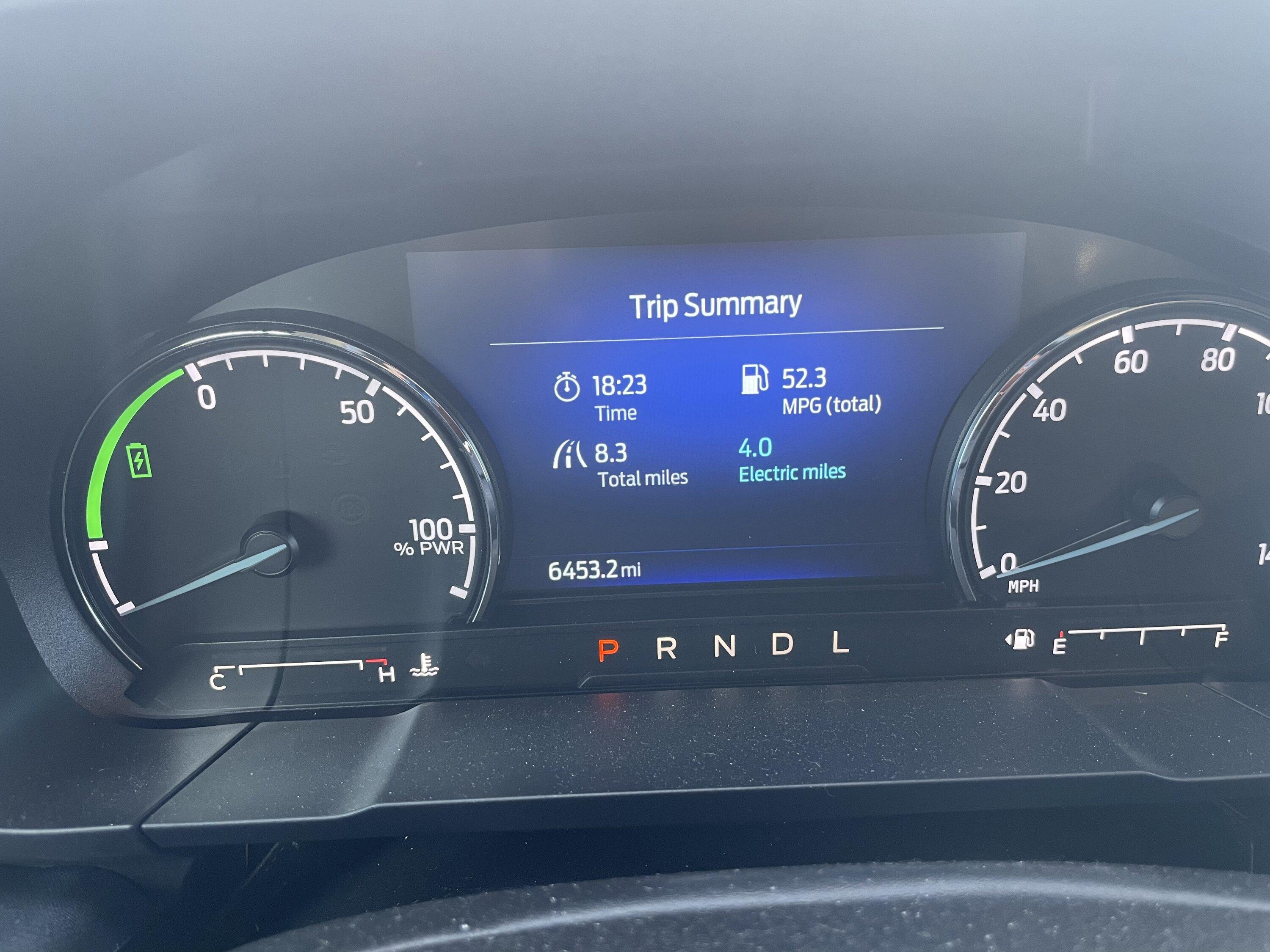

Explain 10MPG drop on identical drive

It was 48 degrees on the 52mpg drive and 54 degrees on the 43mpg drive, same day. I have noticed around 38mpg when the temperature was around 0-10 degrees a couple weeks ago, but that is to be expected.
Many variables. Perhaps dew point was such that the defrost was turned on. Could be that HVB SOC was such that the ice came on extra. On such a short trip hard to say. Possibly was not in your normal drive mode. Maybe you did not Regen the normal amount and more Hydraulic was used. Reset trip 1 or trip 2 at times of fill up and go with that mpg although it can vary due to variations. With 400+ mile on a trip meter I can see 0.3 mpg difference in a couple miles.

With nothing changed between drives other than a slight temperature change I noticed a 10MPG drop in performance today.
When you park, you can park with a HV battery as high as 70% charged, or as low as 30% charged. You don't know what it is unless you have an aftermarket OBDII reader.
The battery is always somewhere in the middle but if the engine was running at the moment (or just before) you turned the truck off, the battery will be on the higher side. If you did a lot of EV driving just before shutting down, you will park with a battery charge on the lower side.
That range of charge can be good for 2 EV miles. That's 25% of your 8 mile trip. And the variance in MPG was less than 25%. So nothing appears to be wrong with your trip or truck.
Park with a highly charged battery and your very next trip will have higher MPG. Park with a low charge in the battery, and your very next trip will have lower MPG. Averages out in the end, but not on short trips.

This is the best answer I have received yet. Although you would think if that was the case the electric miles would reflect that. I know these are short trips. Just the first time I noticed such a decrease in mpg from my average. (Other than when it is extremely cold, which it wasn’t). Still a great truck and I usually get great mileage overall. Not as good as some on the forum but so many factors it’s hard to know exactly why.
Well, if your measurements were accurate then your ride wasn't identical. Gas quality, battery charge, engine issue, environmental difference for starters. Have to see how it goes long term.
