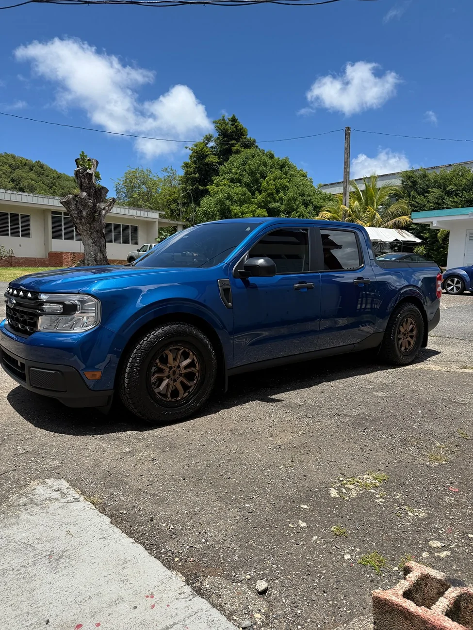

May 12, 2025
Puerto Rico
2024 Ford Maverick XL fwd 2.0 turbo. 2017 Mini Cooper S 2.0 turbo
Hi people. Problem fixed. I changed the front right strut, it was broken inside . Eibach told me that it could be impact tool in the process of the installation. In my opinion if you need to work with suspension NEVER use impact tools , problems will be there after the work. New fixed springs from Eibach don’t make any noise at all, confirmed. Another hint: If your truck have more than 30-40k miles , put new struts when changing to lowering springs. Mine is only 4k miles so that is why i think problem was caused because of the impact tool.

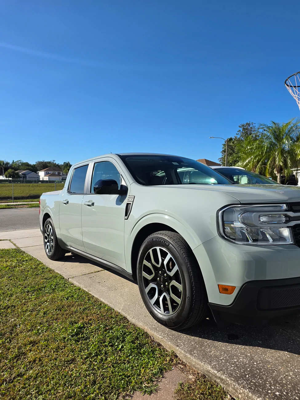

After 27k miles on stock suspension I swapped in the eibach pro kit. Love the looks. Suspension has less travel but corners much better. It stays flat in turns and under braking/accelerating. I had a shop do the instal along with alignment.
