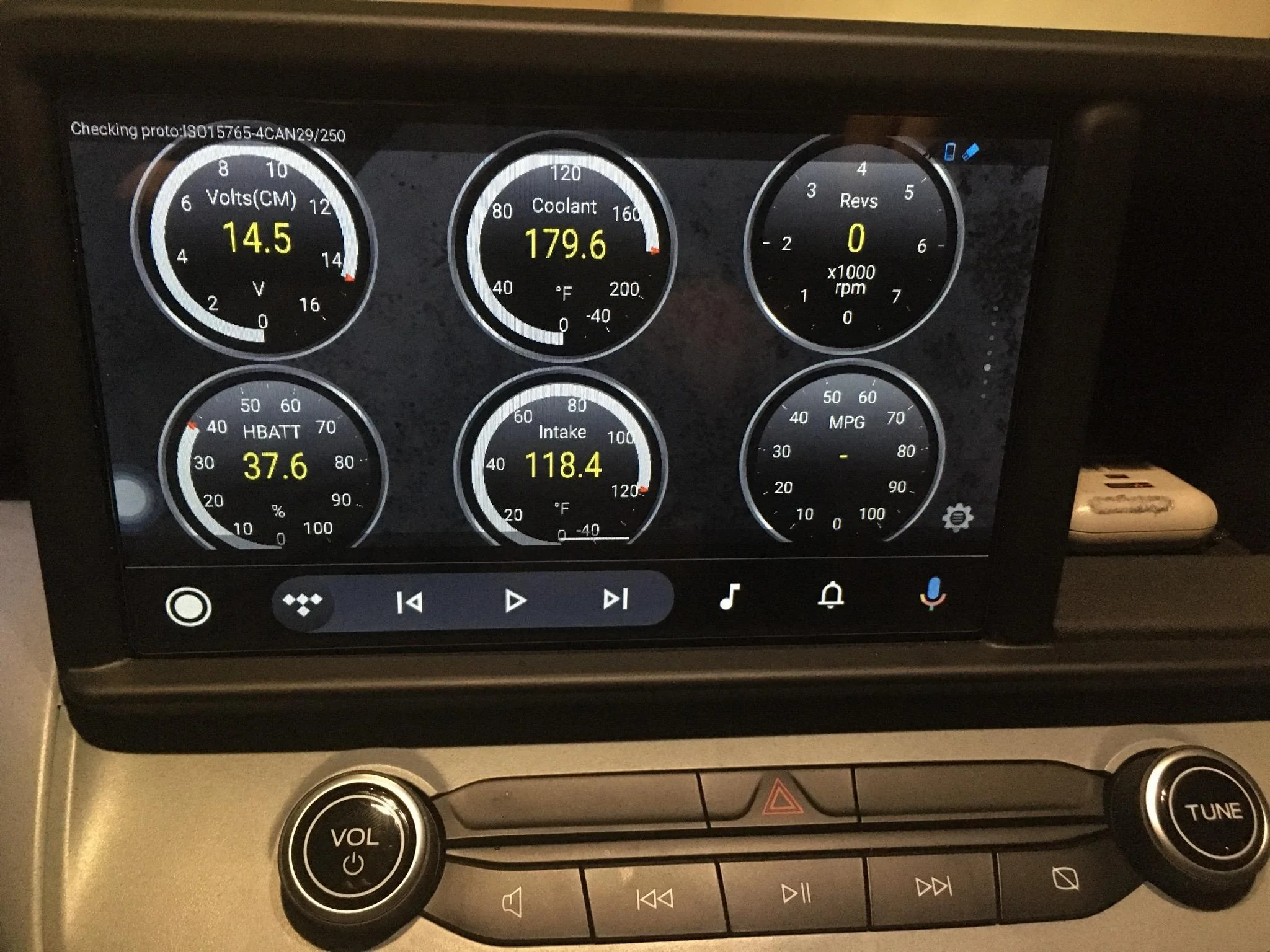

Where and how did you do that?
  • Torque (I can't speak to iOS, but it is on Android, in free and paid versions).
  • Android Auto.
  • A cheap bluetooth OBD2 dongle.
