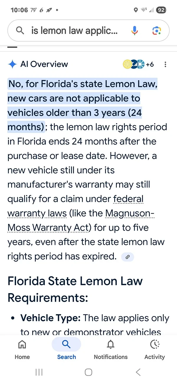

Ford Maverick Endless repeated Hybrid failures have finally broken me Screenshot_20251006_100620_Googl
read this ,under warrenty, may still be covered after 3 years.
