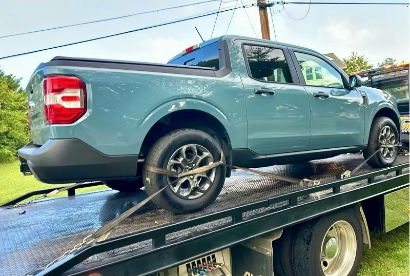

Endless repeated Hybrid failures have finally broken me

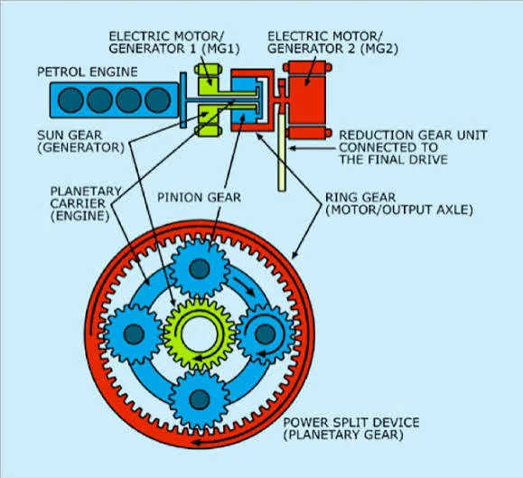

There is no coupling or damper clutch.

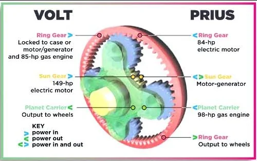

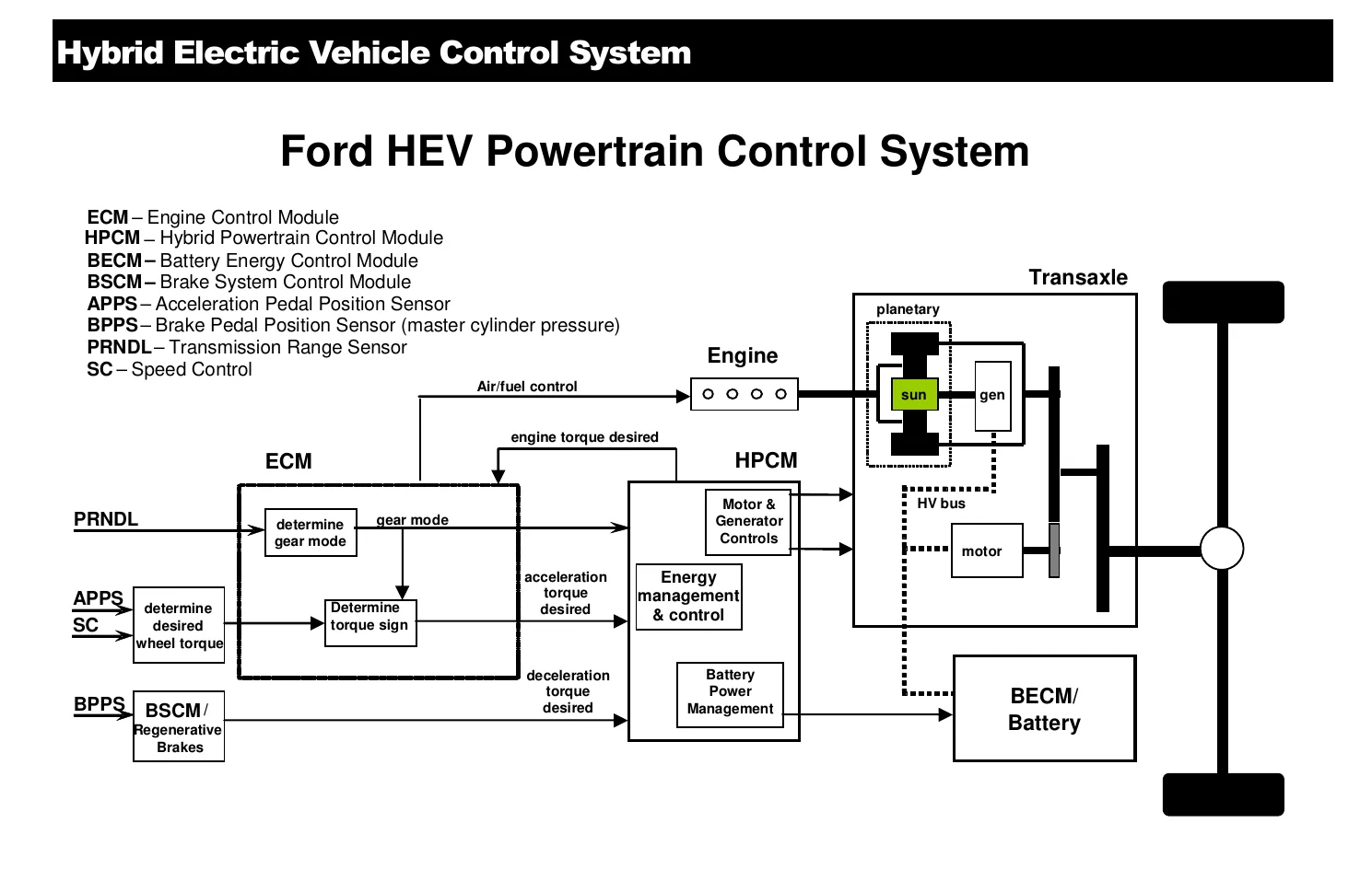

Inside of the transmission, there’s 1) a traction motor, that uses electricity to make torque to create forward movement and there is 2) a generator motor that creates drag on the planetary carrier in the transmission to change the gear ratio of the continuously variable transmission, thereby generating electricity that gets sent to the high voltage battery, the traction motor, or both, depending on what the BMS tells it to do. And 3) a planetary gear set that serves as the continuously variable transmission. As you can see from diagrams below, there are multiple combinations of where you send engine power and what gear is connected to the traction motor and what gear is attached to the generator motor. iirc, the Maverick has the generator attached to the planetary carrier.
If the generator motor, is freewheeling, the planetary carrier is also freewheeling, which means there is no power being sent from sun gear to ring gear and the truck will set at a stop. When you want to go forward and give it some throttle, the engine will rev up and the generator motor starts generating electricity, which creates drag on the planetary carrier, which slows it down, which increases the gear ratio of the transmission, to go faster and faster. So let’s say your engine is making 50 hp and the generator motor is using 20 hp of that output. That will result in 30 hp going though the transmission epicyclic gears: sun gear, planetary gears, planetary carrier, ring gear and out of the transmissions at the output shaft. The other 20 hp of generator drag that is being used to change the gear ratio of the transmission is simultaneously getting converted into electricity, which then drives the traction motor, which is also attached to the output shaft of the transmission.
So when you describe the engine freely revving and the truck barely moving, that sounds like the generator motor, or it’s associated electronics, has failed and it is not making much drag on the planetary carrier, which means the the planetary is nearly freewheeling, which means there is minimal power from the gas engine getting from the sun gear to the ring gear to drive the transmission output.

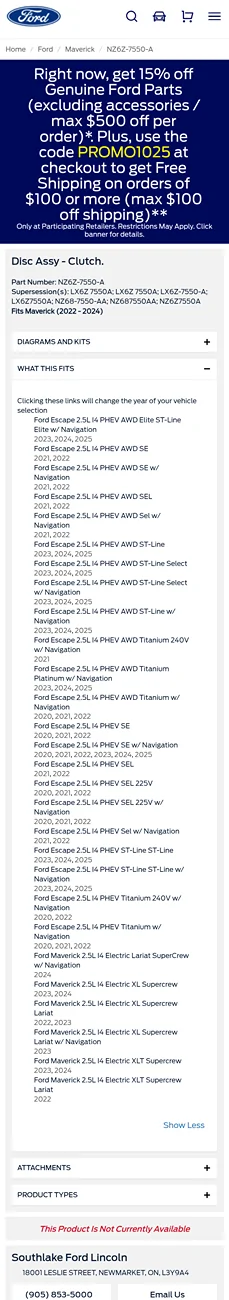

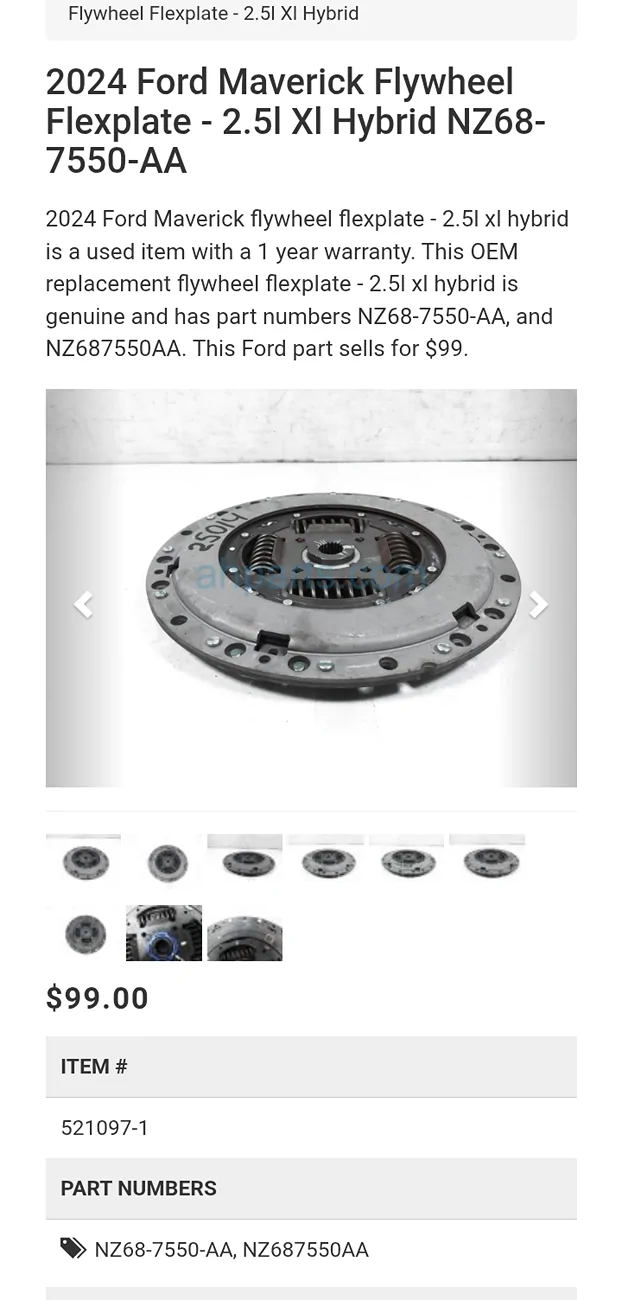

Found this
Ford Maverick Endless repeated Hybrid failures have finally broken me chrome_screenshot_Oct 7, 2025 6_29_22 AM CDT
ETA: Apparently a few have had the springs get loose and rattle. The is to dampen any surges when the ice starts, stops, or when planets are not quite synced?

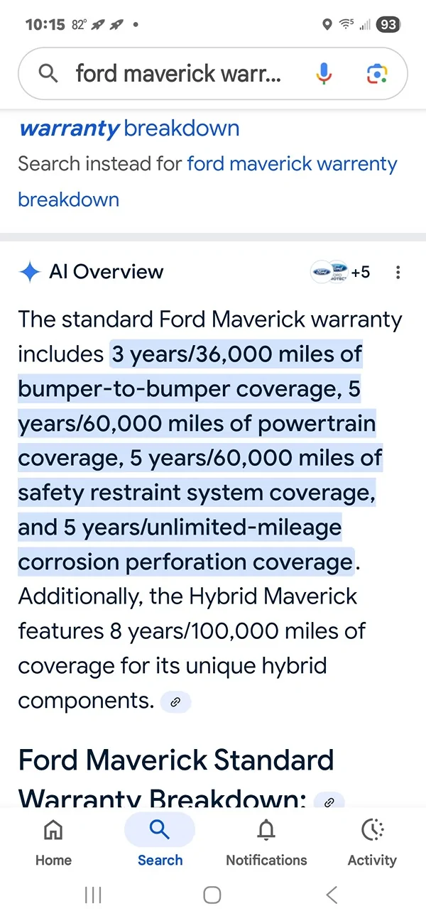

All of the repairs so far have fallen under the factory 60k powertrain, or 100k? hybrid warranty. I have a PremiumCare extended warranty that we haven't even tapped yet, and each time it gets fixed, I resolve to see it thru to the end of that. But maybe not this time.
That's a little scary since I just rolled 40K this am on my 23 Hybrid. So far it has been great no issues other than the brakes being a little funky and the AC had made a funny noise in EV only a couple of times but that has been a while back and it wasn't consistent so I haven't had it looked it.
I've got the premium care extended as well so I should be covered for a while if I start having issues but I would probably have a similar thought to you if I was having that many issues even though under warranty

Found this
Wow. A $99 part? I'm impressed at the low cost. Too bad it takes 16 hours of labor at $165/hr to change it.
That's from a wrecking yard used. But most likely $300 or so new. I saw online one being replaced on a 2.5 Toyota hybrid. It had some rivets that became loose and the springs were rattling. It had more rivets in places that don't show on the ford. Maybe Ford has upgraded the one in Maverick. Both had four springs. The d*** fee for shop wipes on the replacement labor would cost more than $99.🤫
ETA: Shows to be currently unavailable. maybe high demand???
