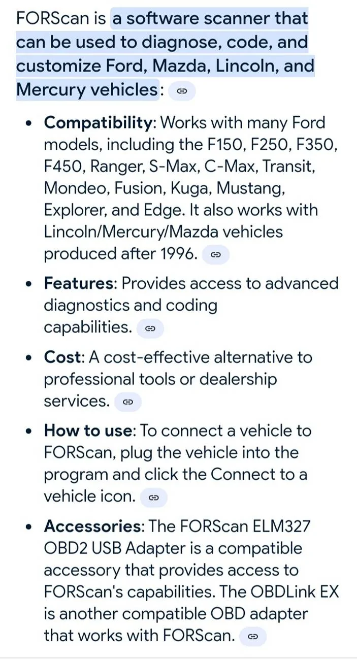

If it is possible at all it would be dealer accessed or ForScan only.
I really doubt that a dealer would change anything like that. They have no way of knowing if your vehicle may end up being owned by somebody else in the future. The change would most certainly be logged as being done with Ford equipment by a dealer. Sometimes current owners don't look far enough in the future, of what their changes or modifications might do to future owners.

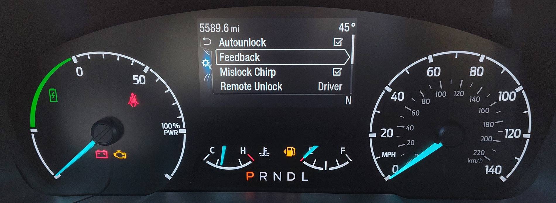

Not sure if this setting, which does silence the double-lock on fob honk, would take care of this alert too.
It's not in the manual that I can find, and I think it appeared for me after the BCM recall for taillight issue.
Mislock Chirp is the sound you'll get on double-lock press if a door/hood/tailgate is open.
Feedback stopped the sound on just double-lock press.
Since it says nothing about feedback on what system, perhaps it's more than 1 item.
Stupidly it goes to a next screen with a single checkbox for XLT non-lux, perhaps expansion was planned, or available if you have other options.
