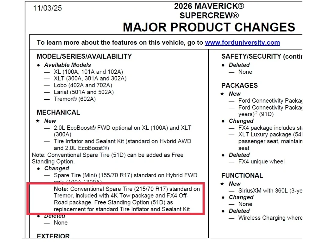

Yep, standard equipment on a 2026 Tremor.

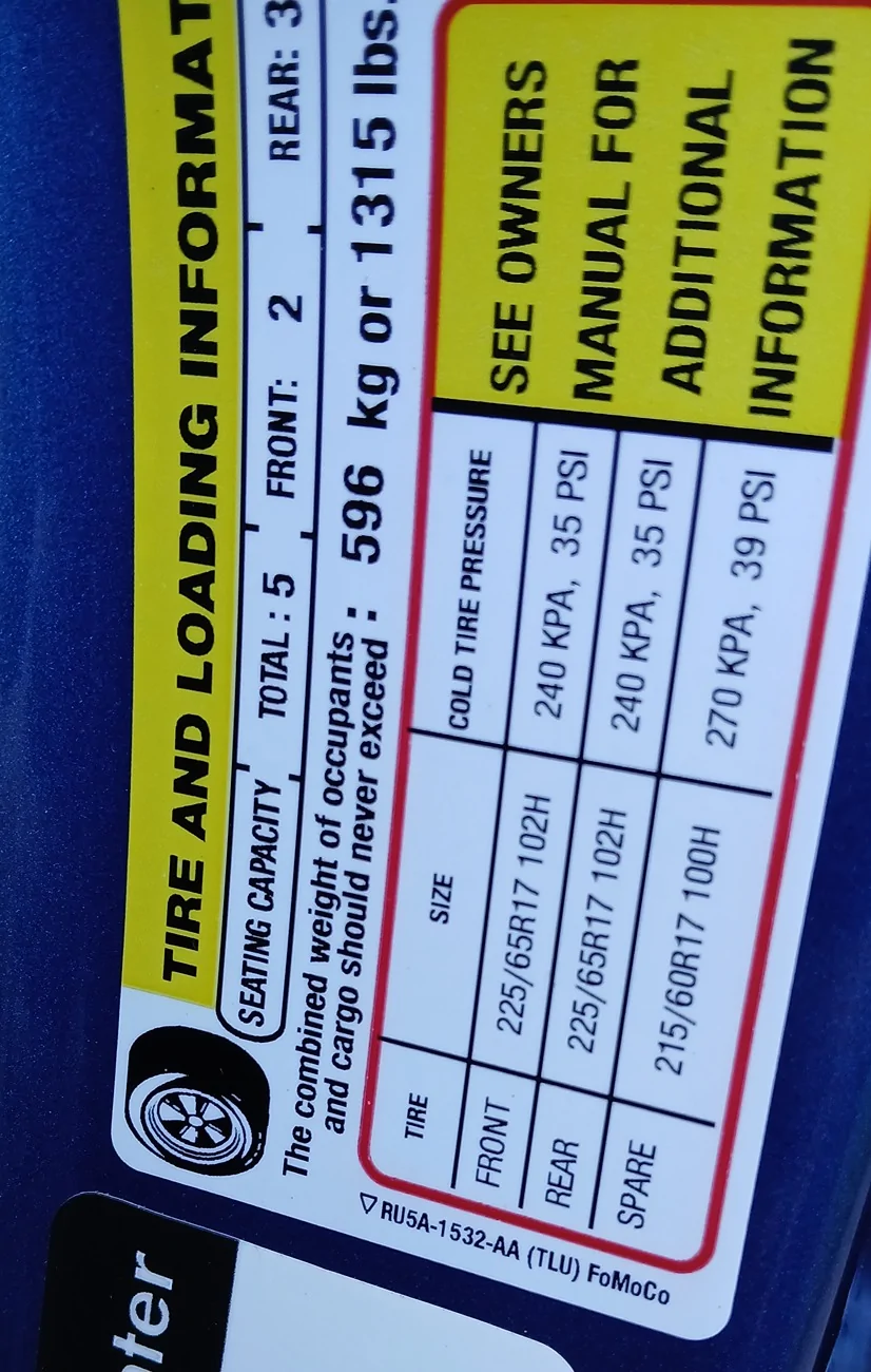

Can someone with a 25/26 Tremor crawl under and verify the spare tire size? I'm pretty sure that the 70-series is incorrect, and is actually a 60-series. Even a pic of the door jamb sticker would help.
HRG
HRG
Not a Tremor but FX4 and you are correct. I just did my air pressure for the spare the other day, didn't even think to look but next time I go out I will.

Anything larger than a 60R17 would negatively impact the functional depth of the trailer hitch. I have one hitch ball that already hits the spare tire before I can get the pin inserted.
HRG
It's a 215/60/17
