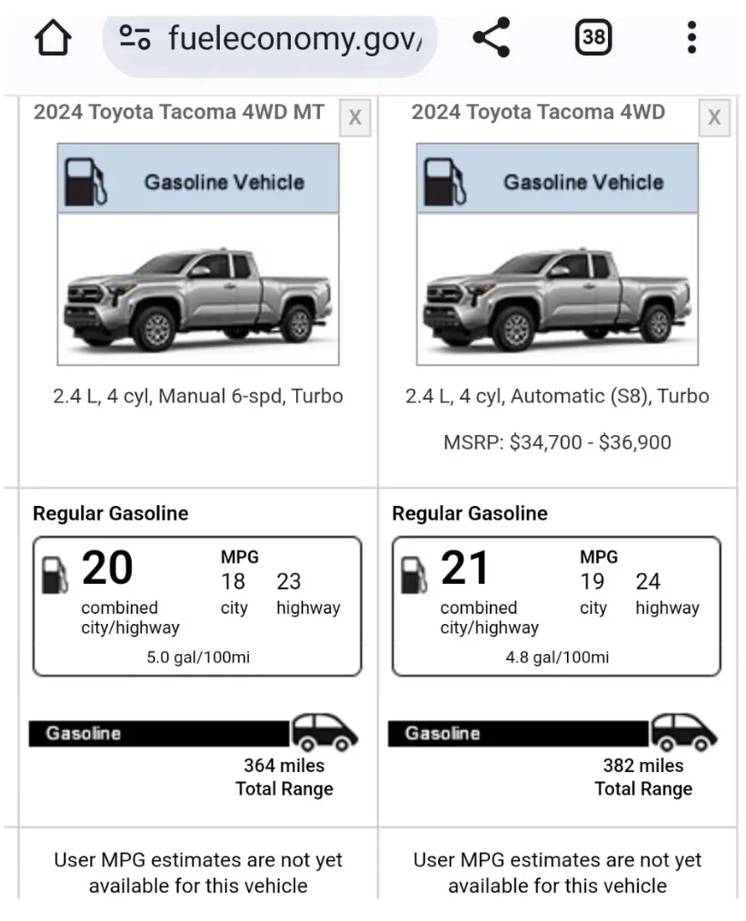

One of the last manual transmission trucks sold. The Toyota Tacoma.
Europe the long bastion of manual transmissions has finally succumbed. 75% of new vehicles sold in Europe have automatic transmission.
Ford Maverick Does Lane Assist Affect Mileage? Screenshot_2026-02-23-14-30-33-01_40deb401b9ffe8e1df2f1cc5ba480b12
