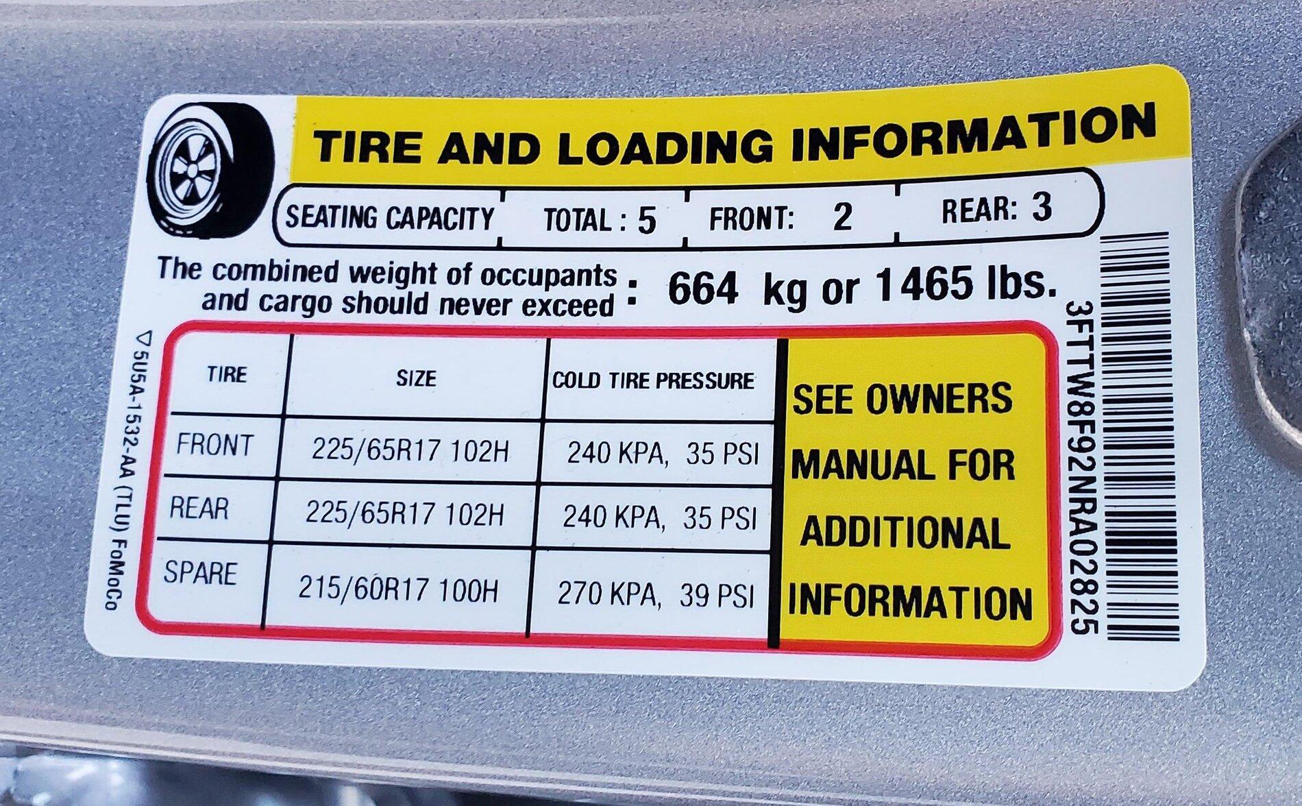

based on that sticker the “full size” spare is 1.3” shorter than the on the ground size, or 4.6%.
not sure how fords AWD system is but I know on a lot of AWD cars thats a big no no.
Oh boy tire size brain exercise!
Does the smaller full size spare at 39 lbs (compared to the not full size spare inflated to 60lbs) have the same rolling radius as the 4 "standard" size tires at 35 lbs? Also does the small size spare have 3/32" tread and the full size tire have 6/32" and the standard tire have 9/32"? Also notice the spare has 100 weight range instead of 102 but since they all are H speed rated you can drive FAST to the tire shop!

im gonna hazard a guess that I don’t care how much inflated it is, it won’t grow 1.3” in height.

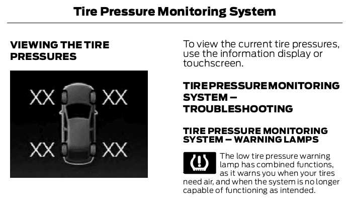

I wasn’t clear....many cars have the TPMS as an idiot light, but in the subaru it has a screen with the individual pressures listed...not simply a ”tire!“ icon.....has anyone seen if the maverick has the individual pressures in a menu or screen? It‘s nice to see if one tire is low and which one rather than manually checking the pressure to find the offending tire.
Thanks...
Manual, page 344:

How can you have an AWD system with a spare that is over an inch shorter than the other 4. Using such a different tire size would be the biggest no-no with an AWD. Can someone confirm this is a FWD and not AWD?
