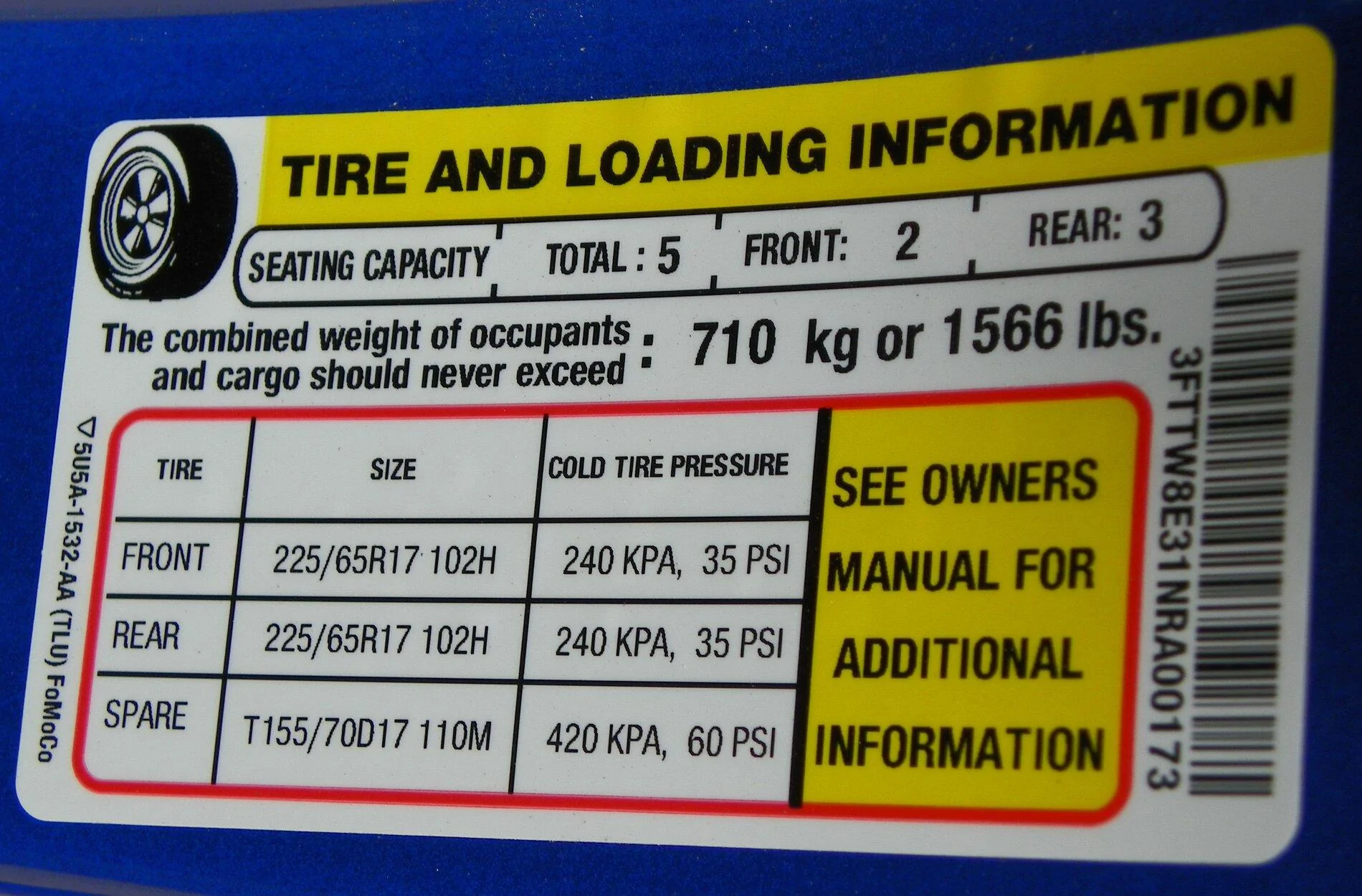

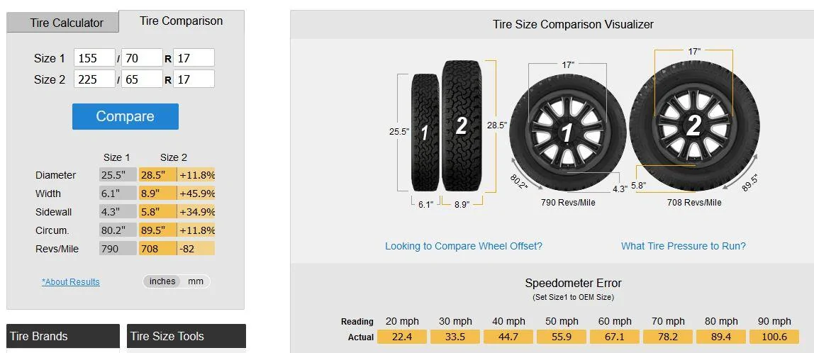

based on that sticker the “full size” spare is 1.3” shorter than the on the ground size, or 4.6%.
I said to myself, "That can't be right!"
But https://tiresize.com/calculator/ says you are correct.
The mini-spare is even smaller, height-wise: 3" shorter???
I don't know which models the tire label photos come from, FWD or AWD.

This is from an XLT Hybrid with no-options:
Ford Maverick Does full size spare have TPMS? Hybrid Tire and Loading
