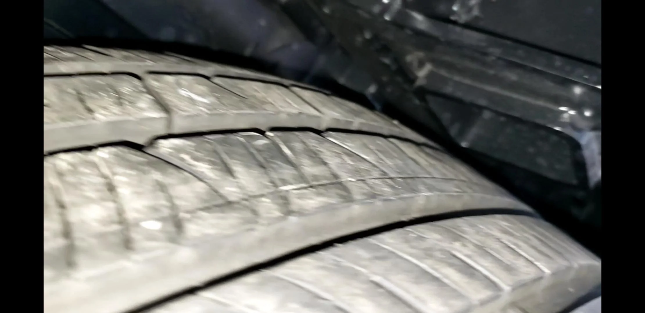

i have the FX4 with 4k tow packge and replaced my donut spare with a steel wheel and 225x65 r17 and it fits.
Ford Maverick Confirmed. Steelie as full size spare does fit Screenshot_20230330-094516_Video Player
Ford Maverick Confirmed. Steelie as full size spare does fit Screenshot_20230330-094438_Video Player

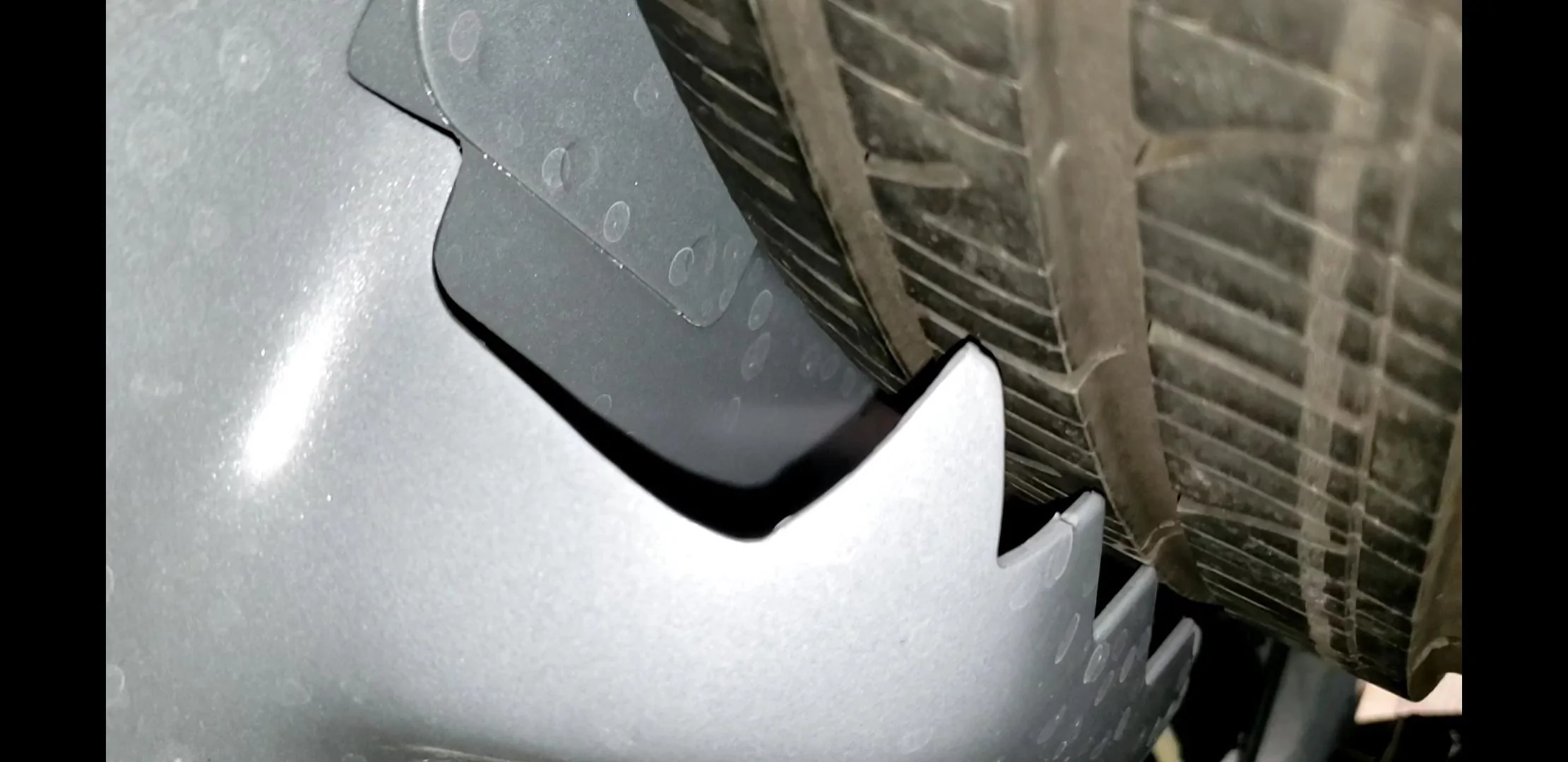

Lariat FX4 with 4K tow package here. I dropped the donut and put a 235/65R17 on a steelie in place yesterday.
It’s tight. I mean, get-the-jagged-teeth-into-the-treads kinda tight, and still binds against the hitch receiver but it’s in place, lol.
I think I will dump some air so it fits a little less ā€˜snug’ and just carry a small pump under the rear seat.

Is your 235/65/R17 an "all-terrain" type tire that fits between the jagged saw edge and the trailer hitch? I am thinking about getting the Nokian Outpost ATPs and wondering if the 235/65/R17s would fit underneath so I can have a legit full size spare.
