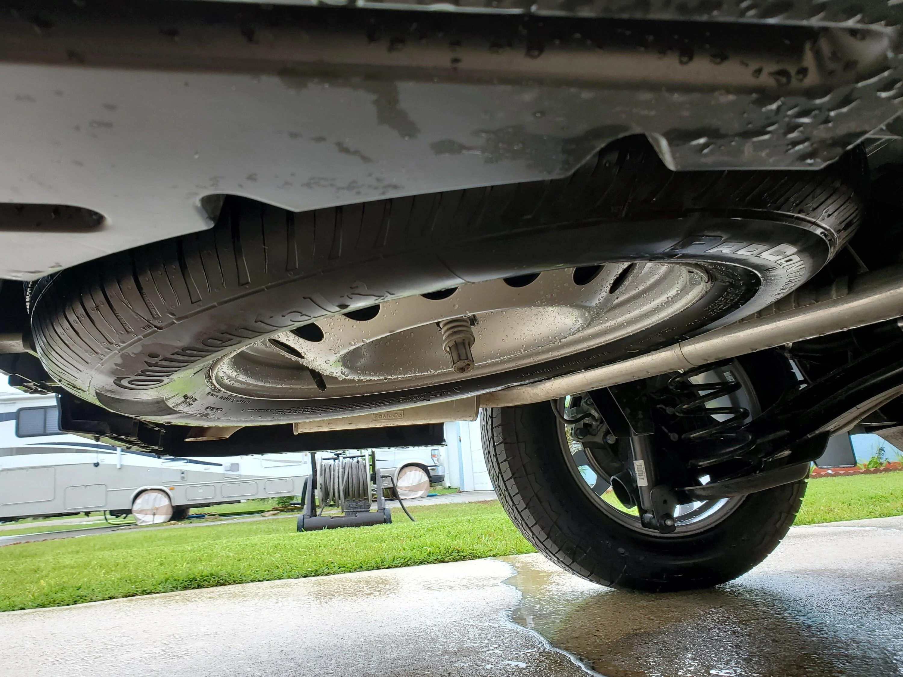

How can you have an AWD system with a spare that is over an inch shorter than the other 4. Using such a different tire size would be the biggest no-no with an AWD. Can someone confirm this is a FWD and not AWD?
Ford Maverick Does full size spare have TPMS? tirelabel-
I can't confirm that particular build is FWD or AWD, but I can confirm my AWD came with the same as a "Full Sized Spare". Probably my only disappointment with the truck. But since I was changing them all out, it ended up not affecting me, other than selling the old tires.

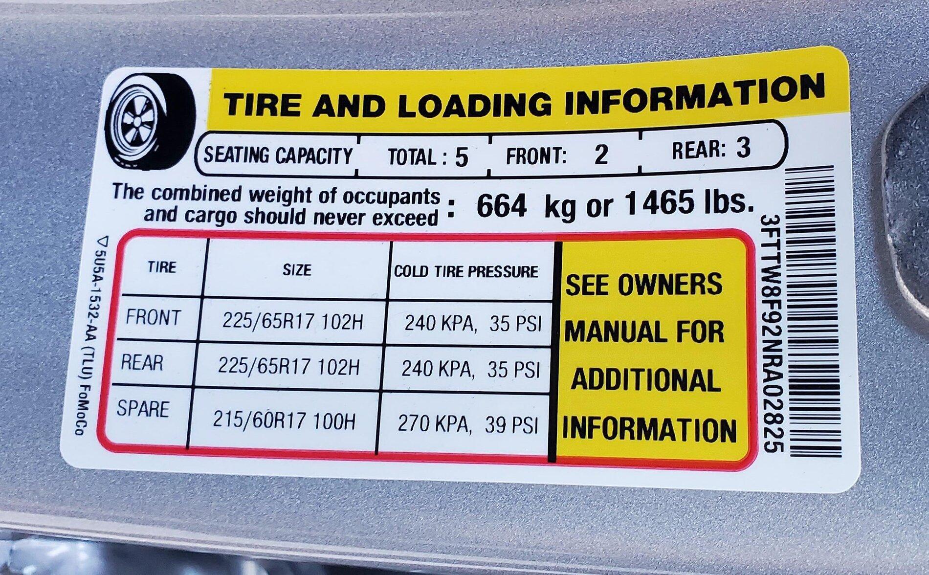

Looks like all Mavericks come with two different spare tires:
1. a space saver spare tire, donut, or temporary tire, size T155/70D17
2. If you purchase a hybrid or pay extra for a so called "Full Size Spare" surprise, the size is 215/60R17 . This is not the same as the OEM tire/rim on any Maverick.
This information is shown on the Placard located on the driver side door jam.
Please note, the factory spare does not have a Ford OEM TPMS factory sensor.
