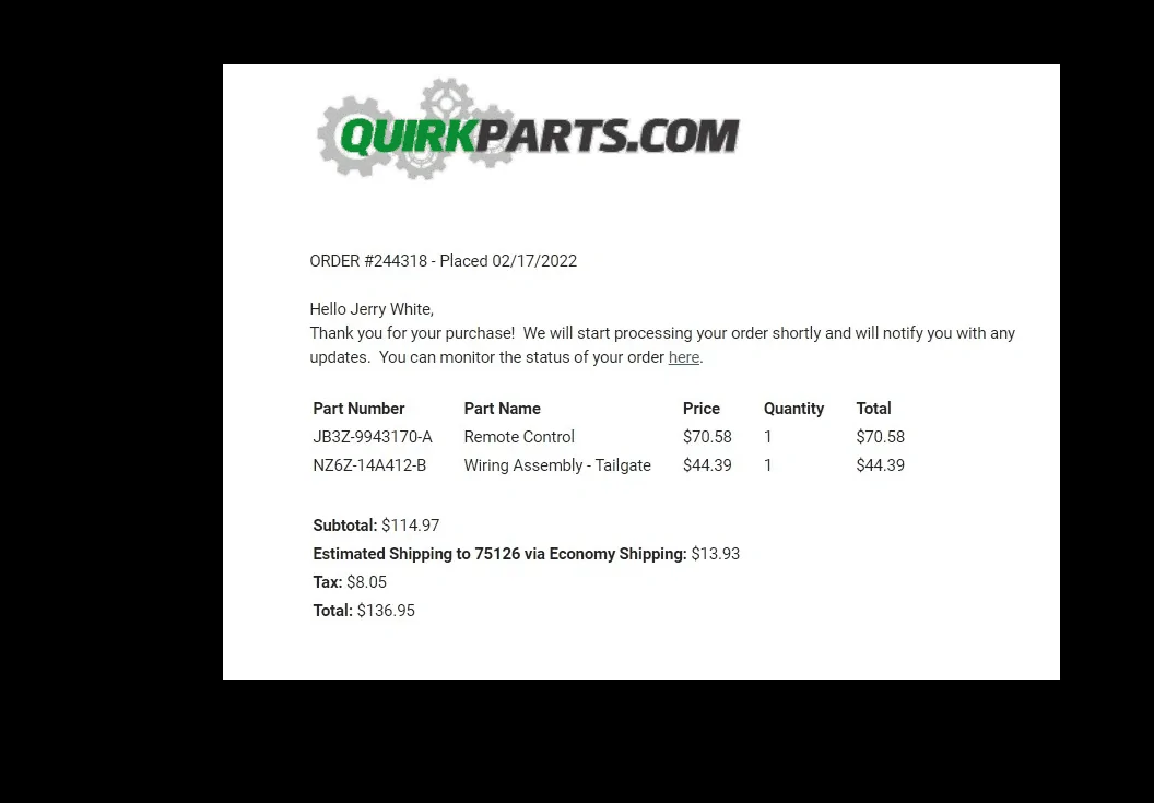

$45+ for the wire harness?
I'm positive you could just purchase two pins to add to the existing harness if you don't want to use wire taps... Can you show a picture of the original harness you took out?
WPT1314 are pretty easy to find if you want an OEM plug for the actuator.

I noticed backup camera/remote locking cable NZ6Z-14A412-B is about 3 to 4 times as expensive as NZ6Z-14A412-A from the F250 Super Duty. Can someone post both ends of the -B cable. Hopefully the pinouts are the same and -B is just an upgraded part or from a newer supplier to Ford.

Also, the part number for that shorter tailgate harness which would bring power from the main harness to the tailgate lock actuator is NZ6Z-14A412-B

After extensive research....I finally found the right OEM part to power the tailgate lock to my XL. This is a follow up to my previous thread. https://www.mavericktruckclub.com/forum/threads/tailgate-auto-lock-installed-for-xl.9343/ I was able to take pictures of the control from my friend's XLT. Reading the QR code...I found the part number to be jb3b431f94ad. However...a google search for that part number only yielded resellers from Europe. Exhausted from not finding more info on jb3b431f94ad...I took a shot in the dark and see if the maverick share the same control as the new Ranger. I went to a Ranger forum and found a thread where the user showed the inside of the tailgate. To my joy, the control looked exactly as the one in the Maverick...down to the same part number jb3b431f94ad. So I search the part catalog for '19 Ranger and found the control part number. The part number is JB3Z-9943170-A. A google search of that part number didn't yield any pictures for me to compare. Taking a chance...I ordered the part from Fairway Ford Parts for $80 shipped. The part came in today and boom! same as the Maverick. I quickly installed it and it works perfectly.
Part you need:
JB3Z-9943170-A
