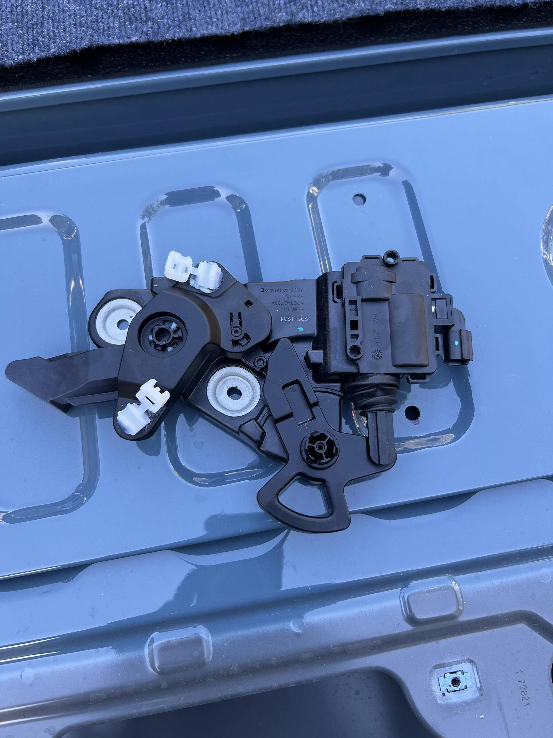

After extensive research....I finally found the right OEM part to power the tailgate lock to my XL. This is a follow up to my previous thread. https://www.mavericktruckclub.com/forum/threads/tailgate-auto-lock-installed-for-xl.9343/ I was able to take pictures of the control from my friend's XLT. Reading the QR code...I found the part number to be jb3b431f94ad. However...a google search for that part number only yielded resellers from Europe. Exhausted from not finding more info on jb3b431f94ad...I took a shot in the dark and see if the maverick share the same control as the new Ranger. I went to a Ranger forum and found a thread where the user showed the inside of the tailgate. To my joy, the control looked exactly as the one in the Maverick...down to the same part number jb3b431f94ad. So I search the part catalog for '19 Ranger and found the control part number. The part number is JB3Z-9943170-A. A google search of that part number didn't yield any pictures for me to compare. Taking a chance...I ordered the part from Fairway Ford Parts for $80 shipped. The part came in today and boom! same as the Maverick. I quickly installed it and it works perfectly.
Part you need:
JB3Z-9943170-A

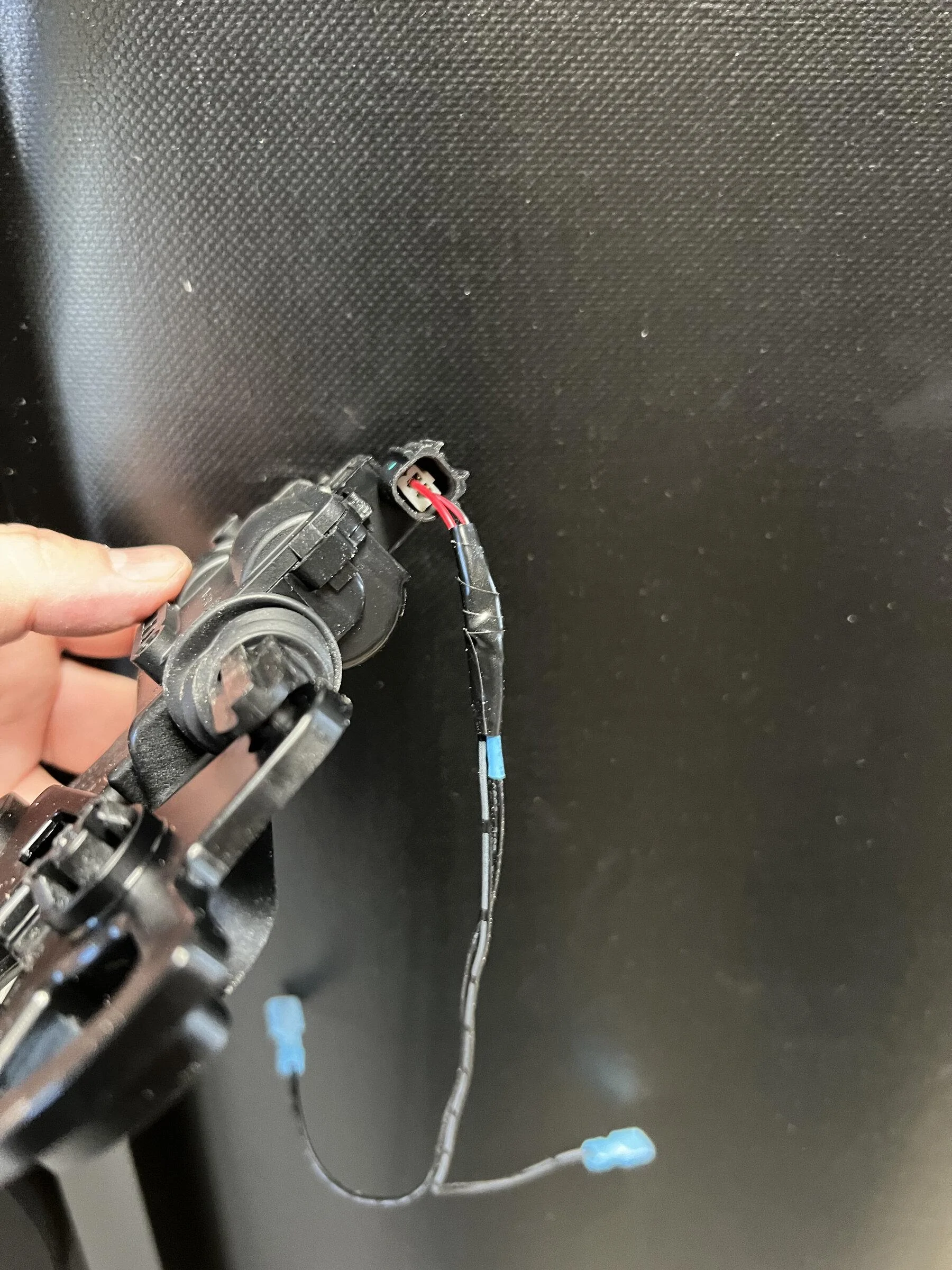

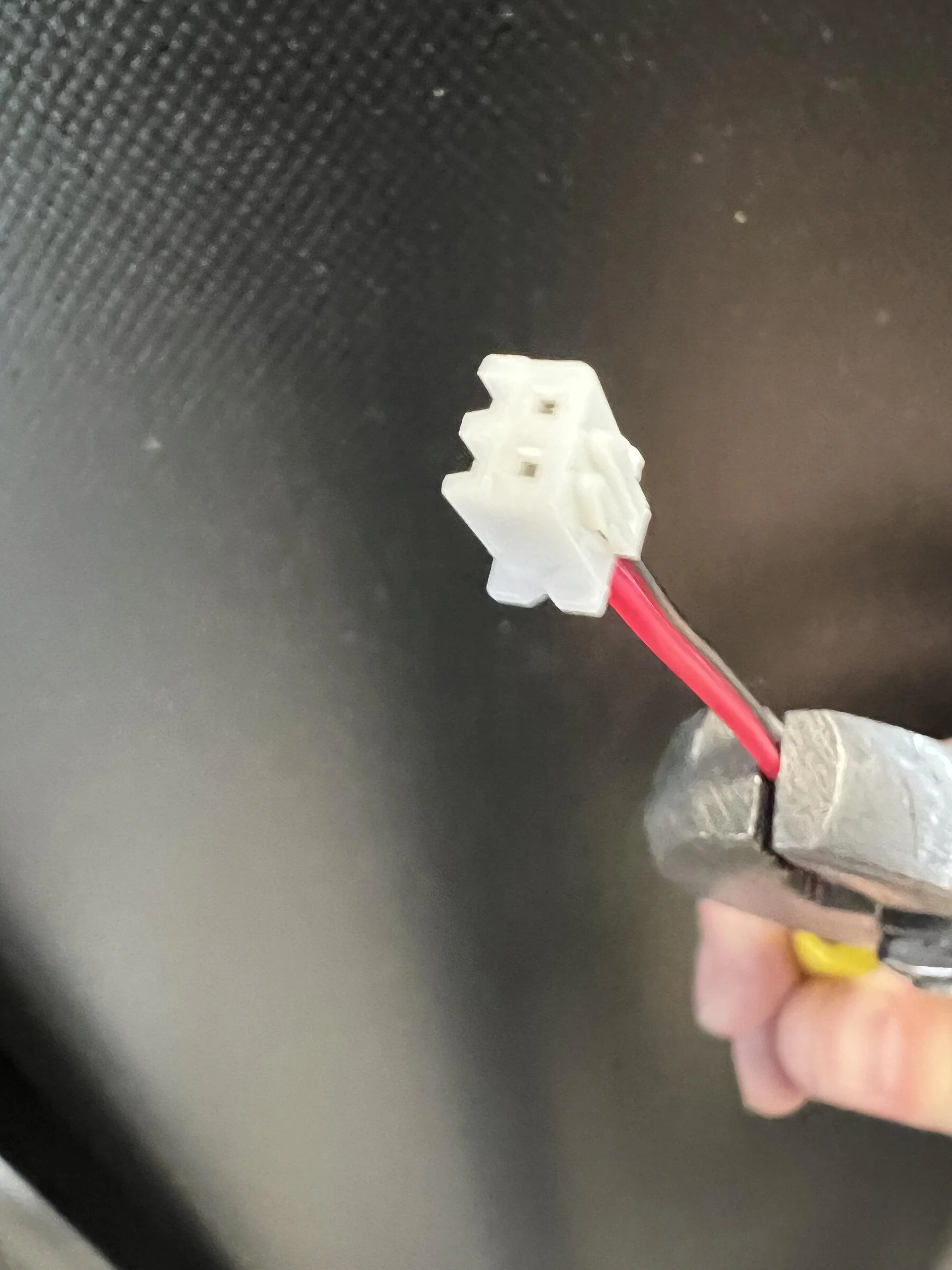

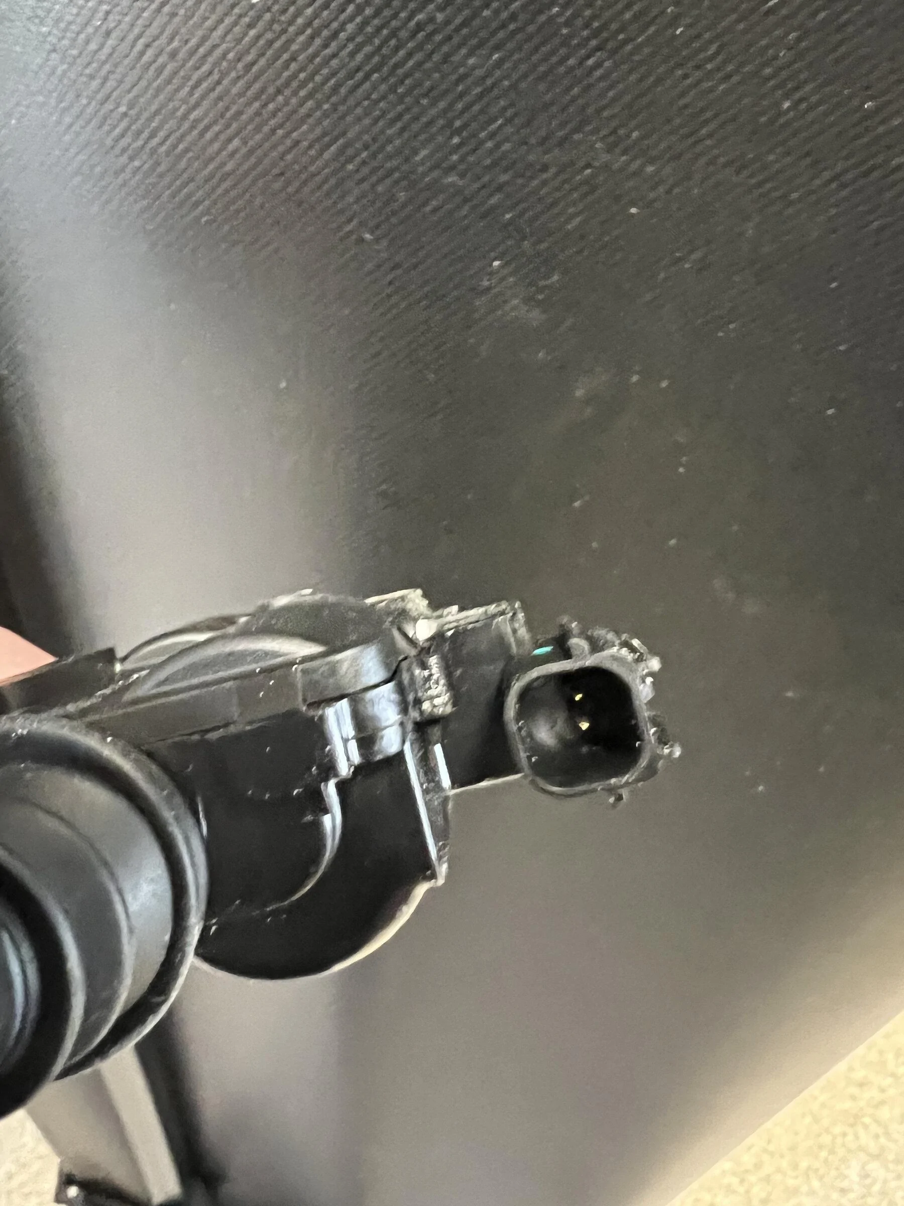

the control have a 2 pin socket.
I used a 2 pin connector plug from an old computer fan.
it fits perfectly inside the socket...

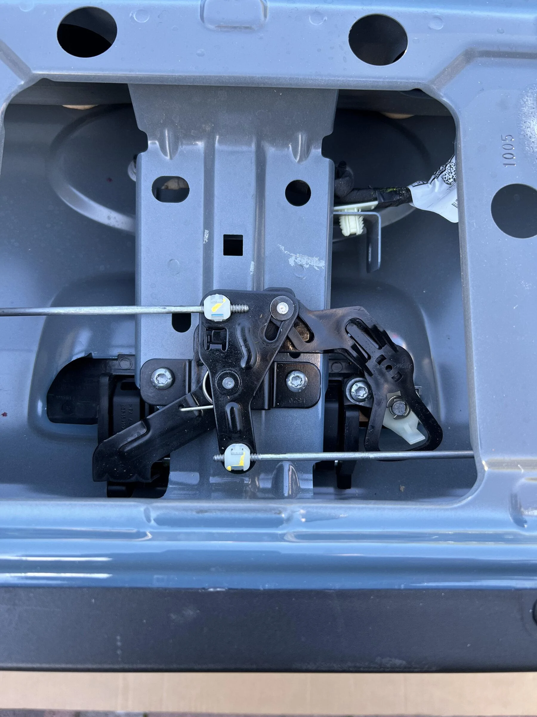

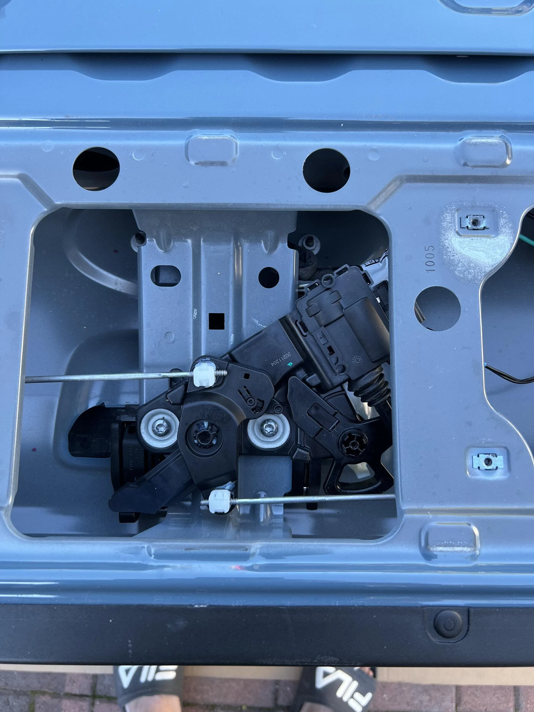

Removed the old manual control by removing the two bolts and detaching the two pull rods. Do the reverse to Install the new control. It will fit perfectly. Connect the cables. (for wiring...see below). All done.

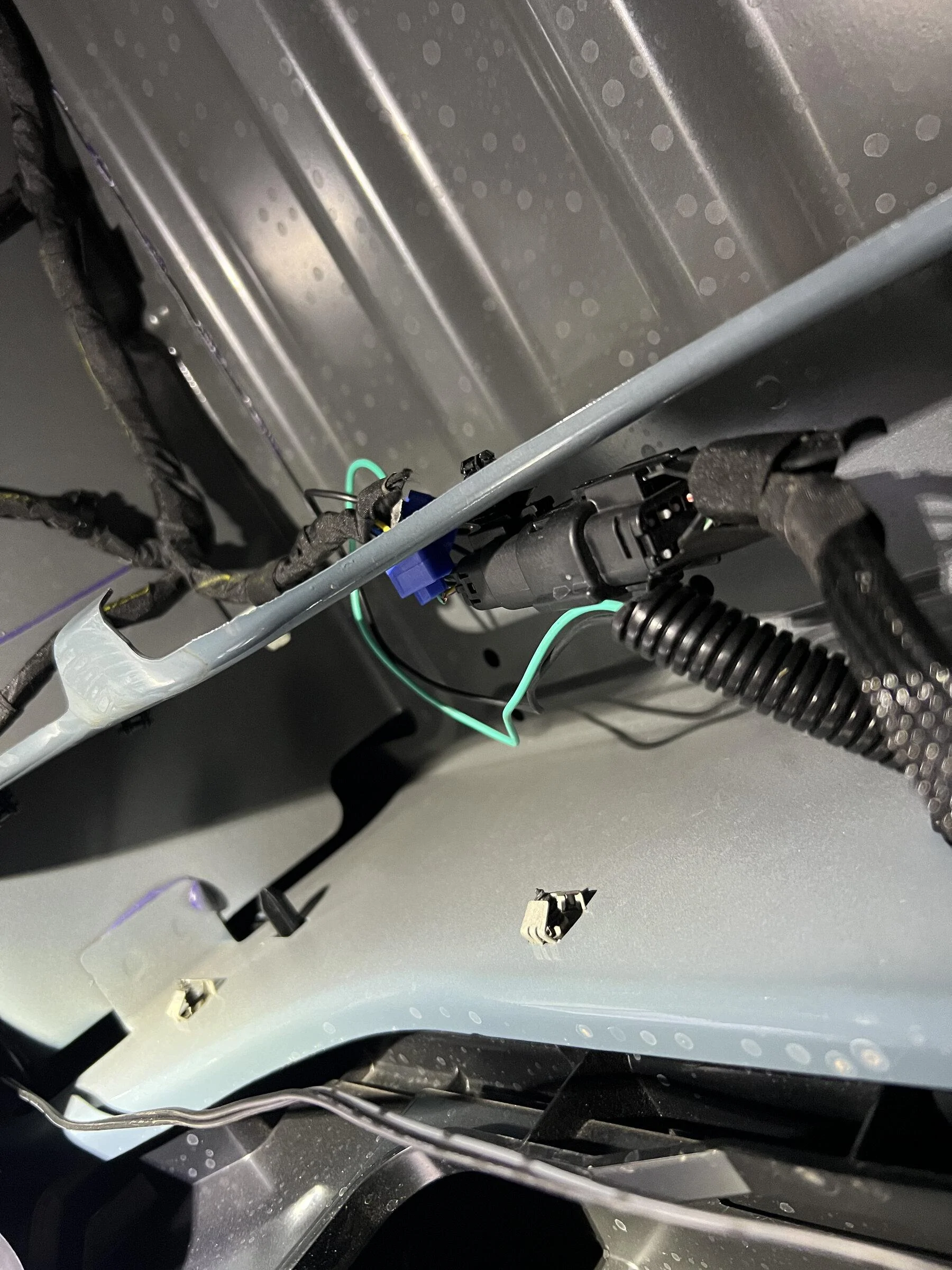

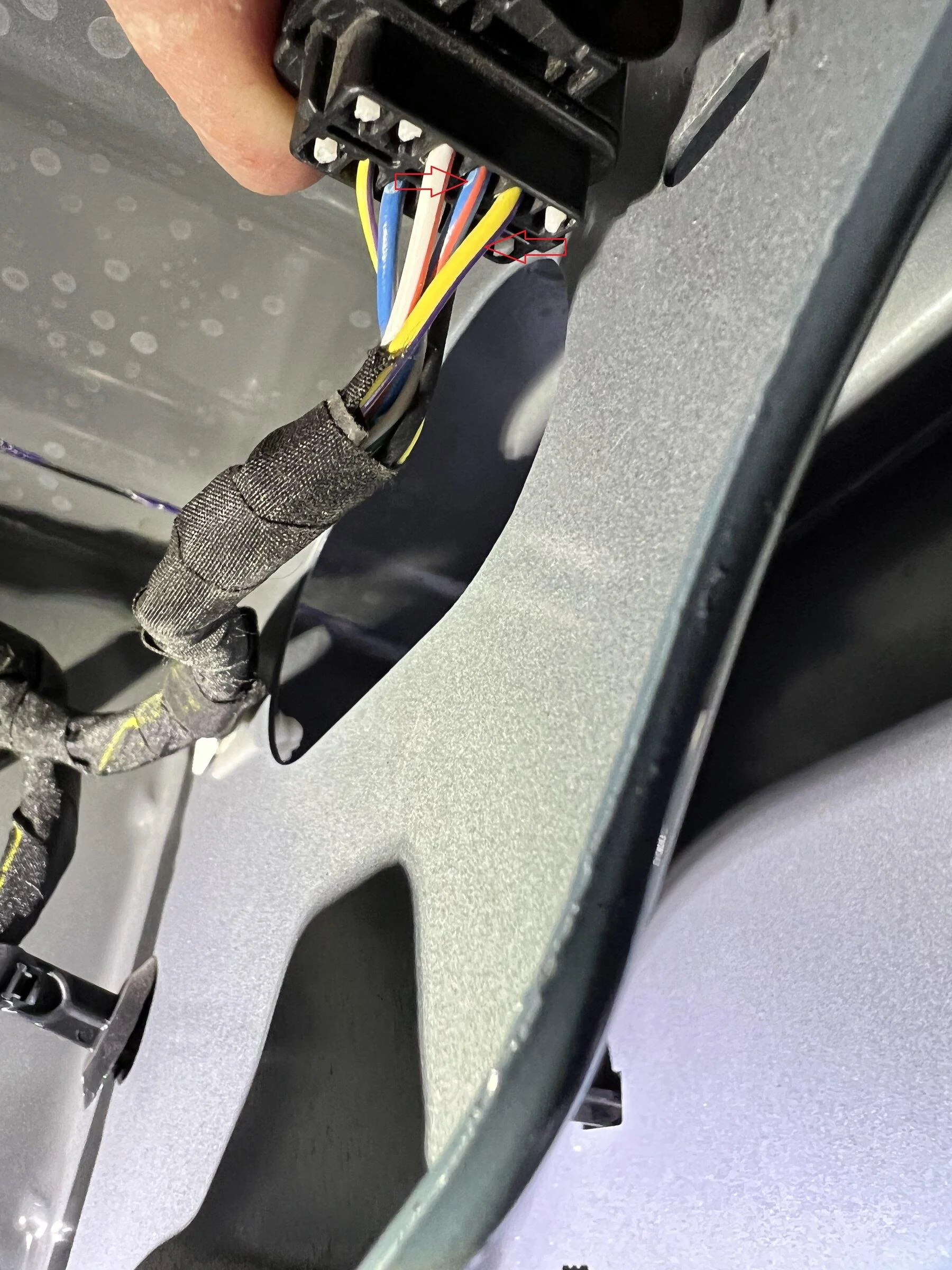

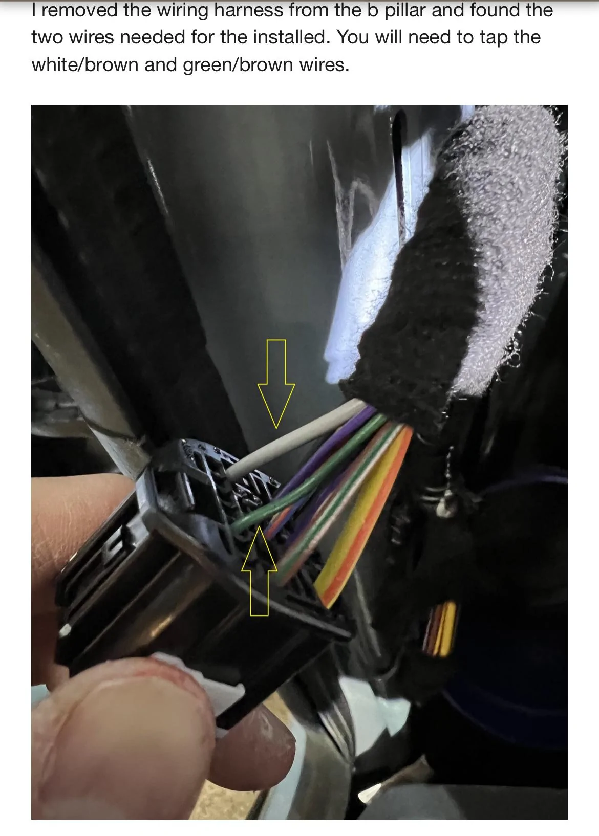

Thanks to Fakecowboy...I was able to track down the correct wires. remove the spare tire and find the harness for the backup camera. The wires are yellow/purple and Blue/Red.
Part you need:
JB3Z-9943170-A
