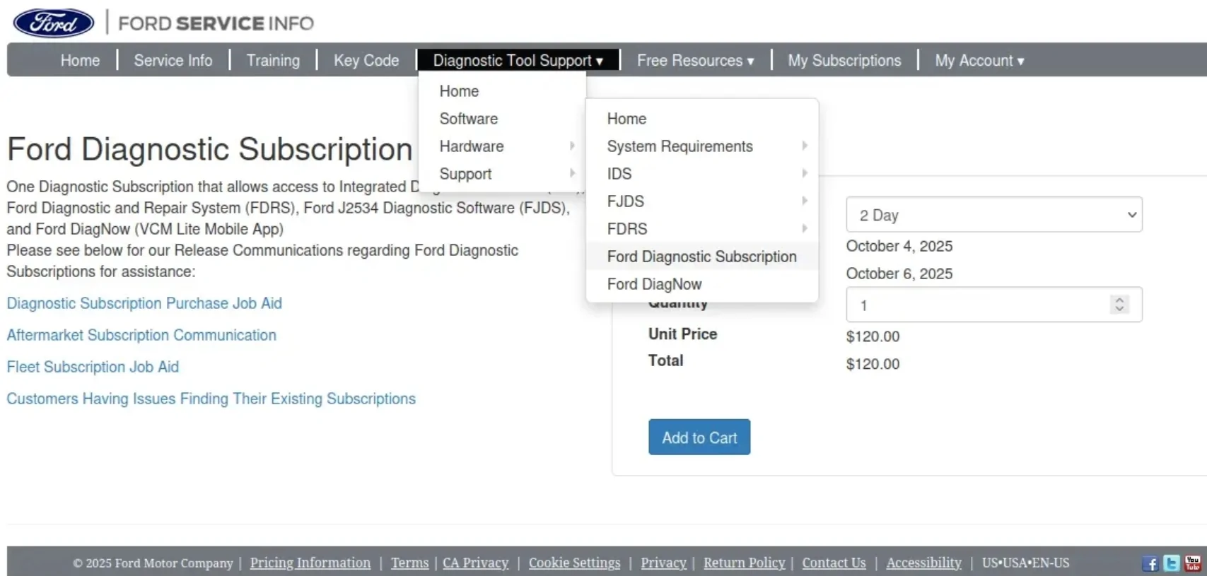

Ford changed FDRS to "subscription" October 2025, it's $120 for 2 days.
#16,320 https://www.f150gen14.com/forum/threads/ecu-module-programming-guide-using-fdrs.8249/post-722285
"Think I found it and answered "my own question...
- https://www.motorcraftservice.com
> Top menu - "Diagnostic tool support"
> Software
> Ford Diagnostic Subscription"
Good catch! It has been close to a year since I've purchased a license so I was just relying on links I had saved in my favorites.
If you don't mind I'll use your pic and link to update my post above.
