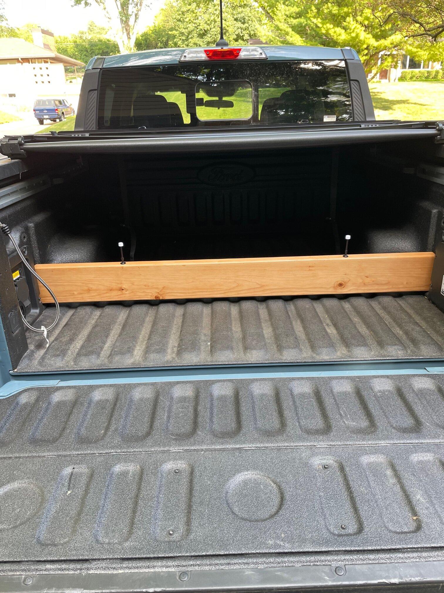

I cut mine to the correct length. It drops in ok but getting it out is kind of a pain with the SIBL. I also added cheapo door stoppers so I could hang the handles of the plastic grocery bags on them. The stoppers give you a place to lift up on the board (divider)

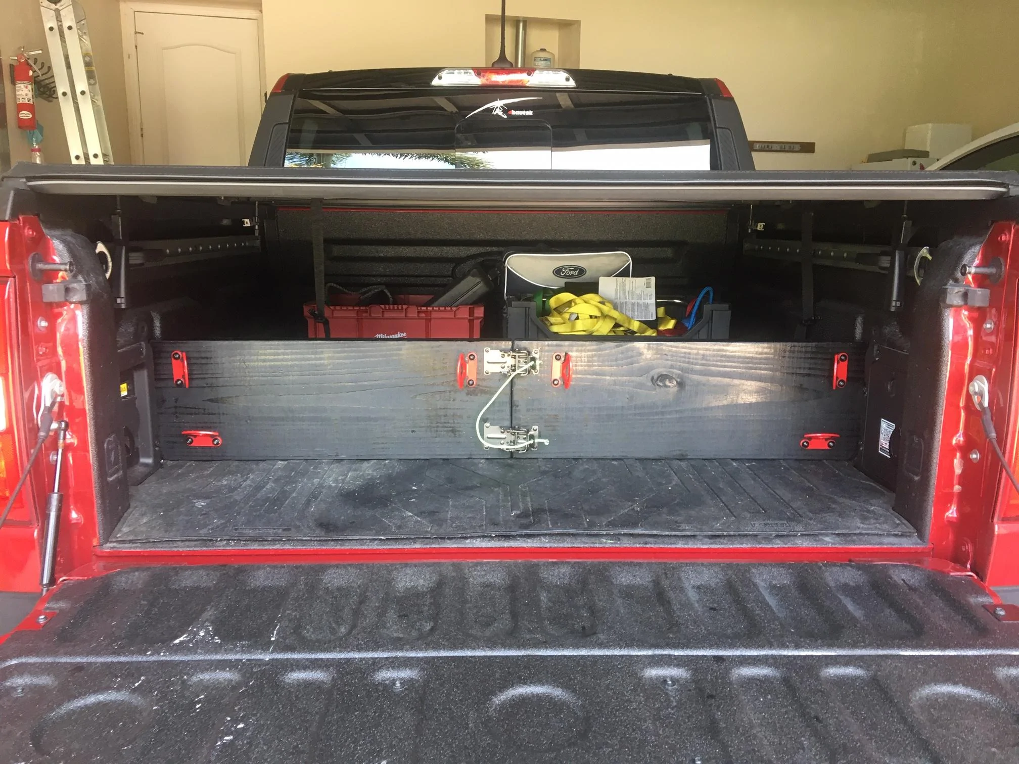

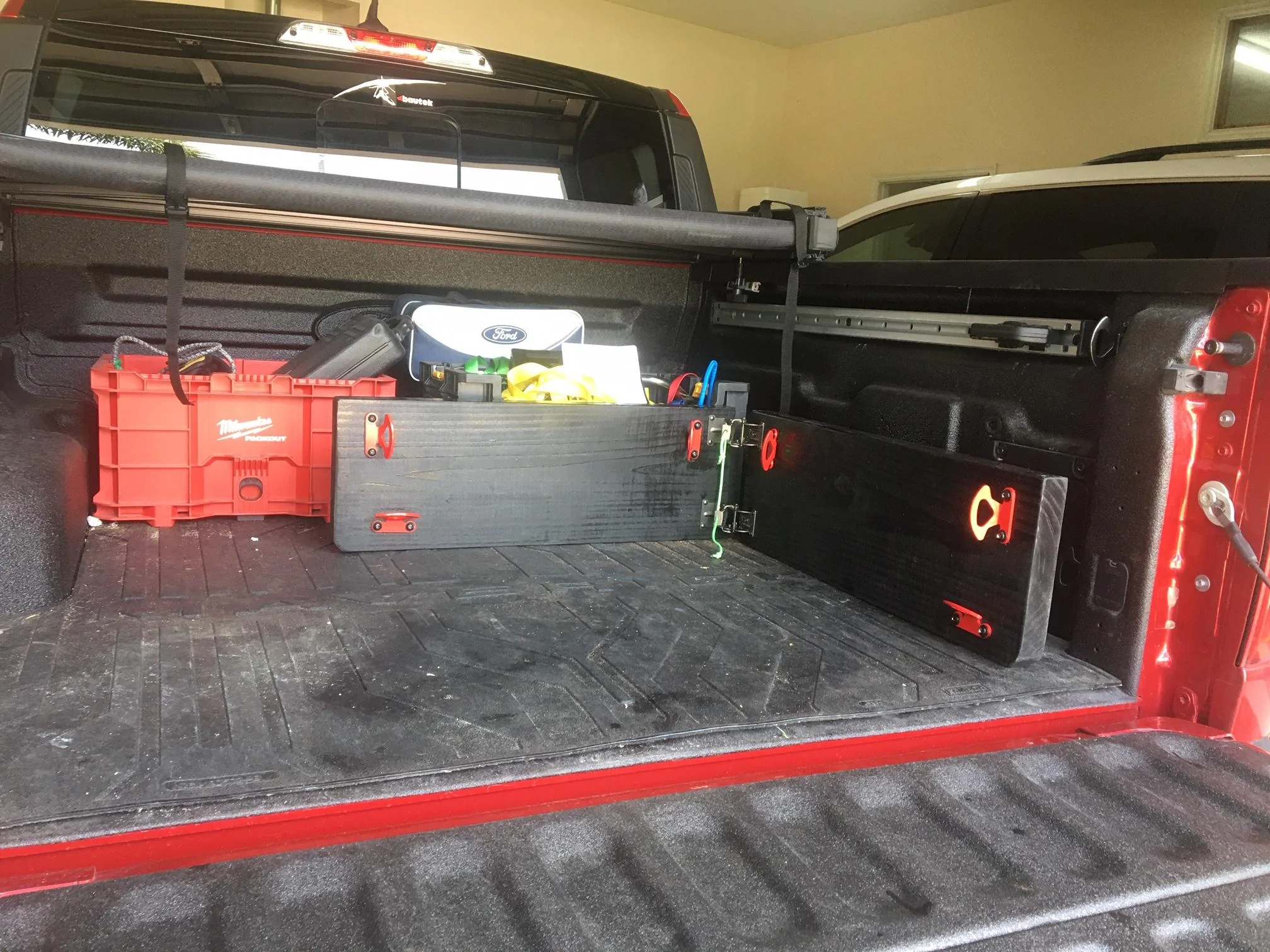

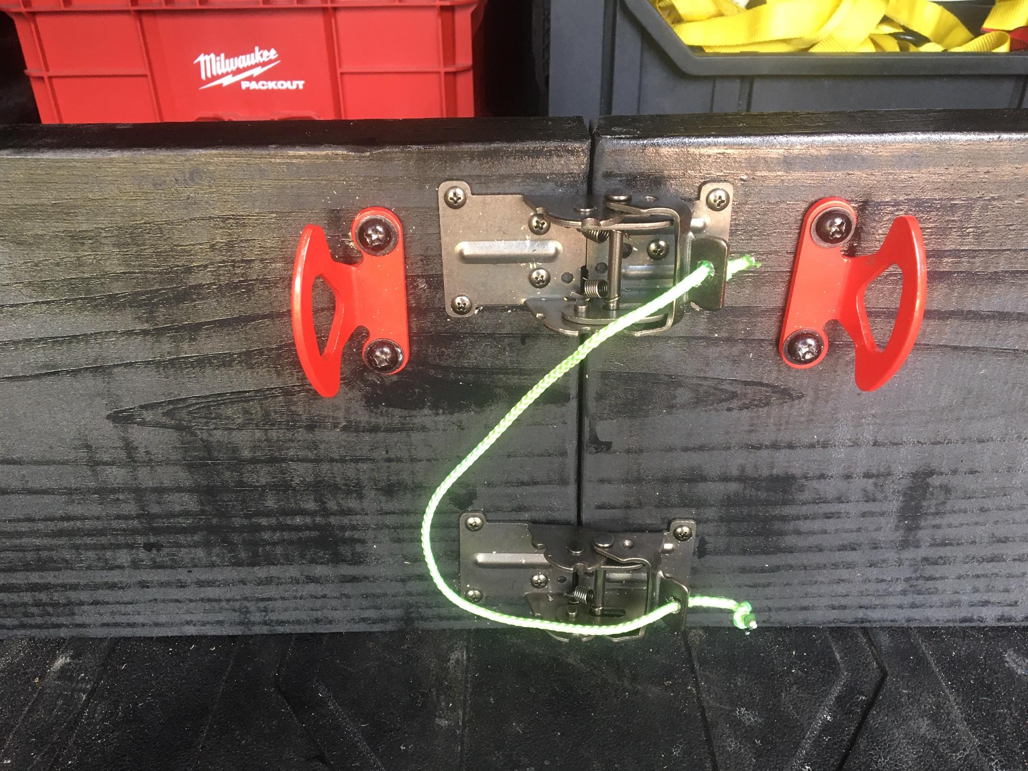

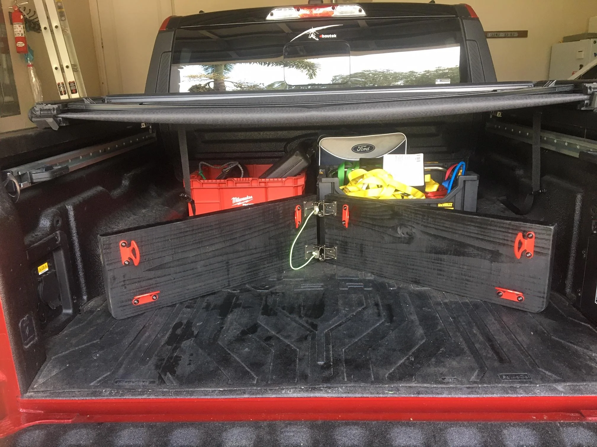

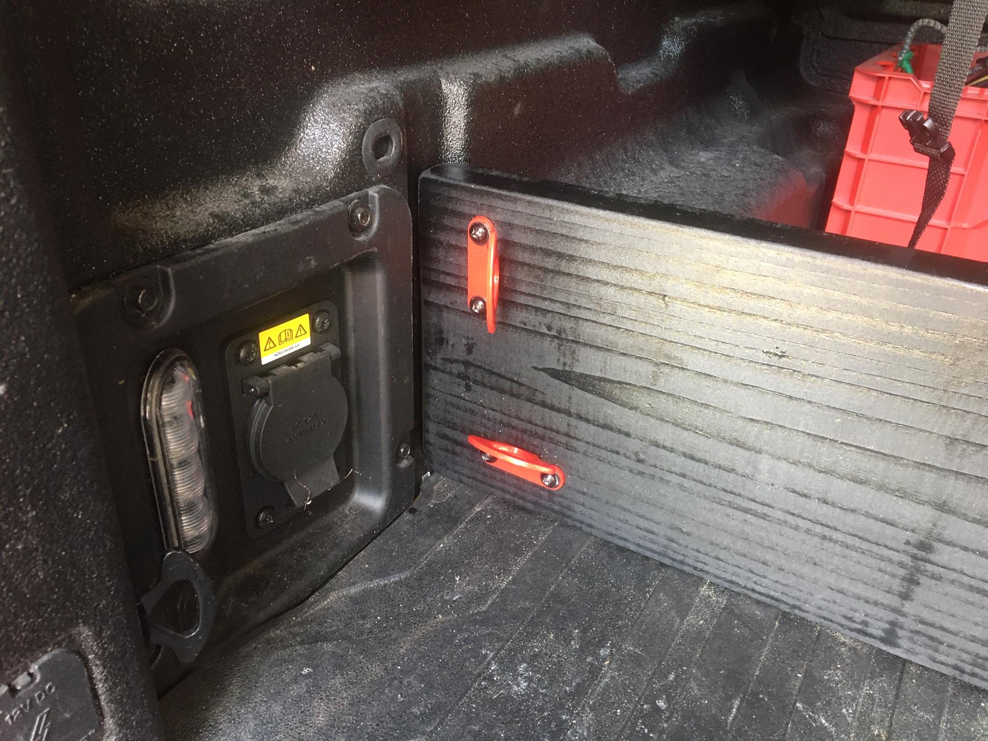

Since I installed my roof rack on the side rails, I can't slide up the divider. DIY bed divider with lockable hinges. I used a lighter weight 1x8 pine wood x2 cut to 54 1/4, lightly stained black. Cut in half and install lockable hinges for easy removal. Cheap hinge a pair for $12
Amazon link for the 180 degrees
https://www.amazon.com/Skelang-0°-90°-180°-Foldable-Extension-Workbench/dp/B0BN7YJT1V/ref=sr_1_1?crid=11FSI5AH5V52Z&keywords=Skelang+2+Pcs+Folding+Brakcet+0°-90°-180°&qid=1687957527&sprefix=skelang+2+pcs+folding+brakcet+0+-90+-180+,aps,111&sr=8-1

The lockable hinges are a great idea. I followed your advice and bought them at Amazon.
The hinges makes it versatile and easy to install !!
Here is the result:

So awesome dude, easy and cheap DIY!!
