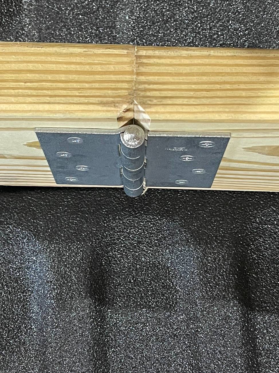

I used 2x6 treated lumber, galvanized non-removable pin hinges, and a galvanized latch. I beveled the boards behind the hinges so they sit flat when folded, and I also beveled the bottom ends of the divider to match the angle of the slots in the bed. I kept the boards raised slightly off the truck bed to help prevent water damage.

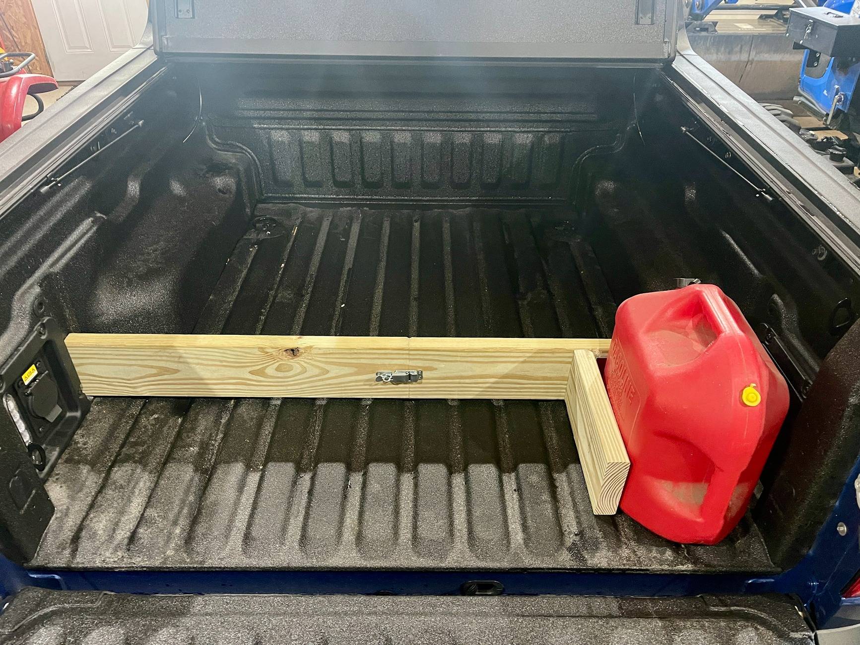

Here is the divider installed with a gas can.
Ford Maverick Simple DIY Folding Maverick Bed Divider – $30 Build IMG_2504

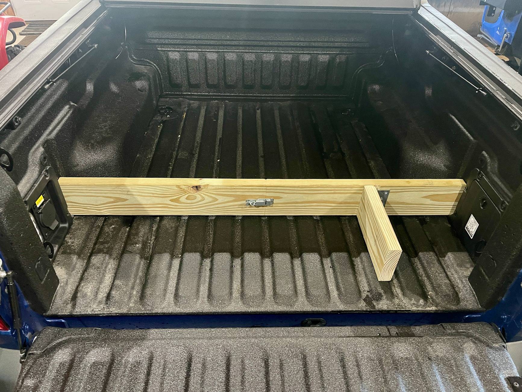

Here is the divider installed without the gas can.
Ford Maverick Simple DIY Folding Maverick Bed Divider – $30 Build IMG_2498

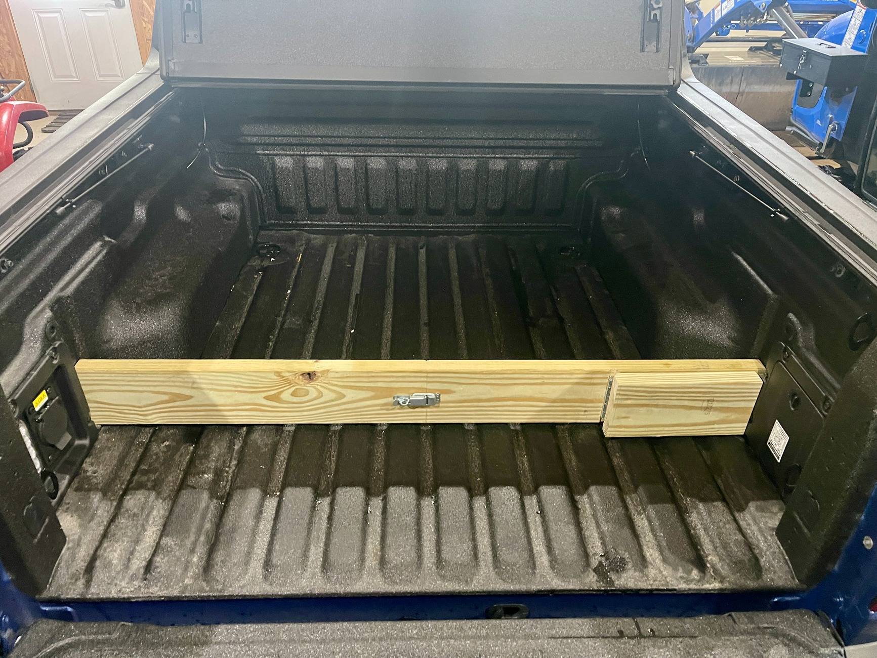

Here is the smaller arm folded up.
Ford Maverick Simple DIY Folding Maverick Bed Divider – $30 Build IMG_2499

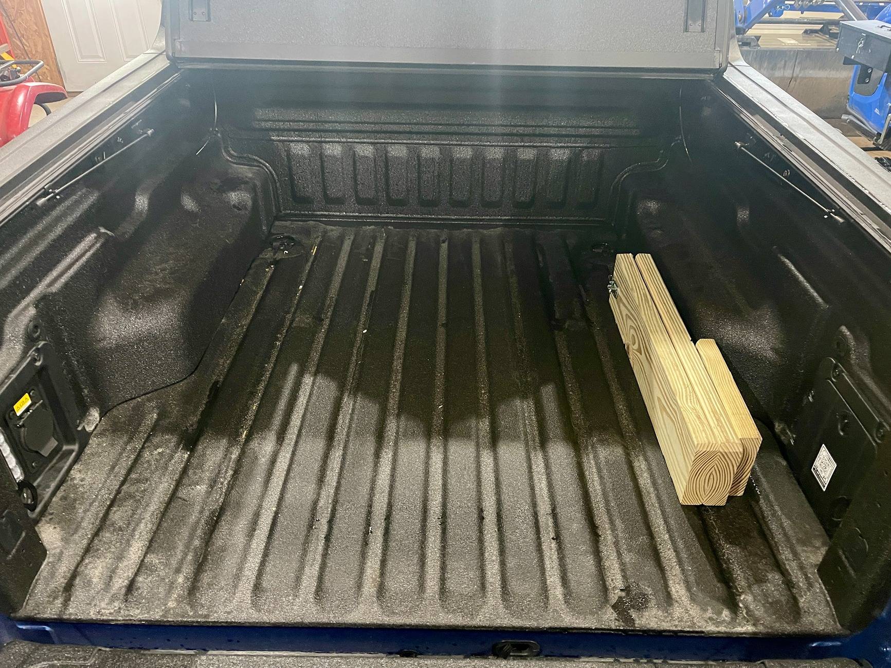

Here is the divider partially folded up.
Ford Maverick Simple DIY Folding Maverick Bed Divider – $30 Build IMG_2500
