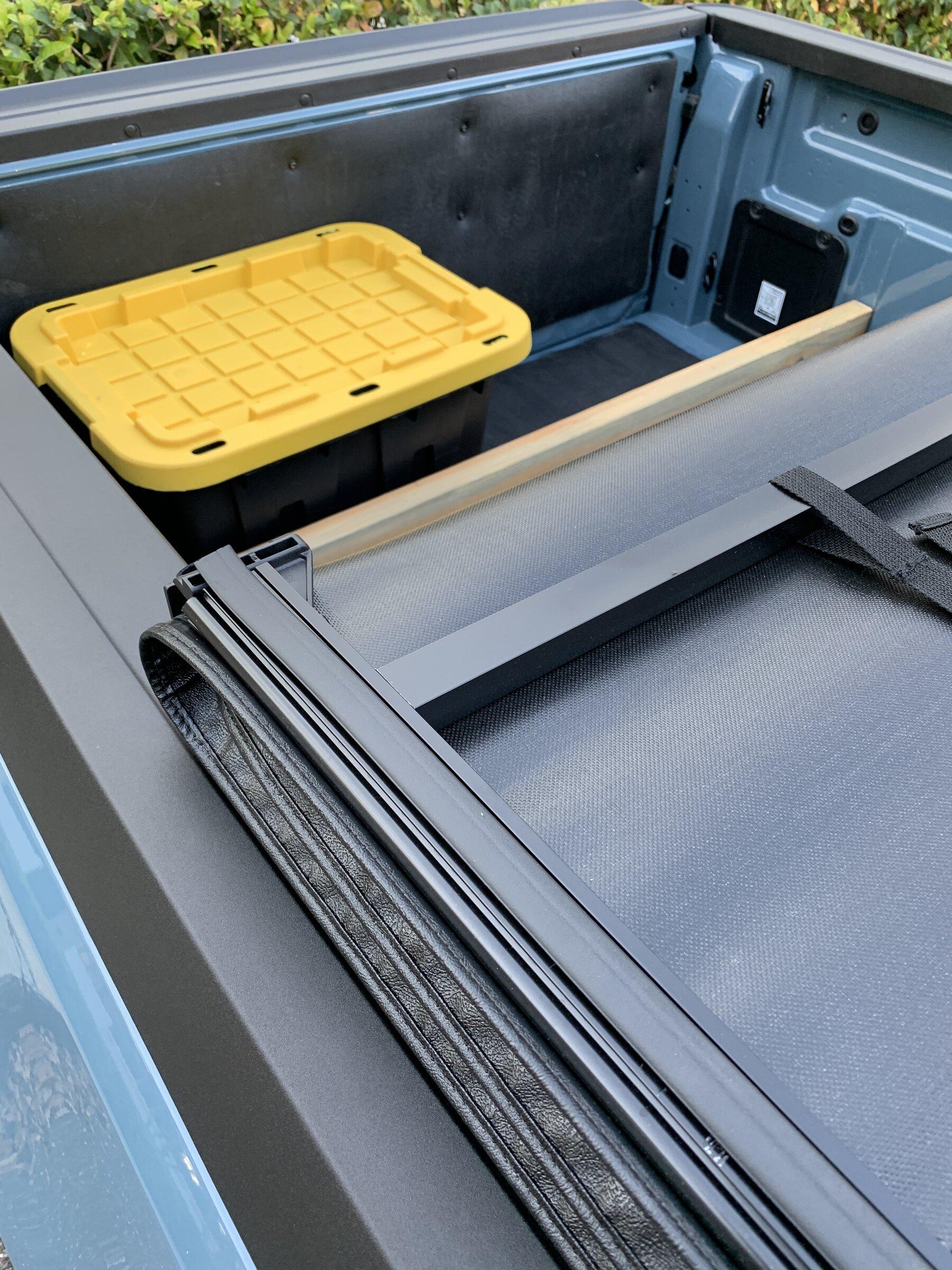

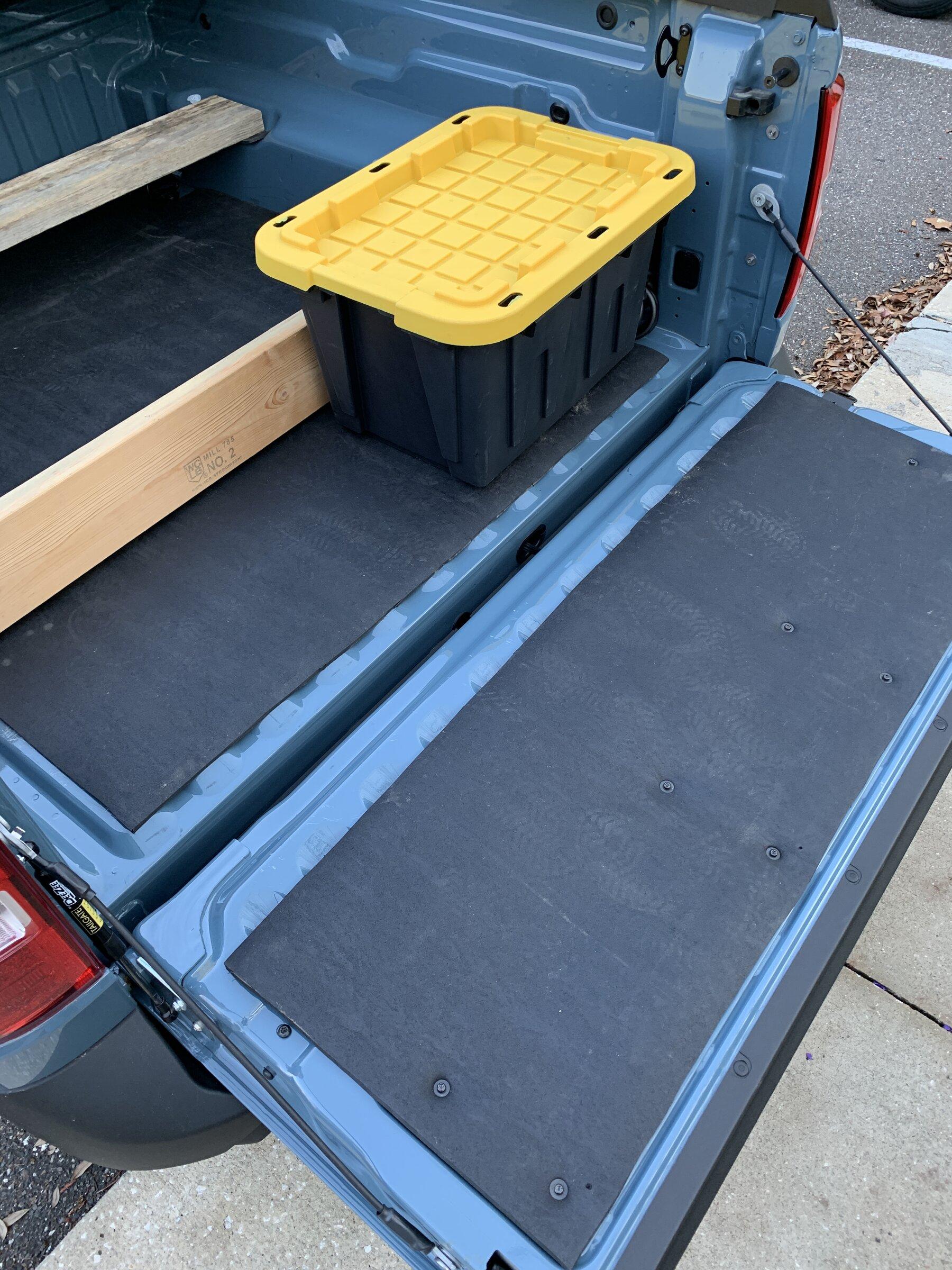

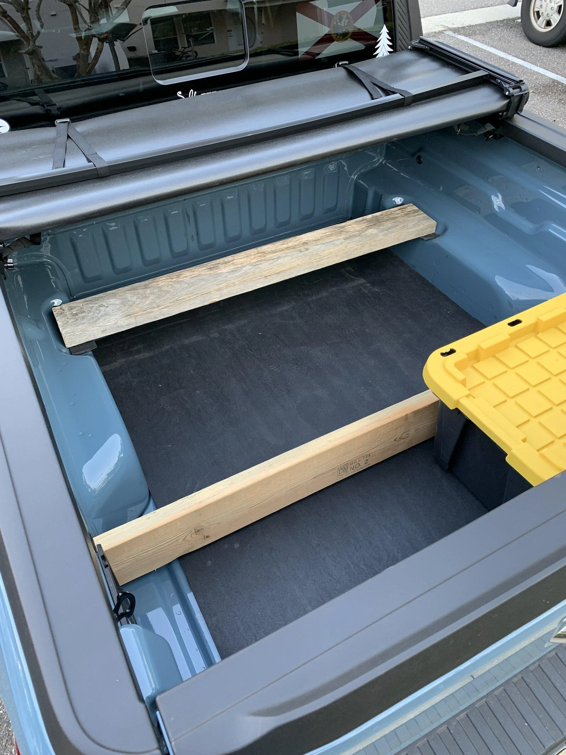

I originally ordered the Impact Mat from Bed Rug, but after two shipping delay notices decided to cancel it. Was going to go with the stall mat, but man did those things reek! So after looking around the store I went with the 1/4” rolled mat from TSC. I’ll be doing a spray-in and figured I’d use it as a little extra cushion once done.

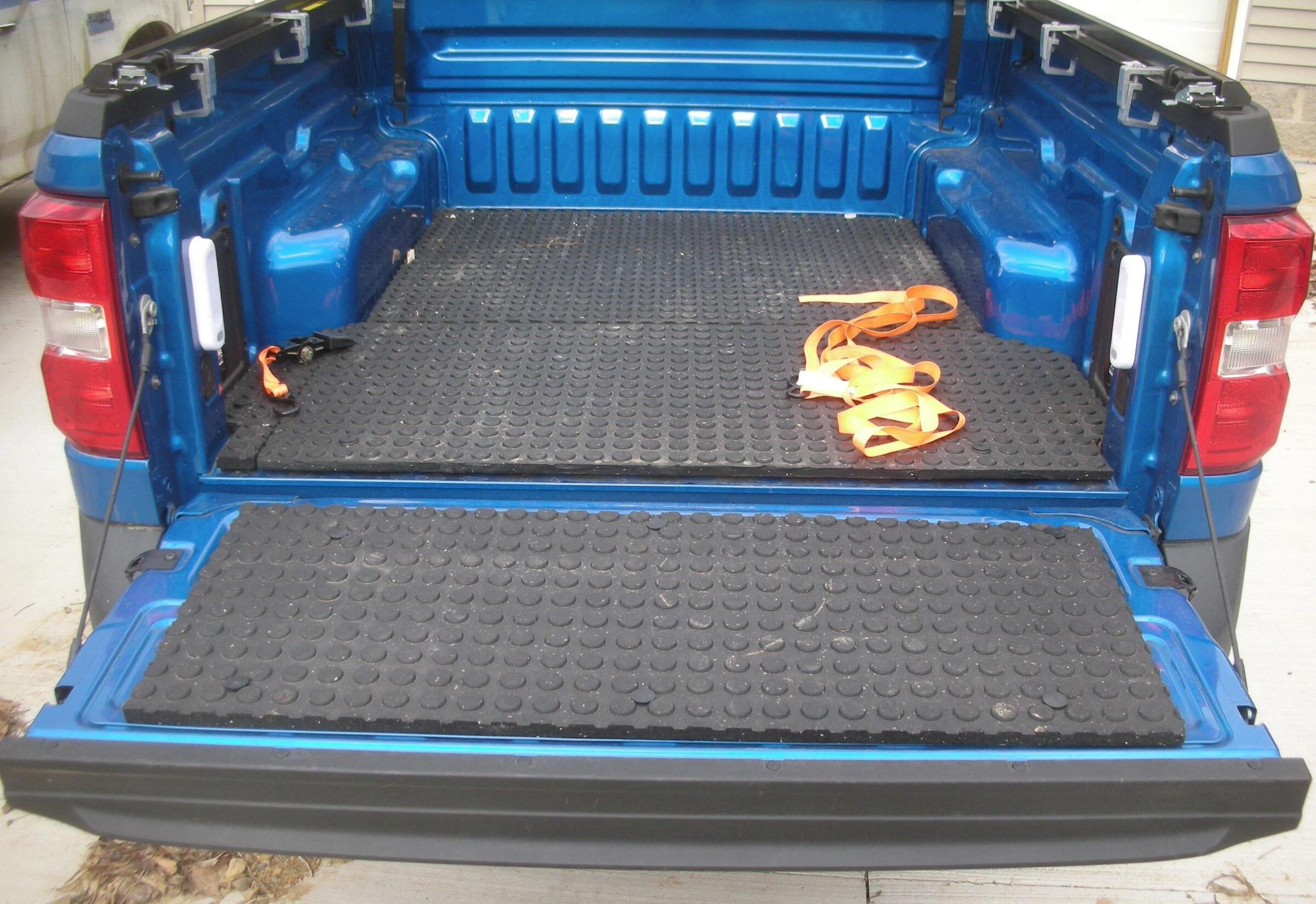

Here is my truck bed done with a 4 x 6 horse stall mat bought at tractor supply.
Total cost ~$60 including the automotive fasteners used to hold it in place.
Is that a Costco tub by chance?
Not 100% sure, but it’s either Costco or Sams. I bought a bunch when they had them in a couple of years ago.
I use that one for fragile/small items, been working well so far.

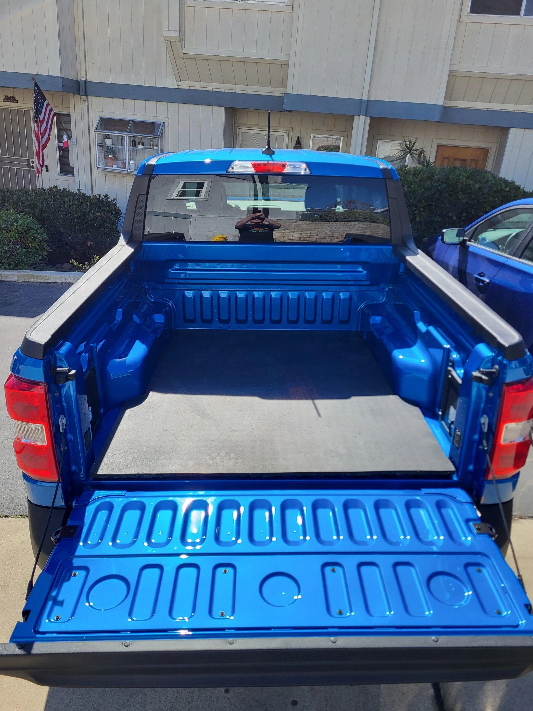

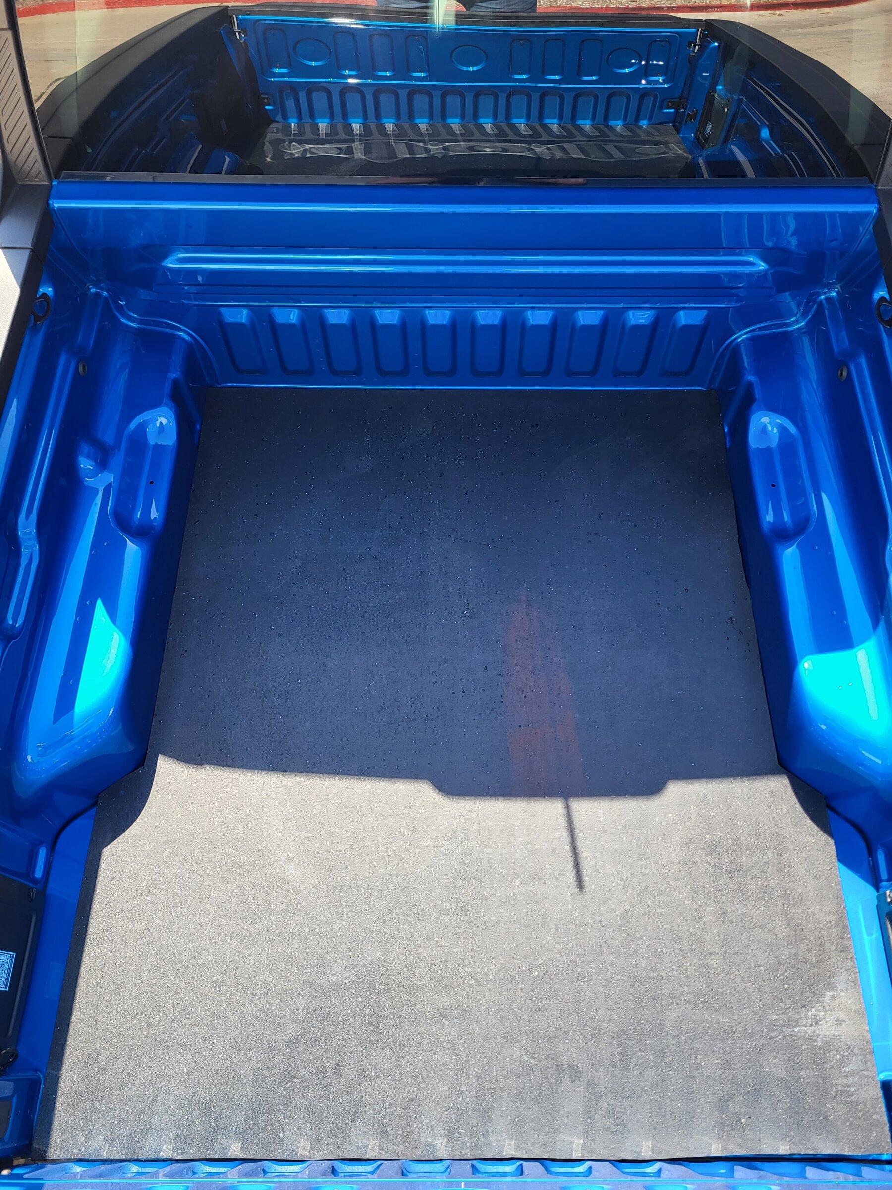

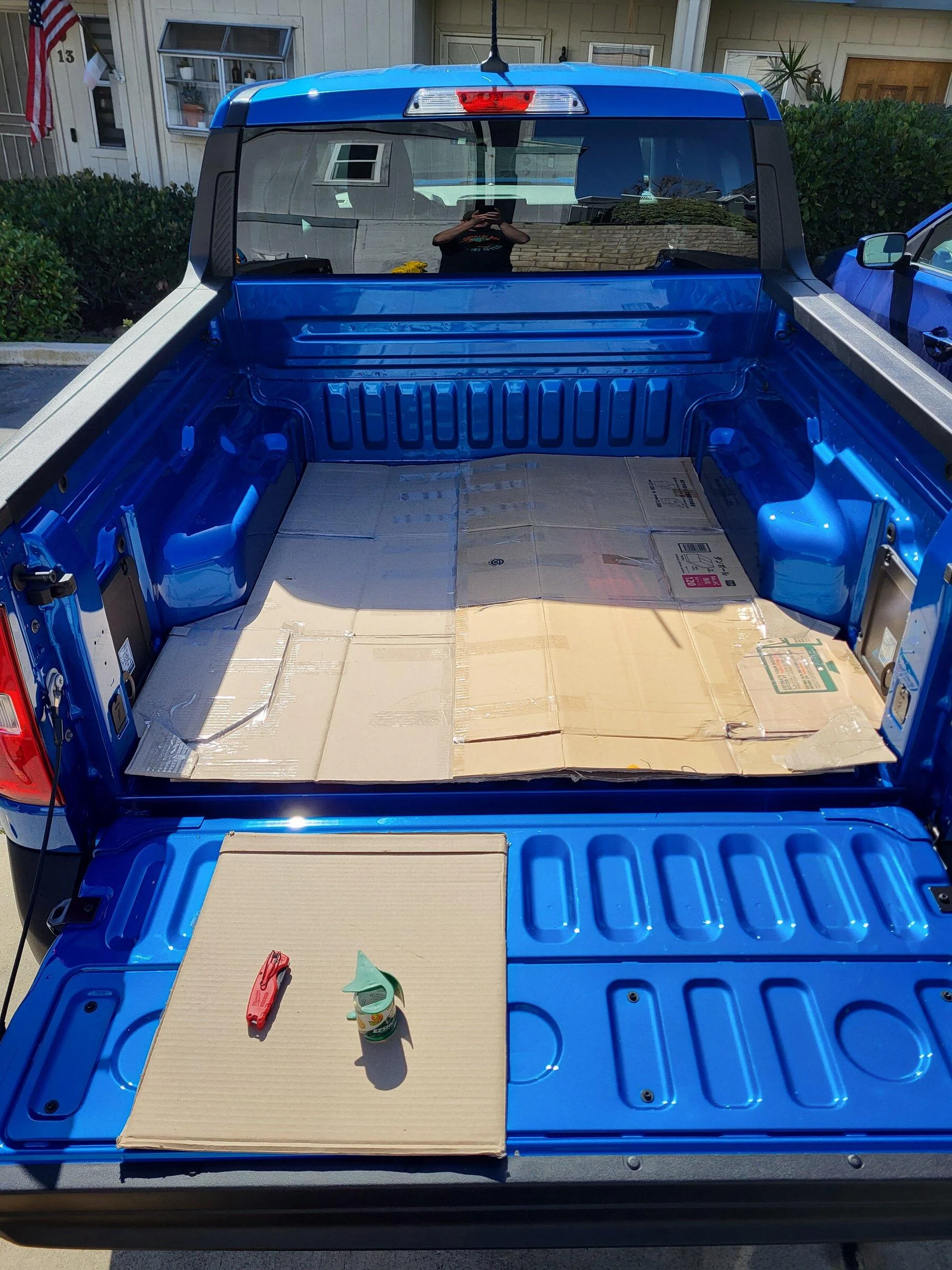

Horse stall mat is definitely the way to go. Picked one up for 50 bucks from Tractor Supply, made a cardboard template, and cut it with a utility knife. Hopefully it'll off gas enough that the smell will die down. Thanks for the idea.
