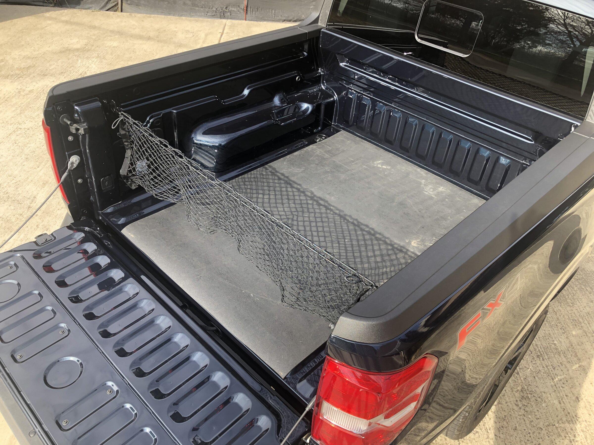

I hope this is helpful for people looking to DIY a bed mat. I purchased the horse stall mat from Tractor Supply ($47.00). Uncut, the mat is 4' x 6' x 3/4" and weighs a hefty 94lbs. I thought about using power tools to cut it, but after doing some brief Youtube research, I decided to cut it with a utility knife. It takes multiple passes with a new blade to cut through the material, but it wasn't too much work.
The main thing you need to do is cut the mat to the length of the bed, cut out the sections for the wheel wells, and then cut out to pieces for the tie downs near the front of the bed. To get a clean cut for the tie downs section, I used a forstner bit on the corners.
I also used a belt sander to break the sharp edges and round the back corners.
That's basically it. It took about a couple of hours of work to plan and make all the cuts. Here it is in the truck:
That looks great!

Great job. Was there enough left over for the tailgate?

Actually yes. The big piece I cut off would fit there pretty well. I think it could be attached if you get longer screws for the screws that are already in the tailgate. I didn’t try it, but it came to mind and I may give it a go.

I work on those mats at home and at work and just thought you may want to be a little careful when cleaning out the bed and pulling the mat. Any dirt or what have you that gets under it will be under a good amount of pressure when sliding it in and out. It you have alot of grit under it you may want to flush it out with the hose before sliding the mat out and scratching up the paint excessively.
Totally workable, but might be a good precaution to keep your bed nice.
