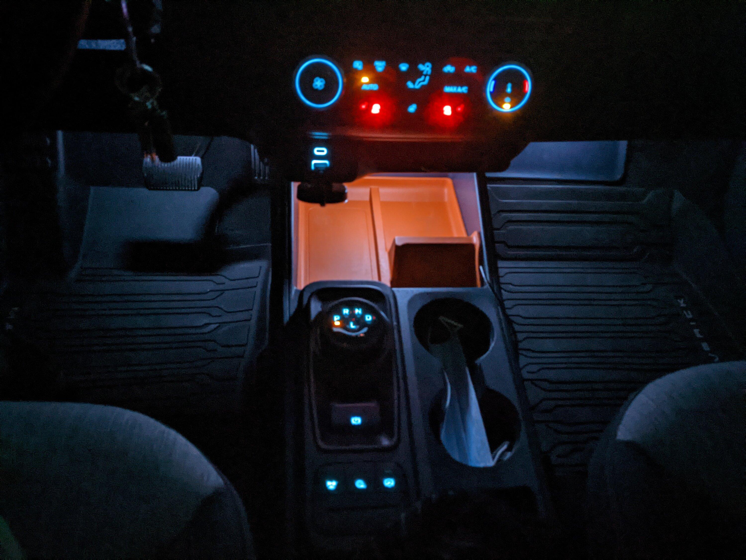

Instead of ordering the factory part, I decided to just make my own ambient/console light.
Remove the lid (clips circled in green, other clips are hidden towards the back) and unplug the harness (red circle) that is used to illuminate the USB ports.
Ford Maverick DIY - Adding ambient light(s) to 2023 Maverick XL/XLT for <$10 F439AD4A-A292-4D4F-89A2-8CD35CEB29DD~2
(picture credited to @Executech)
Ford Maverick DIY - Adding ambient light(s) to 2023 Maverick XL/XLT for <$10 PXL_20230114_170550720~2
You'll tap into the white/stripe for your (-) ground and purple/stripe will be your 12v (+) positive - these will dim along with the dimmer switch on the dashboard. The yellow/stripe is switched 12v that can be used for some other low power accessory. Dash cam, etc...
I used an LED light along with a 1k ohm resistor, soldered them together, wired everything up with some spare 18ga and taped them up. Shrink tubing would also work, but I didn't have any and didn't want to go back to the store. I used a 3M Command Strip and mounted it where the factory light would've been (there's an outline in the molding).

Looks pretty good. I might purchase some more and do the footwells.
Hell yes! I was following your other post on this. You went from "Ford took this away from the 23" to "now my 23 has it" in a weekend! Definitely saving this if I feel like I want that extra lighting when mine comes in.

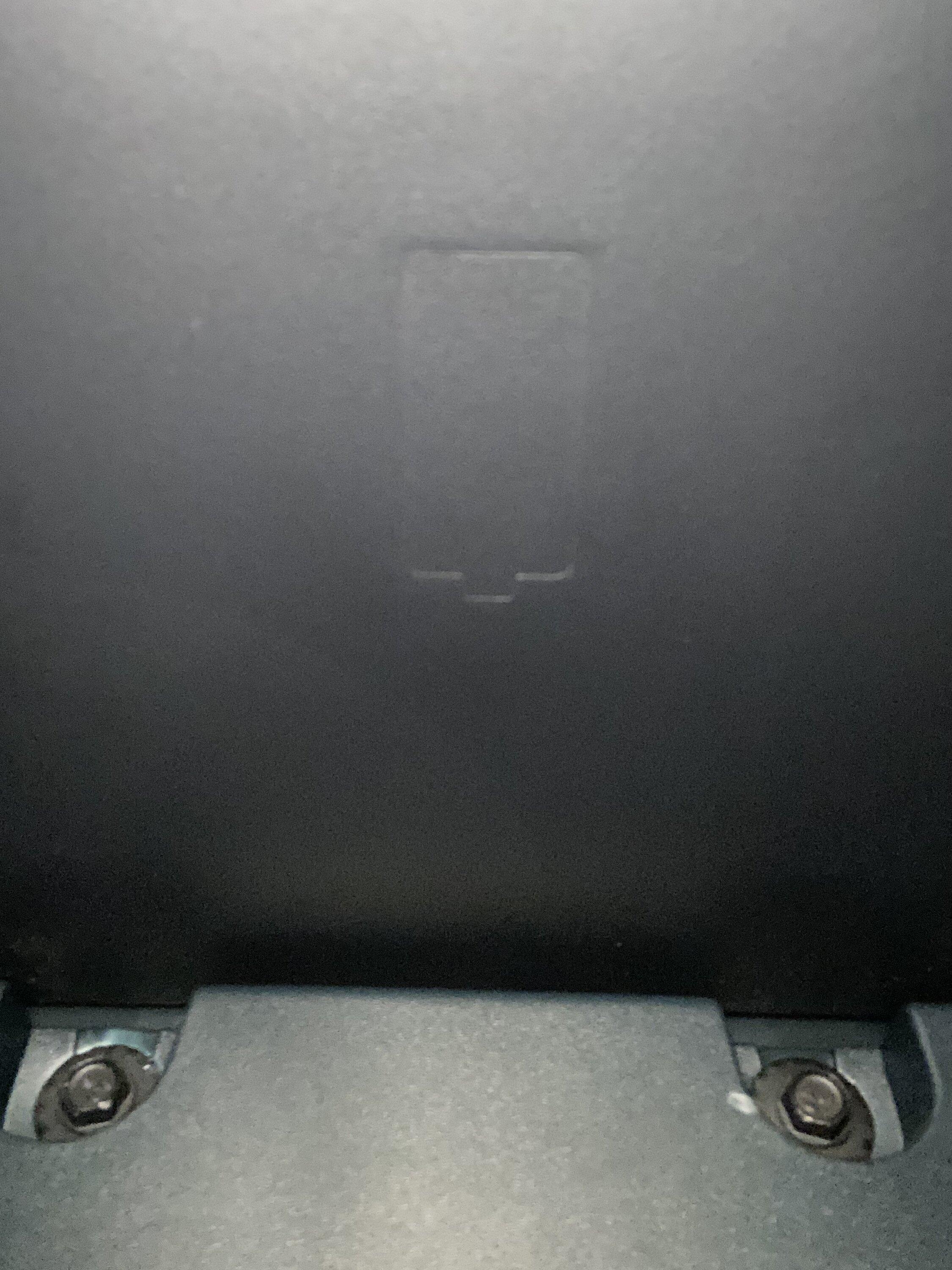

Also, my current console plate has the LED cutout visible. Does that just punch out or does the 2022 console plate actually have that area clean cut already with the hole for the LED?
From what I could see from Ford's part lookup, yes, it's precut. However, without actually ordering it and being 100%, I can't say for sure.

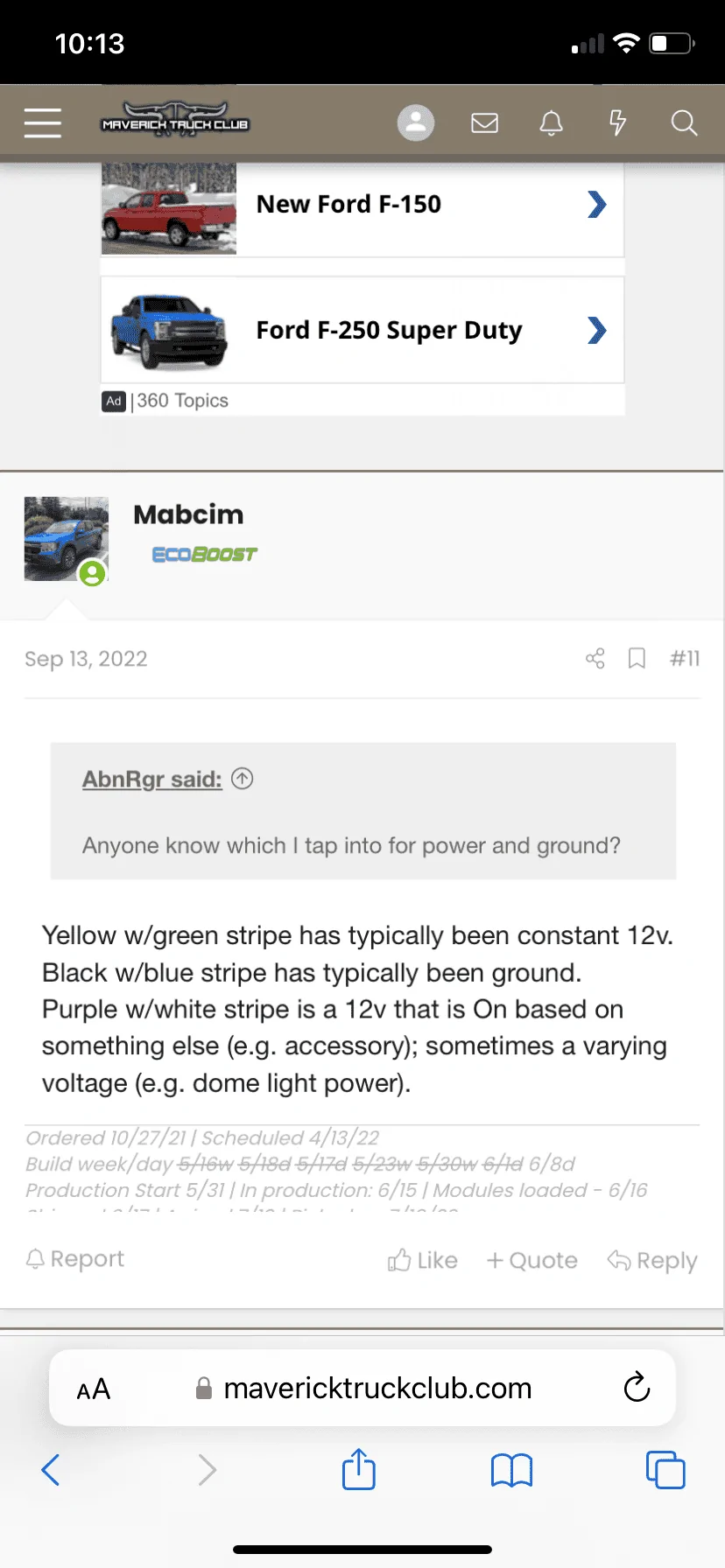

Below is a post from another thread regarding the wire colors. Based on the information below, do you reason that the yellow/green and black/blue wires would be used with the purple/white left alone? I just want to confirm that the factory LED can in fact be used with your setup and I plan to order it and the 2022 plate.
Edit: link to the post referenced below https://www.mavericktruckclub.com/forum/threads/ambient-footwell-lighting.19155/
