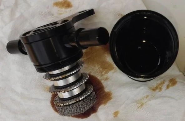

No need huh? 5k miles since i last checked it.
Wow! Do you live at the redline or have a broken ring or something? That's not normal. It doesn't even seem to have any water in it, which is basically all that other people with the catch can addition find.
Its a daily driver that sees the occasional autocross course. Nothing wrong at all and others have the same experience. Catch cans arent just for condensation. They're in place to keep the oil off of the valves and to help keep oil from mixing with the fuel to decrease detonation. I run them on every DI engine i have which is currently at 3. Chevy 3.6, VW 2.0 and the Mav 2.0 all of which have catch cans. My mustang has 2 catch cans. My lightning has the pcv system vented into the exhaust. Im currently waiting on a catch can system for my Corvette.
