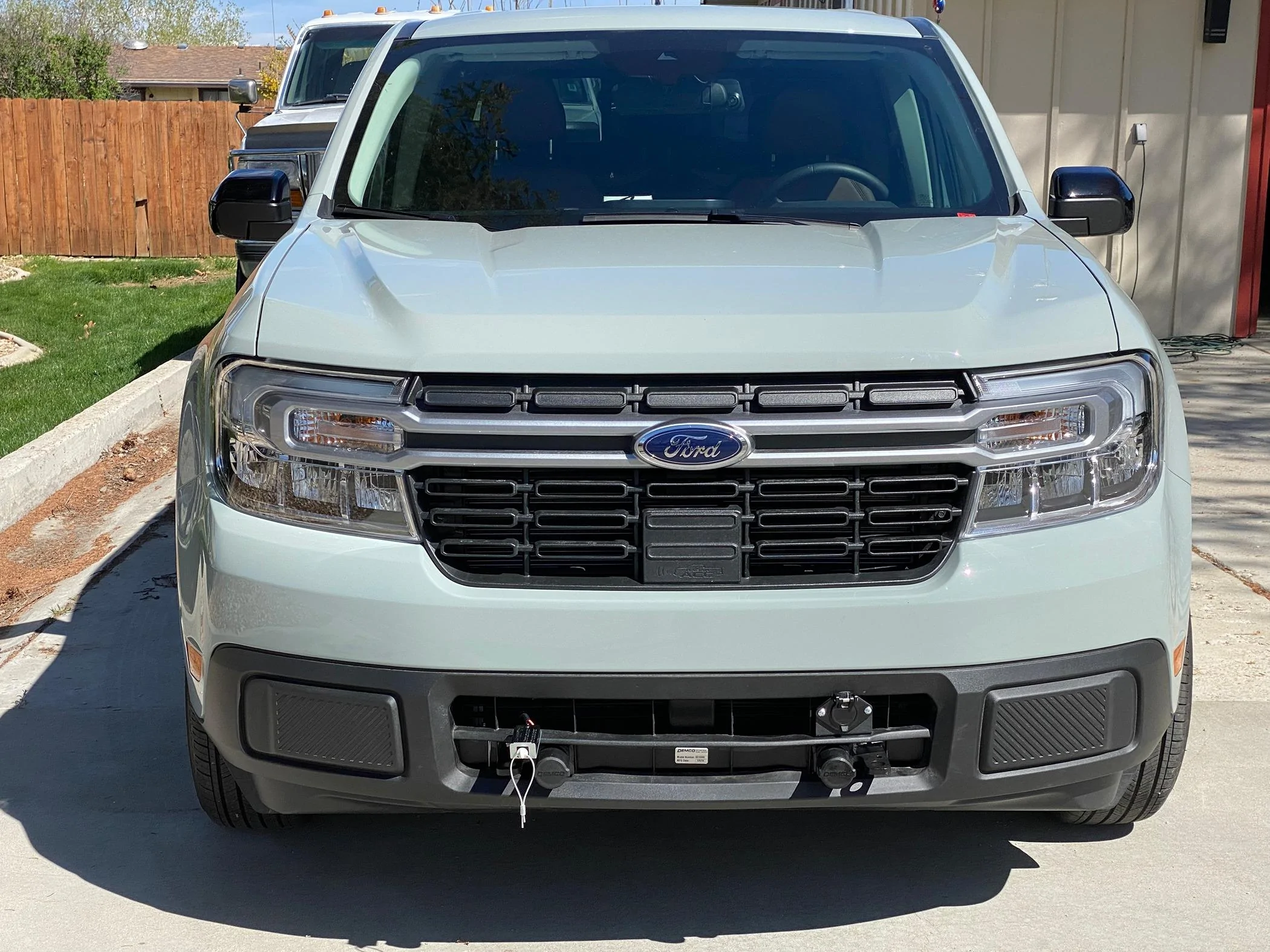

Rob can you tell me how you mounted the bracket for the 6 pin? I like the way yours looks.

I screwed it into the facia bar directly using U-clips you can get at any auto store or Harbor Freight. The clip fits around the plastic fin in the grill and gives it at least a little support. I don't expect it to last too long, though. If you have a heavy umbilical, or if it gets a little tension on it, it will bend down that facia fin a bit. I've also got the shorter Hopkins breakaway switch coming so that won't stick out so far.

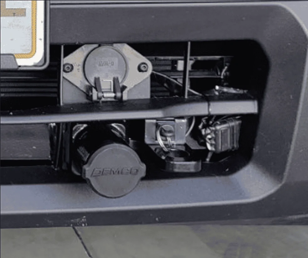

I discarded the way-too-large and heavy Demco 6-pin plate and bought a much smaller metal plate from Amazon for about $6. I mounted it "lip forward" into the slot made by the horizintal part of the grill. I used 3M VHB tape to secure it there, just atop the baseplate bar. Same thing (3M) for the smallest Hopkins breakaway switch I could find for the BrakeBuddy which is mounted on the safety chain flat area.
Here's the closeup of the electric. Demco screwed the pooch on preparing for a 6-pin mount. They could have done much more than just toss a big mounting plate in the box. Notice the 6-pin is upside down and I used a grinder to remove a lot of the tab. 6-pin is plastic. I also cut the rear rubber sheathing on the inside, made sure the wires all were bent and coming out of the side...as straight out the back looked too close to fins.
I finally completed my install. The 6 pin mount took some head scratching and wall staring but I figured out a good one...I hope. I used the huge bracket from Demco as a mounting plate for the much smaller bracket and "voila!" I have a front facing mount. Self tapping screws and bolts through both brackets secured everything well.
That is a really slick idea! Looks great!

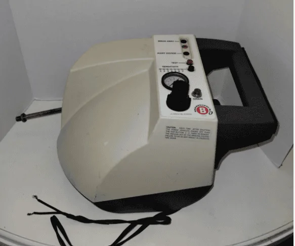

Didn't you say that you have a Brake Buddy Classic? If so, how do you brace it in front of the seat? Mine seems like it will work but a fourth of the unit is under the seat. I've been testing and it seems that the lowest setting for mine is 4. Anything less and it does not hardly move the piston.
I think my BrakeBuddy pre-dates the official "BrakeBuddy Classic" and is actualy an "Original" BrakeBuddy. The brace at the rear is adjustable with a large nut to move it to properly catch the seat. I have always set it at "2" because I only want the brake help when it is a hard stop. Mine looks like this one:

Mine has a digital readout but is basically the same. I'll recheck on that adjustment knob.

Du'oh....I've had that thing for 15 or 20 years and towed a Honda all over the country with it inside. I never had to adjust the handle up! It will work fine.

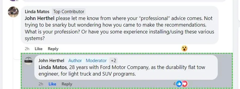

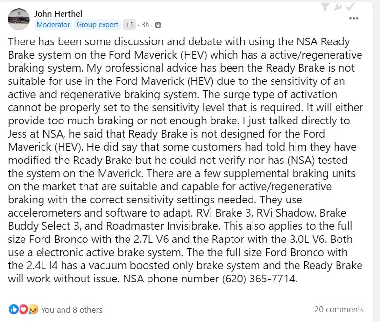

I often get asked what I use for supplemental braking (an old BrakeBuddy). Here is a definitive post from the FB page, "Towing Behind a Motorhome" about NSA being a bad choice. Also, you will see this person's qualifications in the second attachment. I set my BrakeBuddy's sensitivity at "2" (1-4 is available) and try to drive so I never need it except in a real emergency.

Yet I also called NSA and talked with the same person this poster talked to. Jesse said to me he did NOT tell anyone you should not use the Ready Brute II system with a hybrid. Note that the poster said in HIS OPINION the Ready Brute system is not suitable for use in a Maverick. Nothing about his ACTUAL experience with using one. An Engineer should know to have more actual facts before declaring it "unsuitable". Not recommended is ok, if that is the way he feels.
Jesse DID say there were issues with surging that they are aware of. I experienced those myself.
I have never used an auxiliary braking system that was easier to hook up and actually comes in as soon as you hit the coach brakes. You can feel a wee bit of tug from it too, something hard to do with the electric units I had before.
NSA has pictures and information about my fix for the surging. It completely solved that. I installed a short hydraulic shock on the actuation arm to hitch. You can watch it work in the camera. Slows and smooths the application. I was actually able to tighten the draw a bit for more braking.
I have no horse in this race. Just sharing something I had not seen before. Maybe the Ford engineer had an earlier (or later?) conversation with the folks at NSA? I have zero experience with any supplemental braking other than the BrakeBuddy I bought in 2003. It has served me well, so I haven't done any research on the newer braking.
I try to never activate it, thus while I have 4 levels of sensitivity, I always set it down to 2. I only see it activate (via the alert system) when I test it with a purposeful hard stop.
