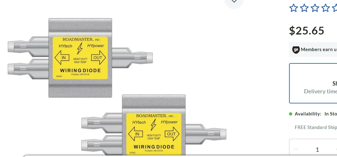

My first towed was a 1998 Honda CR-V and I used magnetic lights for the same fear about getting into the wiring. Then on my 2003 S-10, the taillight assemblies were large enough for me to add another dual-element bulb to them by cutting out a new socket hole, so I did...but I still bought a second set of taillights from Ebay "just in case." Never used though.
From then on, I started using diodes. Before I bought the ones I listed in the file, I talked with the ebay seller a few times to be sure of his product. I've had an amateir radio license for right at 60 years, and I know that diodes are really simple components.
The current can only go one way through them, and each unit has 2 diodes inside, each sending power only to the output wire. So if you have power coming from the RV through the new wires you install to the diode, that power can only come out the output wire.
When you are driving the truck, the power from the truck also only comes out the output wire. The two input wires have no electrical connection to each other. They are safe, and Roadmaster has been selling its overpriced diodes with heat sinks for several decades now. I used to use those before, but cutting and putting terminals onto the wires, just to plug into the Roadmaster diode, was a lot of work. $51.30 vs $18.50 for 4 is also a consideration.
Ford Maverick Demco Flat-Tow Setup Instructions, with comparison to Blue Ox and Roadmaster 1710693985290-1k
You have to do what is comfortable, and I certainly understand hesitancy to cut into the Maverick wiring. It is pretty easy to test a diode to make sure it is working properly by applying 12 volts to each of the input wires and then checking the output wire for the 12 volts...but no power will be found on the other input wire.
I am now far less worried about diodes, than the active shutter destruction from Roadmaster.

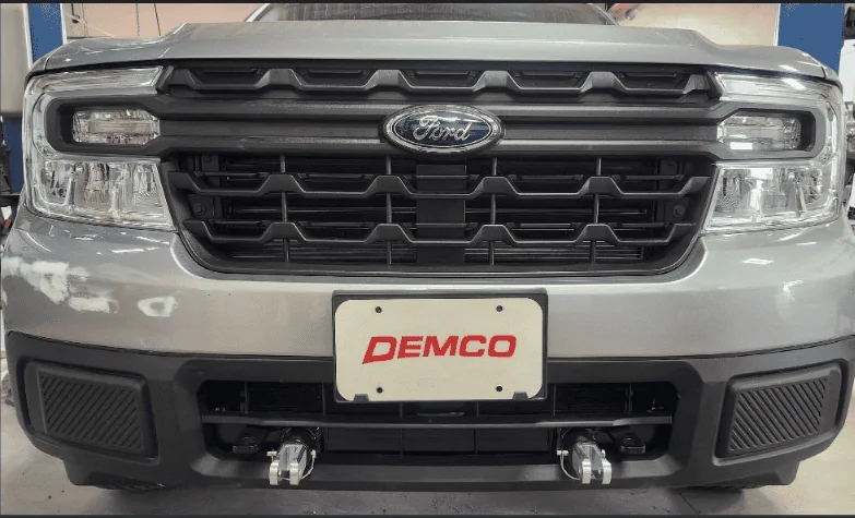

Another thank you for your fine write-up about the Demco baseplate install. Finally got mine on, and your instructions were invaluable. 2024 Lariat, and I cancelled my Roadmaster order after reading your post and got the Demco. There as a manufacturing change in February (well, they added a few washers in the top brace in an attempt to avoid the cooling vanes), but I still didn't like the clearance and removed the vanes behind the baseplate bar. Do wish the Demco folks would learn from the Roadmaster engineers about providing proper mounting points for the wiring--I don't like what I had to do to mount those in a good place.
Looks great! Congratulations, and I'm glad you found the write-up helpful.
Completely agree on the wiring location. They could do so much better. All my prior Roadmaster baseplates were easy electric installs on other vehicles.
I noticed on Demco's test vehicle picture, they completely left off ANY electric connection.
