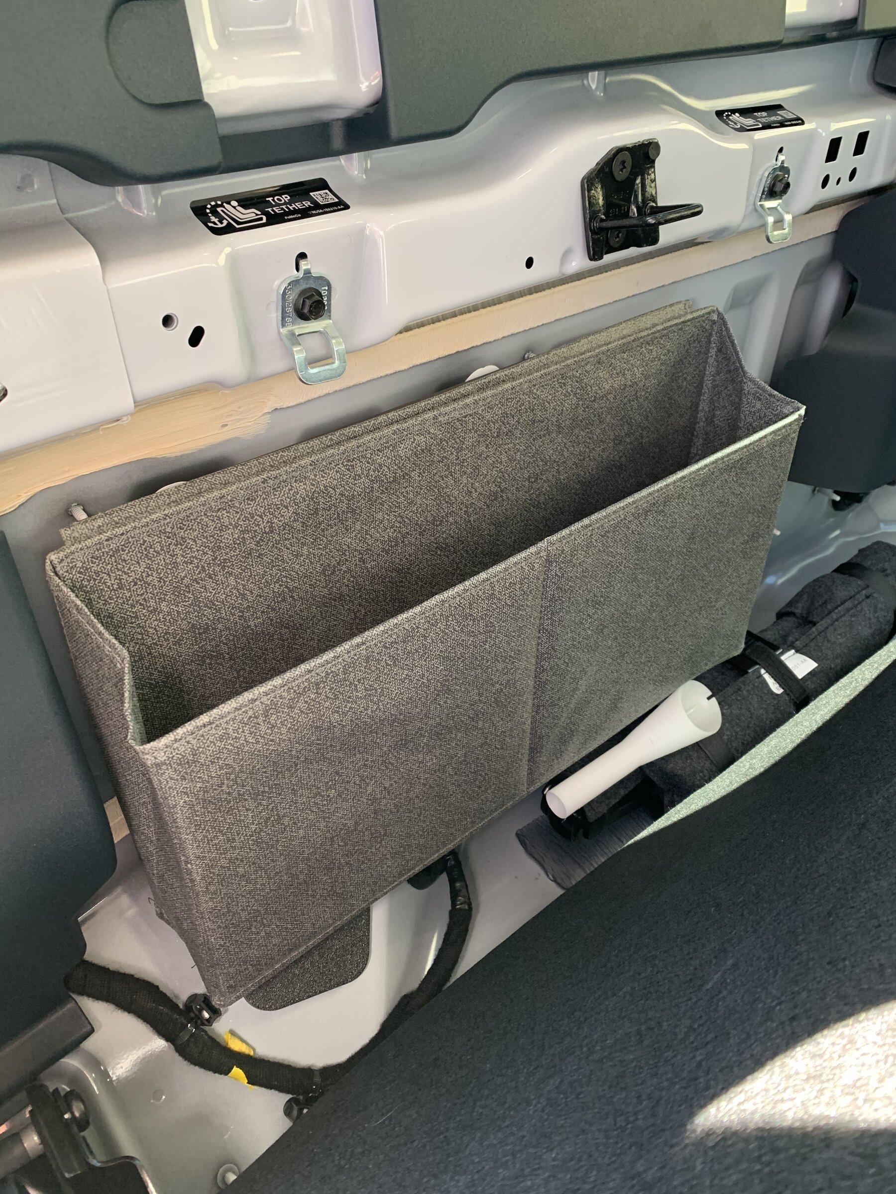

Anyone have a picture of the fuel funnel? I took my jack out and it wasn’t there where it should be.
edit: Found it in a box of stuff they gave me. I guess it was getting loose behind there. I put in the bed cubby hole.
I clipped the fuel funnel to the strap around the jack tools (see picture). I added the bag to hold jumper cables, first aid kit, tow strap, etc.

I like the bag idea. Mind telling me (us) where you found it?

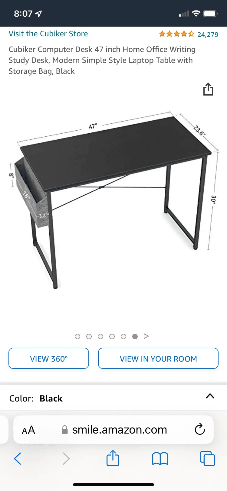

It came from a Cubiker office desk my work got on Amazon(picture attached) We didn’t use the bag, so in my truck it went. Probably can contact Cubiker and just get the bag.
