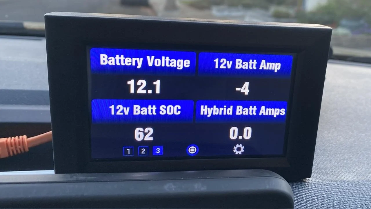

First thing this morning
I drove the truck ~90 to 100 minutes yesterday. Nothing audible or visual is on except this scanner (which was disconnected all night).
The act of plugging in the scanner "wakes up" the truck's computers if not already awake. These "unspecified computers" apparently draw 4 amps while the truck is parked, no key in the ignition. All accessories off.
