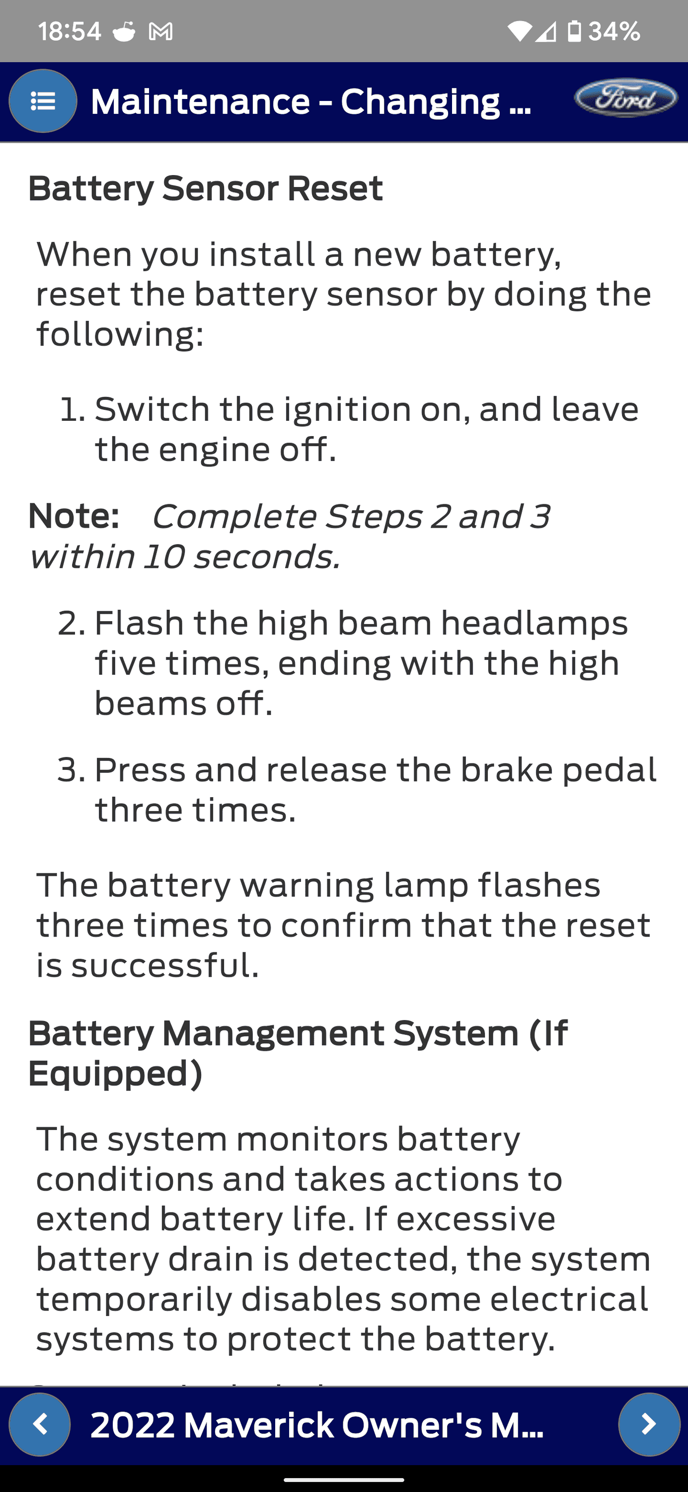

Reset my BMS last week after Hybrid Wiring Harness replacement, no Deep Sleep since.
I hope other people can confirm this before I go home and try lol
