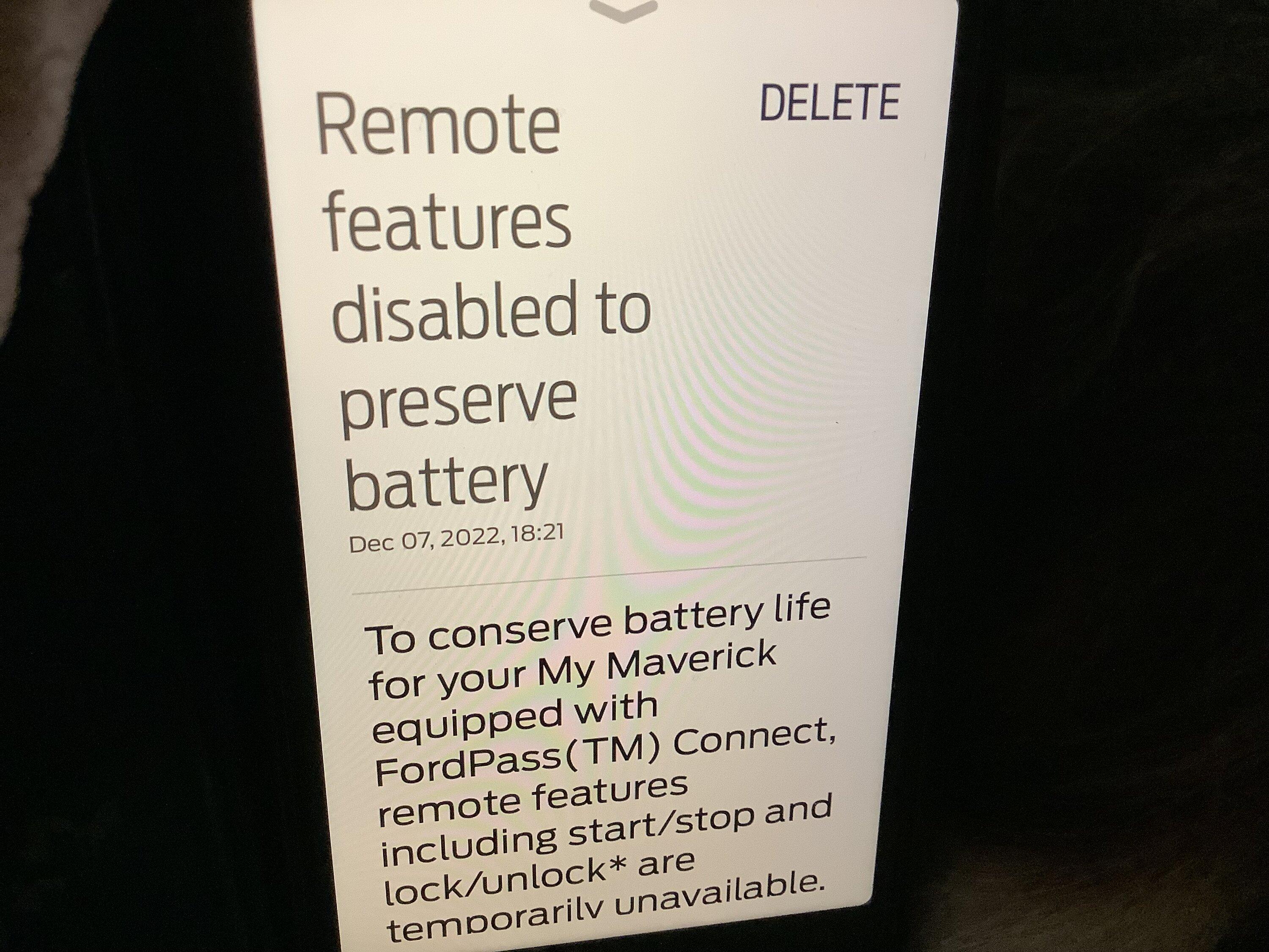

I receive that message with no issues. No performance issues, no starting issues, just informs me it is going into Deep Sleep Mode. So far, So good.
Same here, except you can't remote start with the Ford pass app.
I'll go a month or two without any messages and then 5 days in a row like right now with the deep sleep message.

Just brought mine home from the dealer today. Drove it home and got the "deep sleep" alert. 😑
