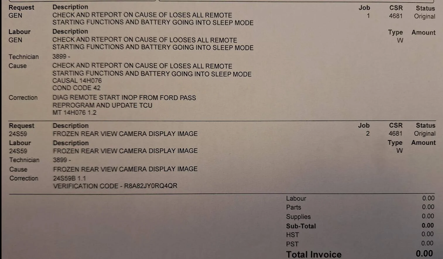

I took my '23 XLT Hybrid to the local Ford dealer for the 'Rear View Camera' recall and mentioned the deep-sleep concern as well. They apparently applied a 'fix'. "Reprogram and update the TCU". Here's the work order:
Ford Maverick Dead Battery fix in 1st Quarter by Ford not solved yet. 1744045882265-76
I haven't lost dome lights or received deep sleep messages since (but did 3x the week before the 'fix'). No idea if the 'fix' just tells the truck not to react to a nearly-dead battery anymore, or if it actually corrects the battery charging/management scheme.
Since the TCU is merely the Tele Communications Unit and not where the Battery Management System functions - no scheme change.
14H076 is part of the part number.
Unless you were getting battery drains overnight, the TCU is probably operating exactly the same as it was, since no updates to it have been a part of any recalls in the past, specifically mentioned, maybe it was updated along with another main module in the past. Wondering if they merely reset it, and then had to reprogram the settings so it would talk to your account again for Fordpass to work.
What probably did happen doing a module reprogram and ACM update for camera - battery charged up.
Give it a month.
Give it a month.
Agree. Not holding my breath.
