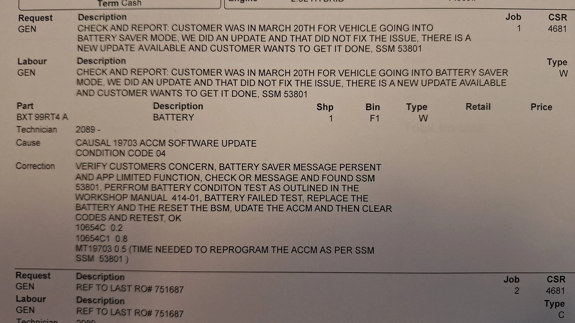

Sure enough, it took two months, but the deep-sleep thing hit again. But this time, and thanks to jeffrol48197's post here, I was able to return to the dealer with a tangible / final fix. They 'tested' and sure enough, battery was junk and the applied the SSM-53801. $0.

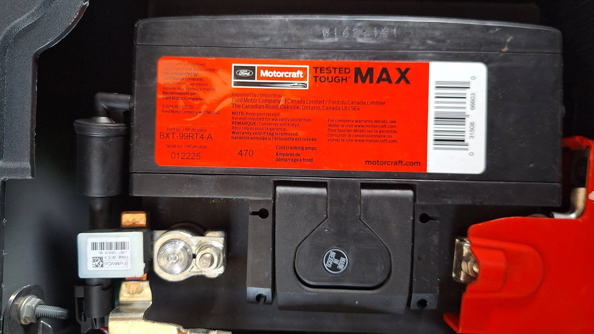

And here is the new battery they installed, just fyi. Same as the original:
Good news.
Too bad they didn't show the results of the battery test, trying to compile in my memory (probably not the best place) how many of these need to report below 40% to be considered bad, and is that SOC or SOH?
That's not a bigger version of what you had already?
I'm still on the 390 one. Nice if you already had bigger one.
Anyway - what dealer tech's don't have time for that you need to make sure you do, from the manual.
Let it sit overnight locked for the BMS relearn process.
