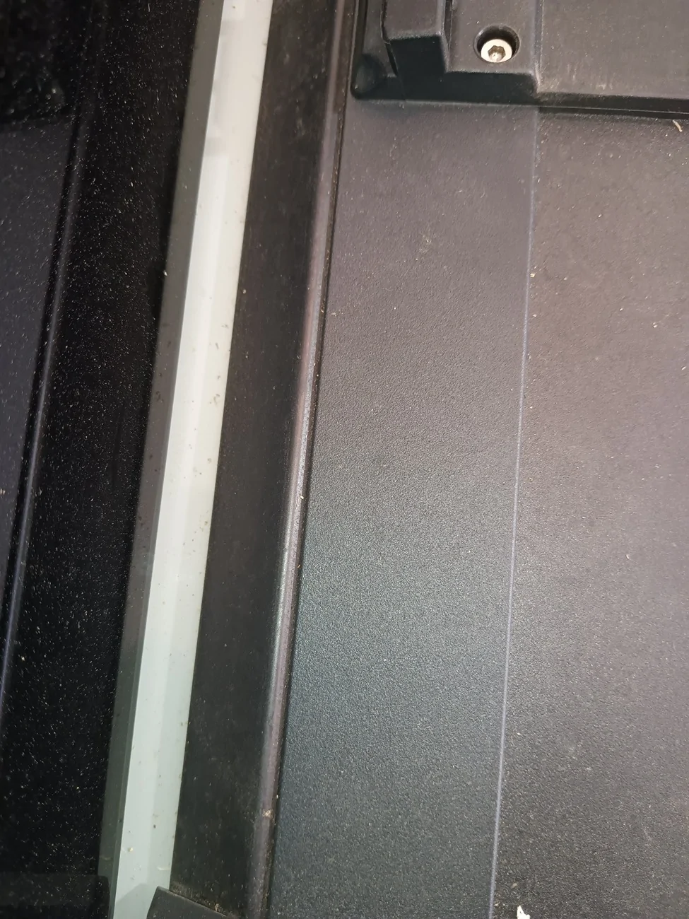

Mine doesn't leak. I used the foam block as instructed and seal the end of hold down rail and the black sticky tape sent with top to even out the weld seals. Put weight on the fixed section (100+ lbs) to compress the bulkhead seal and reduce needed number of nut turns with wrench. Never had leakage in front of bed. See attached pic.
Ford Maverick Crazy good deal on this Lear quad fold bed cover IMG_20260725_102826
