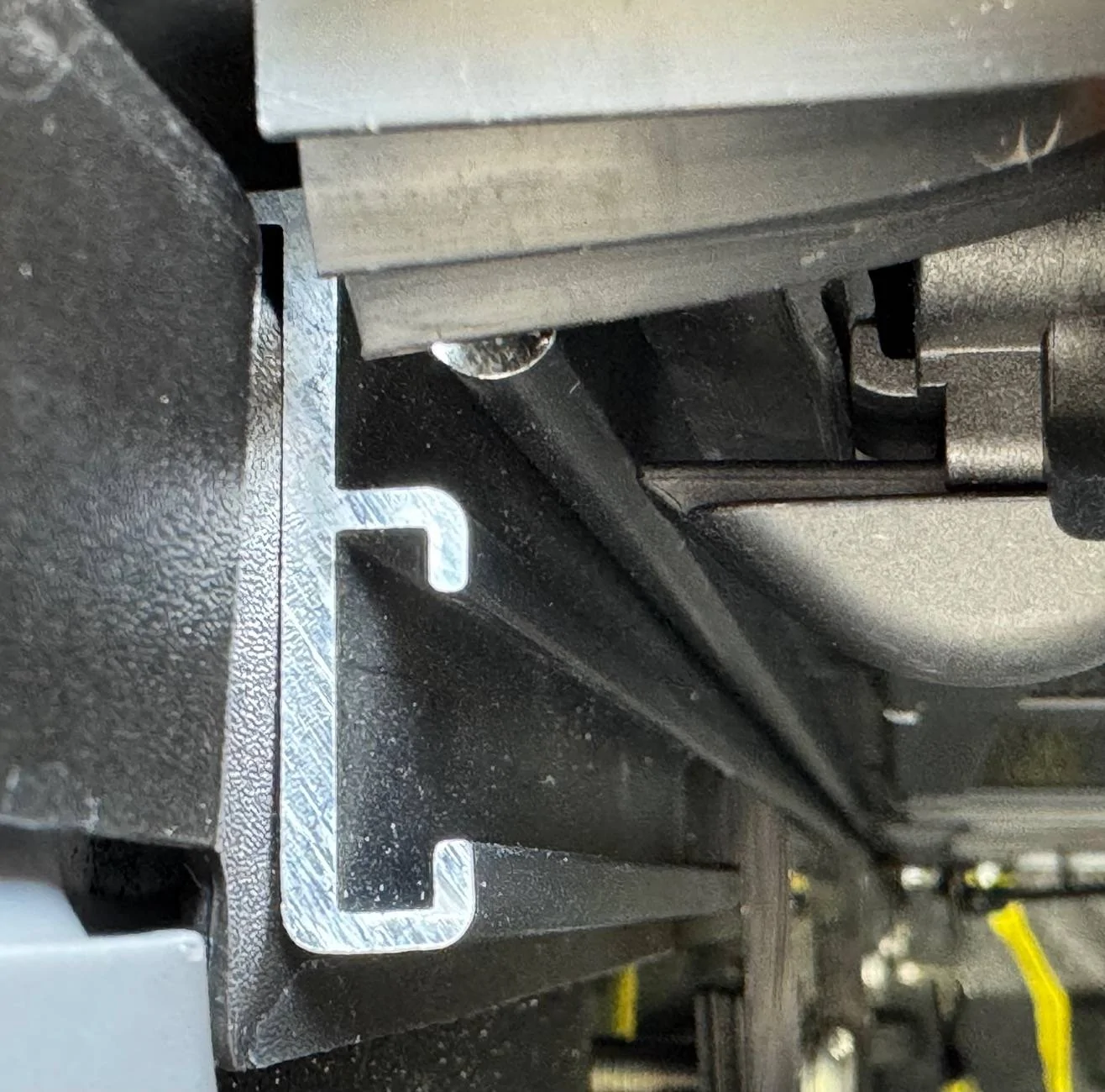

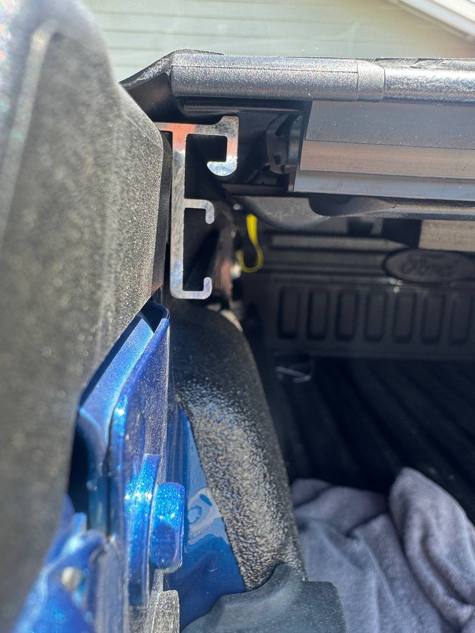

Thanks @Rcrew . None of the latches engage so I slightly adjusted it so that at least one of the rear ones engage. From your picture, it looks like the rail does not sit flush against the black plastic cap on the bed. Did you use a spacer? How did you get it to stay square?
Mine is currently installed flush (see attached), but that the top of the rail really needs to move inwards more.
Here are a couple pics & video. Occurs to me more information would be to measure the width of my latches end to end, and other measurements. Will do after my class.
No spacers on my rails, pic should show flush.

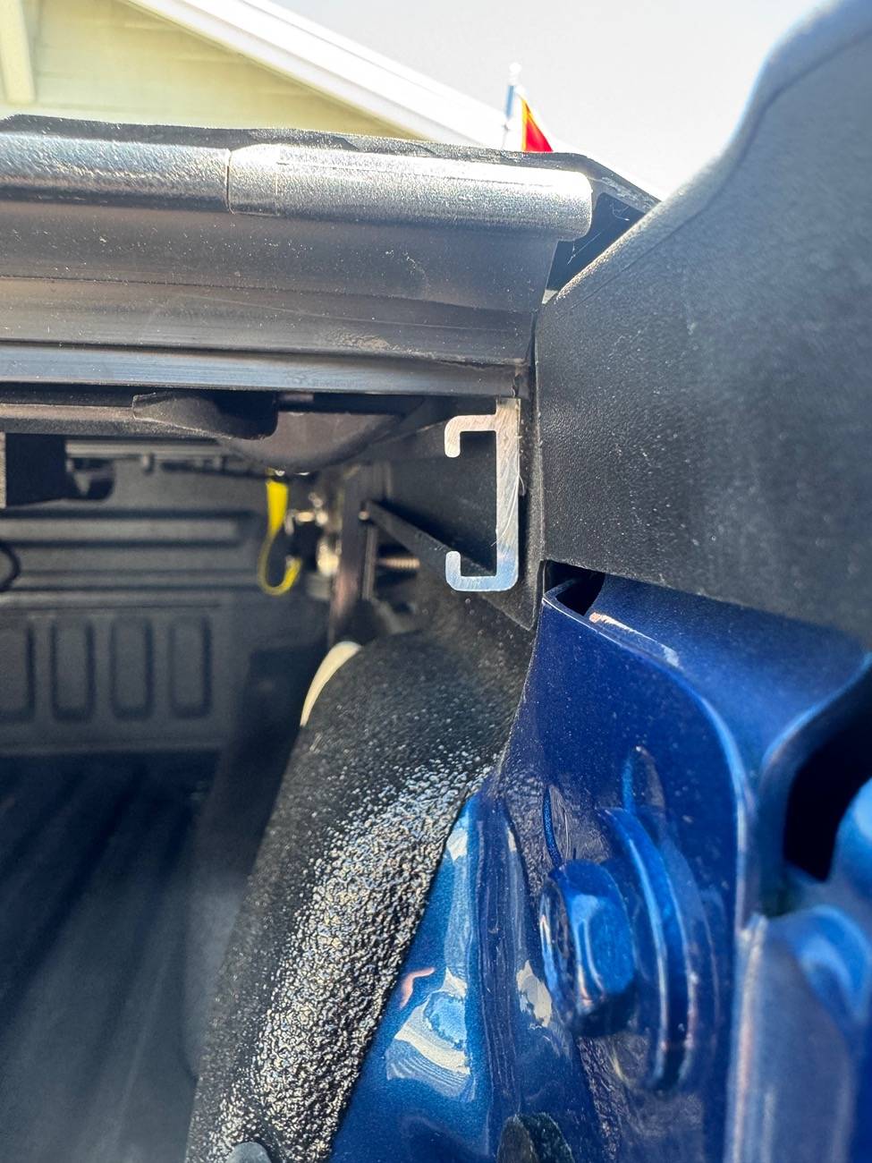

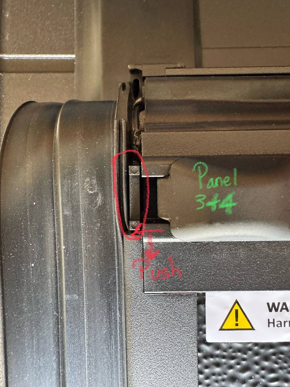

Thanks. That looks like mine too. In that case I need to push the latches outwards more so that they engage the rails. What I did was loosen the latch mechanism and push it out for panels 3 and 4. This allowed the latches to now engage but at the loss of some structural support if someone tries to pry under the cover at those points. Probably not a big deal in reality. I made this adjustment on both sides.
Ford Maverick Leer HF650M Quad-Fold Tonneau Cover - Install and First Impressions IMG_7387

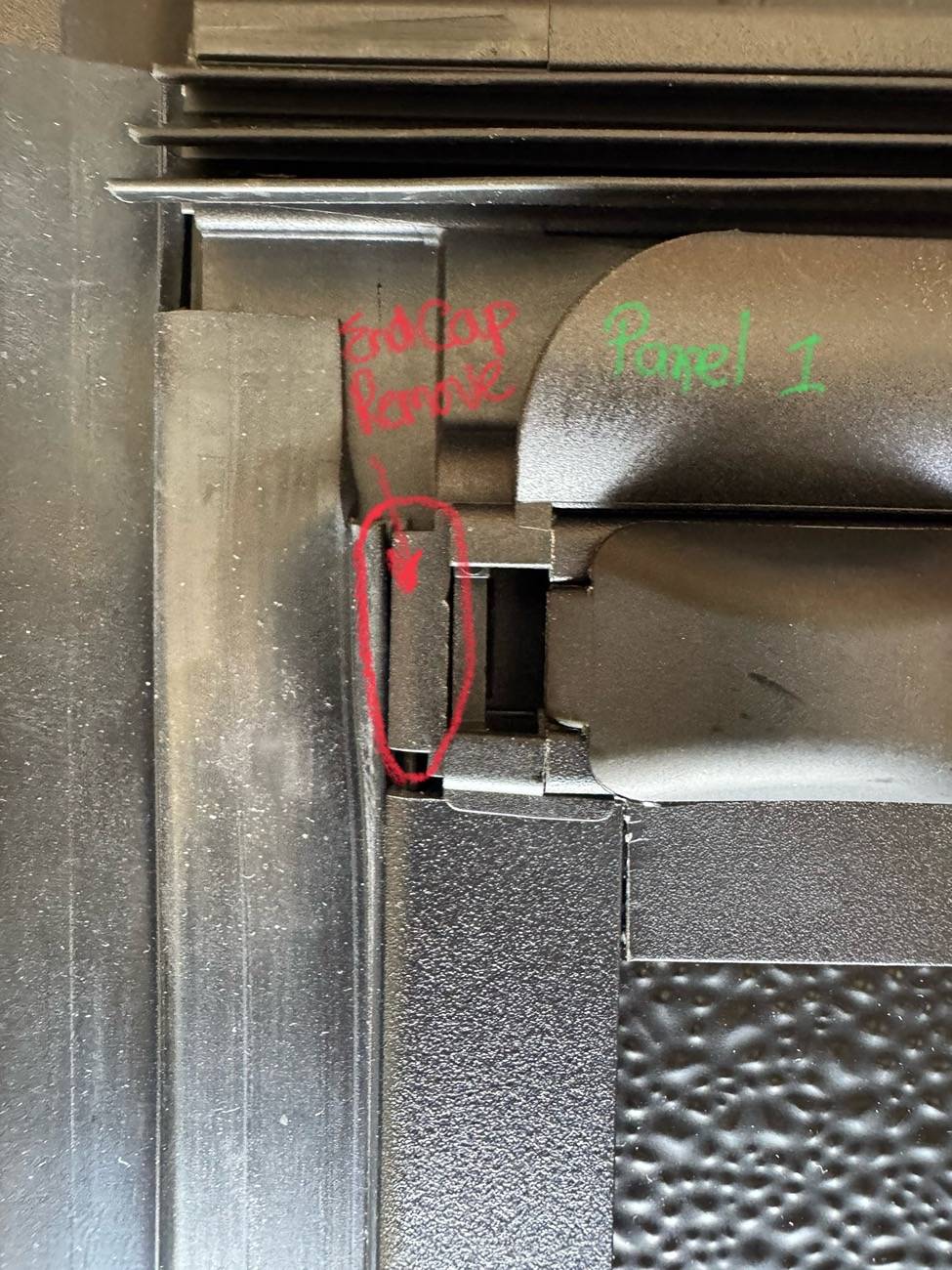

Panel 1 at the tailgate was also a problem but here there is a cap stopping the
latch mechanism from sliding out all the way. I had to cut away the end cap to allow me to slide the latch mechanism further out so I could make the adjustments like the other panels. All latches now engage but it’s a shame that I had to do this.
Ford Maverick Leer HF650M Quad-Fold Tonneau Cover - Install and First Impressions IMG_7386

Thanks for the measurement! Mine are
Between the rails: 51 11/16”
Locks tip to tip AFTER adjusting: 52”
This means my original tip to tip length would have been about the same as the rail to rail measurement which is why the latches were not engaging. They were thus basically fitting just between the rails and not sliding under them. Seems the panel support members which hold the latches may have been cut too short.

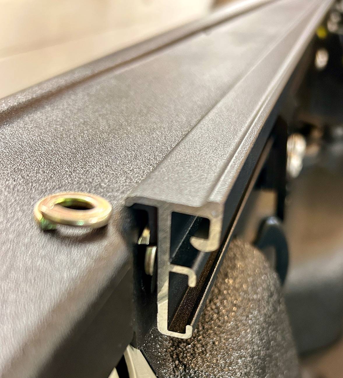

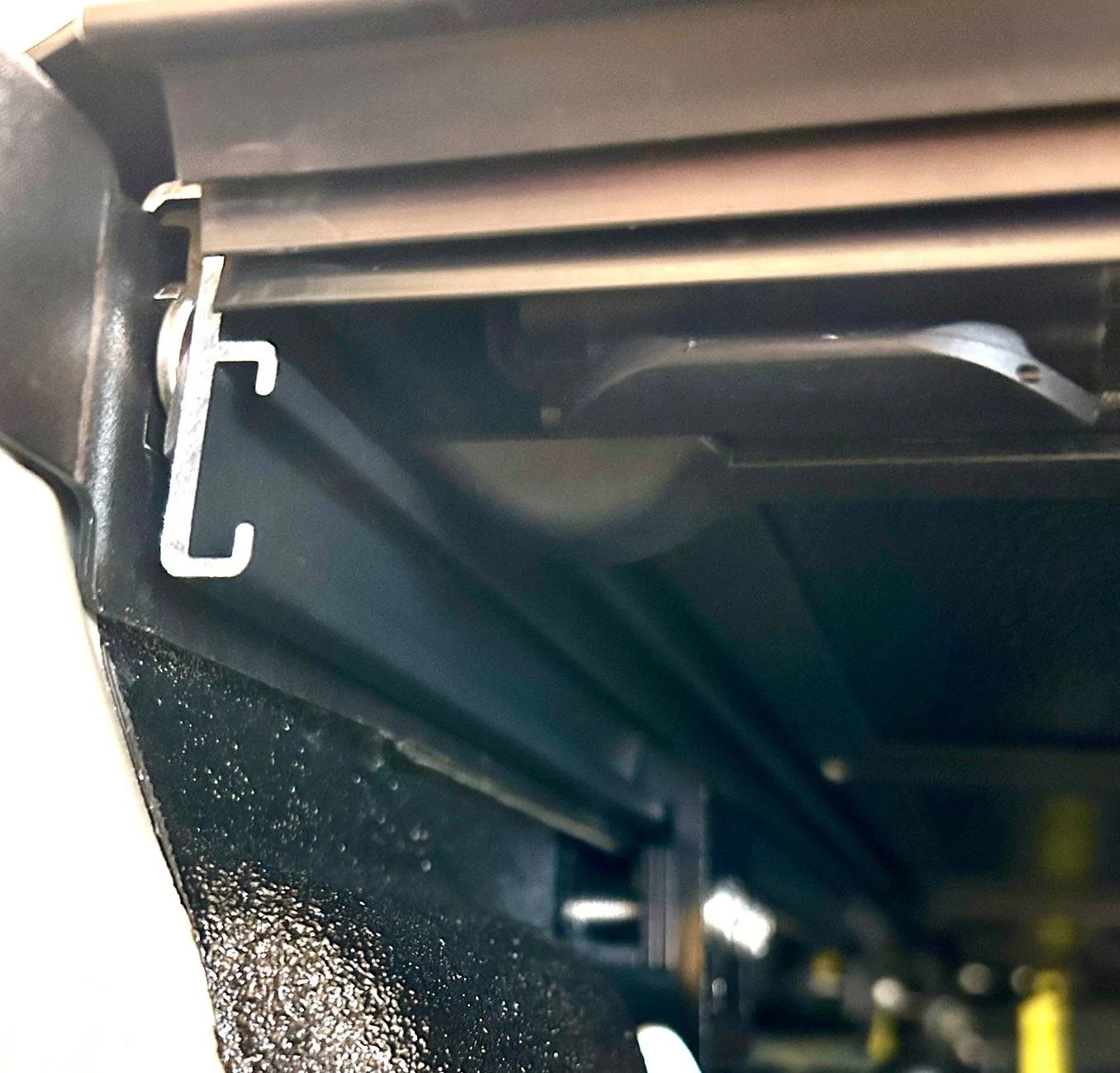

At first one side didn’t latch but I just had to square mine up, but even squared up I went back and looked o and as others have said, there really is very little for the latch to bite on.
I came up with a quick fix…
I loosened the rearmost bracket, the gently pulled out on the rail and slipped in a small locking washer behind it to shim the end of the rail more into the bed. Did it on both sides, then tightened it all backup. Made sure the top was square ( just grab the rear edge with 2 hands and tug ) and now both sides have more bite. Easy fix, but I the it’s a shame it is needed. See pics below…
Ford Maverick Leer HF650M Quad-Fold Tonneau Cover - Install and First Impressions IMG_0345
Ford Maverick Leer HF650M Quad-Fold Tonneau Cover - Install and First Impressions IMG_0347
