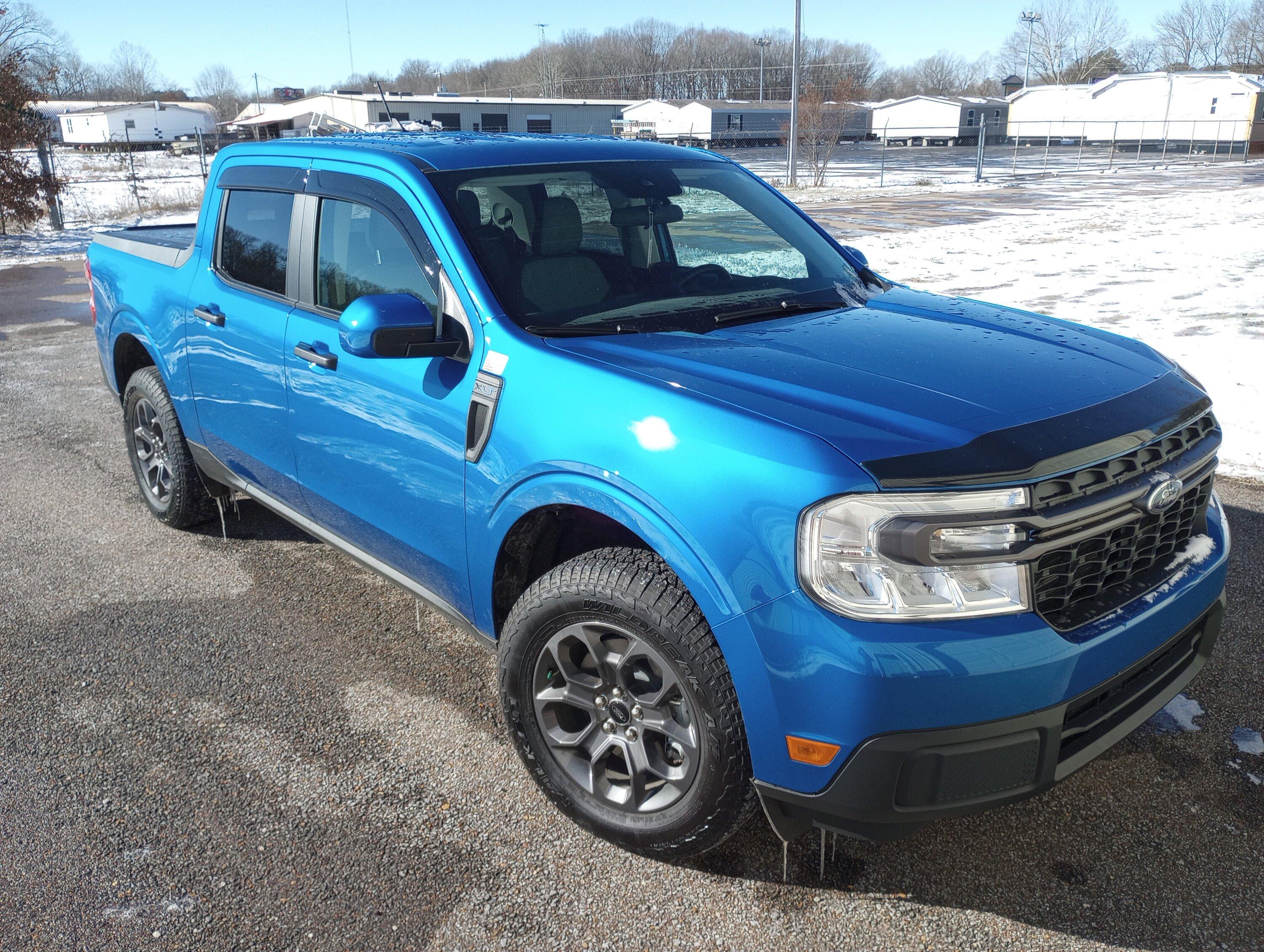

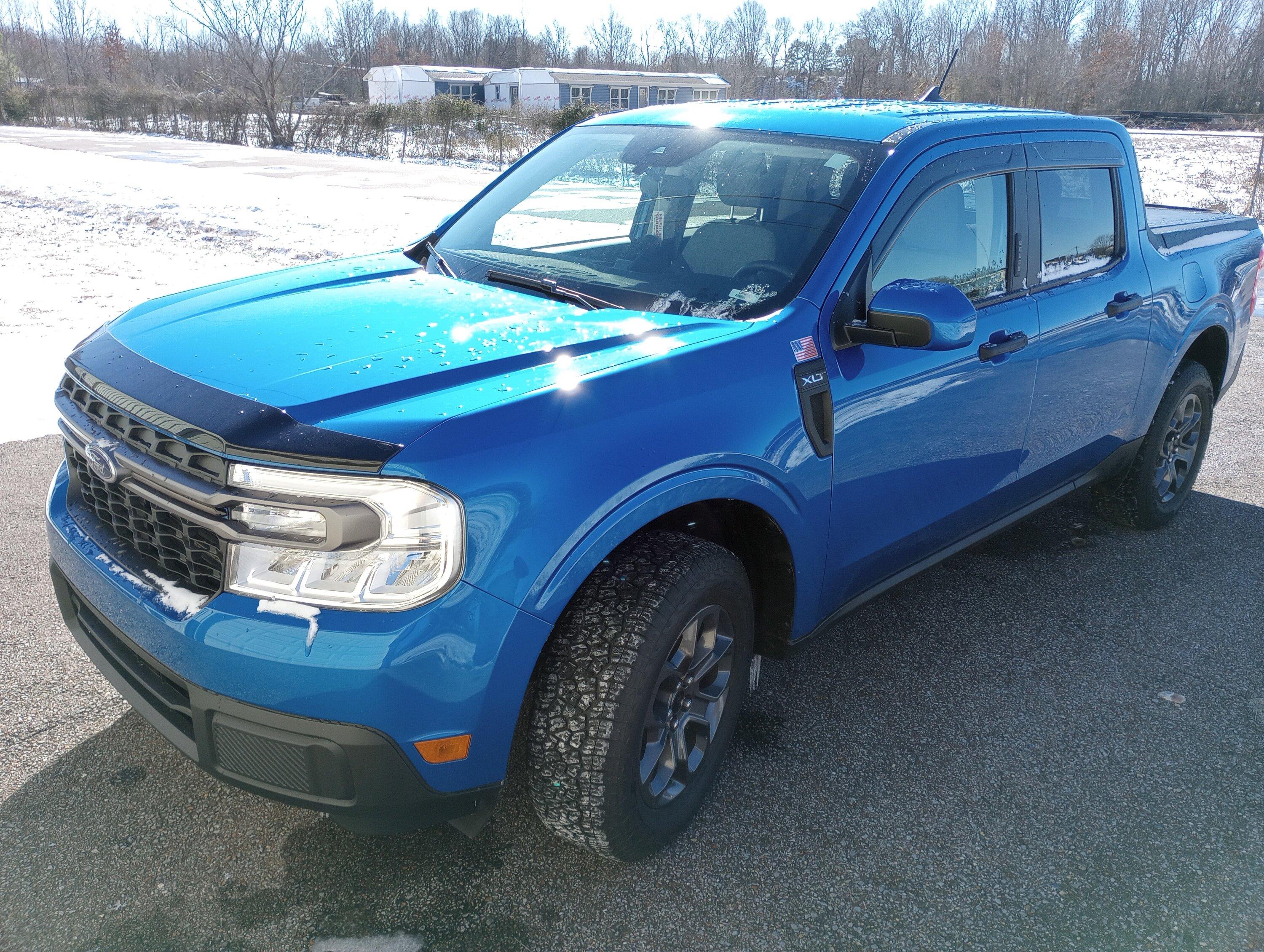

I have a 22 XLT hybrid 6 months old. I live on the border and West Tennessee and Kentucky. Right before it after Christmas we have that polar vortex come down on us actual temperature was -8 wind chill was -20. Truck was left outside for 4 days was nothing but one blue ice cube. Remote started with the key fob a couple times ( Damn shame that Ford is Doing away with the remote start on the key fob shame on you Ford especially for us people that live in the cold weather areas 👎☹🥶). Sorry got on my bully pulpit. It started up both times no problem on the second time the inside was warm enough to melt the ice on the south facing door so I can go ahead and get in it and turn everything up on high and defrosted my Maverick. Went to the store to get my daughter and us for a couple groceries drove around two wrecks on ice it's still on a small hundred foot Hill with a banking to the left on our property a trash truck slid into our trees but my Maverick right around the truck the cones and on the side of the road and never lost an inch of traction. So long story short I have had no problems at all with the battery cold nor traction on ice and snow with front wheel drive Only .🙂👍🥶❄👻

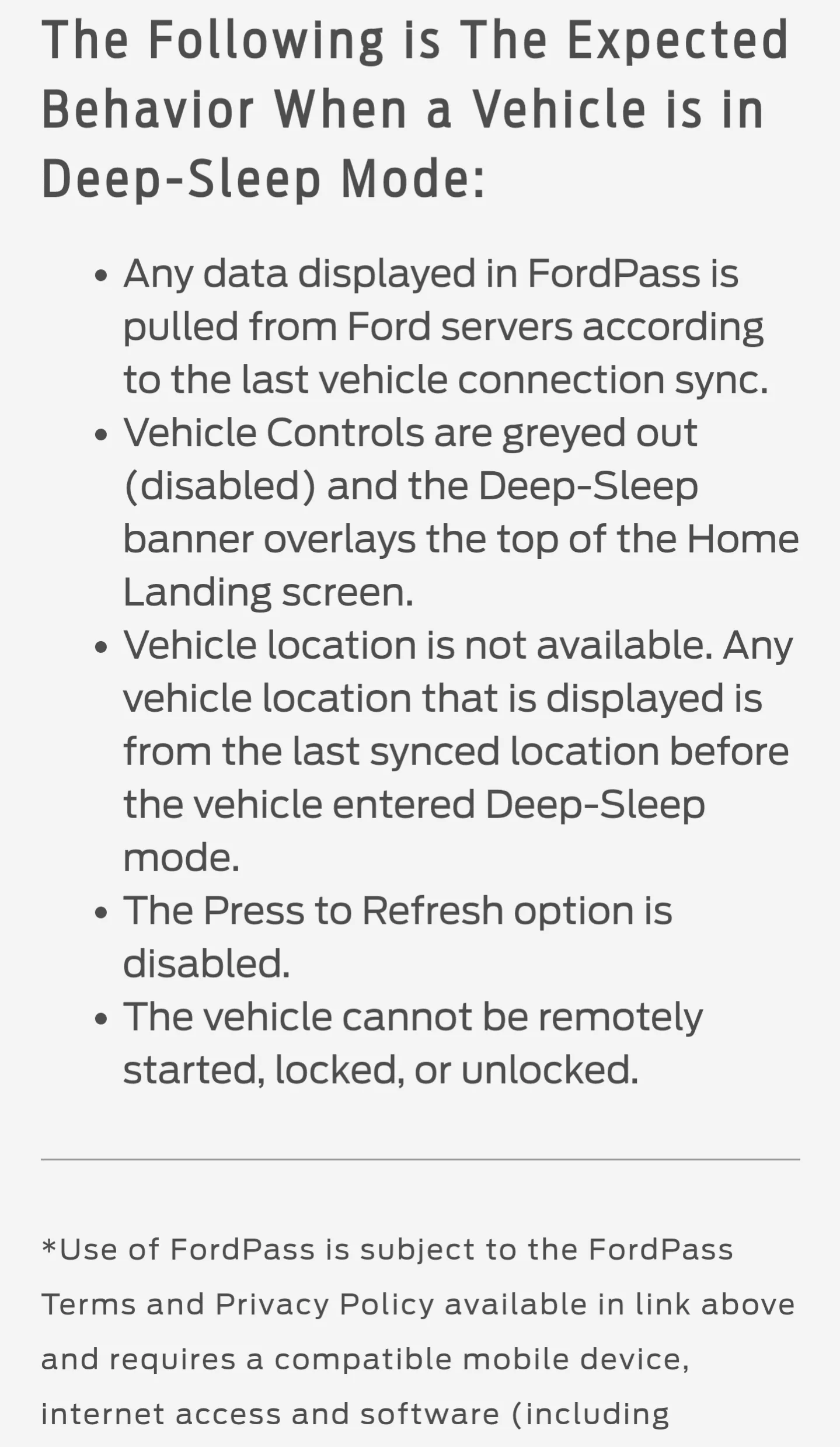

Seems like conflicting information. Read the last sentence on that page.
"The vehicle cannot be remotely started, locked, or unlocked."
I think that statement meant that Normally the remote start can start your engine but you have to push the button or turn the key to put it in drive.
I'll have to try it again next the next time it goes into deep sleep, tomorrow, lol.
It's not conflicting.
Deep Sleep Mode relates to FordPass connected features.
The vehicle continues to listen for commands from the key fob. Following your logic, you couldn't even unlock it with the fob in Deep Sleep, but nobody has made that complaint yet.
That page is telling you that FordPass remote features are unavailable, but you can access and even remote start the vehicle manually with the key.
However, to leave Deep Sleep mode, you'll need to go into the vehicle and start it, not just a remote start.

It can't be remotely started, locked, or unlocked via the app when in deep sleep. I can attest that via key fob still works normally.
