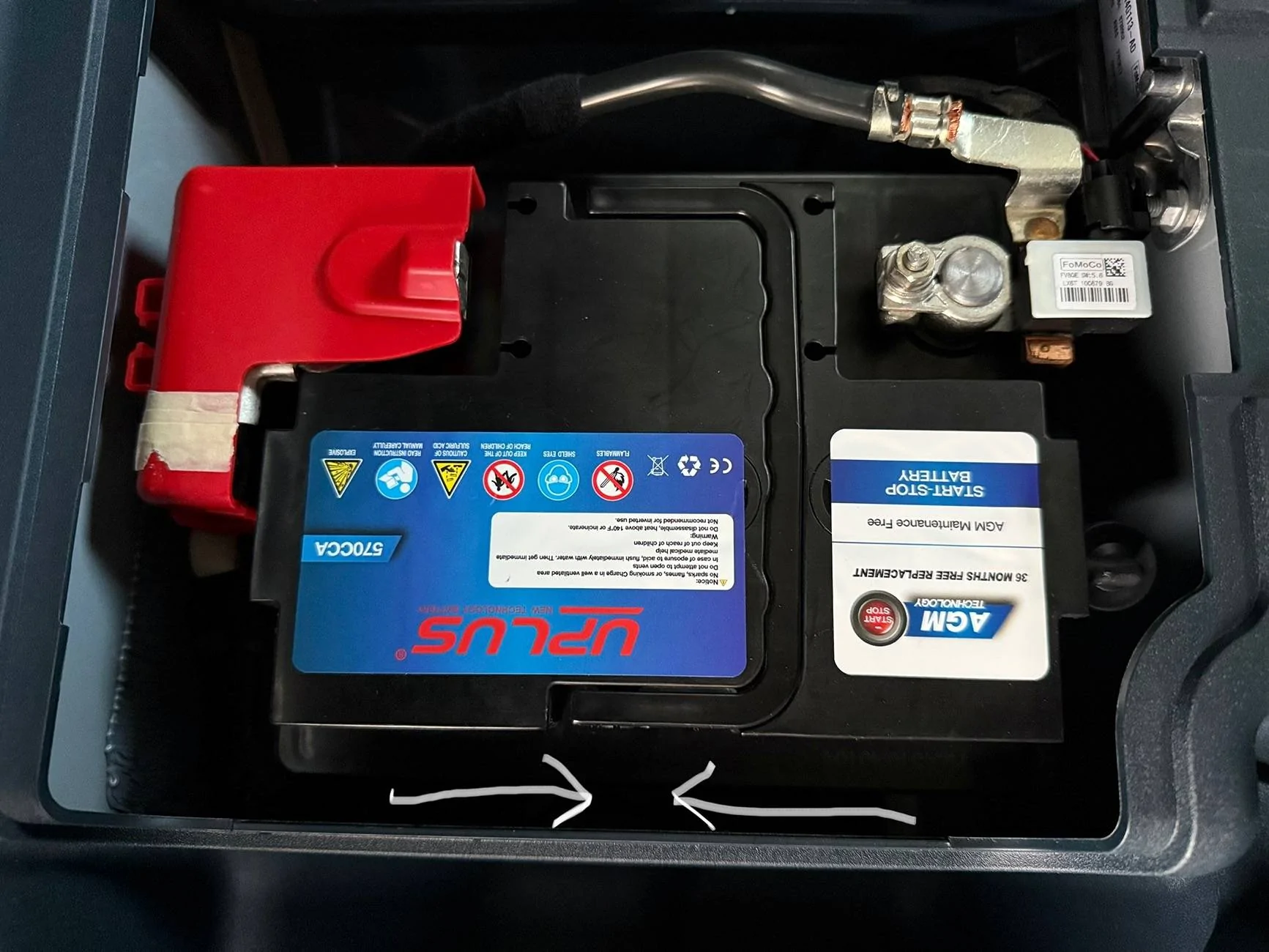

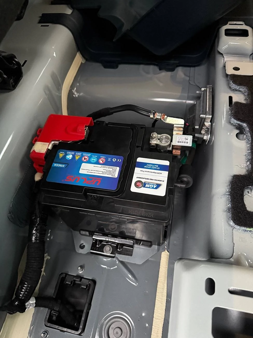

Thanks for the suggestion and the link. Got it for $112 last week. Dropped it in this morning. Couldn’t be any easier. Hopefully bye bye to the “battery saver“ mode and I can actually use my FordPass app to start my Mav when it’s freezing out.

Did you have to remove to remove the plastic cover?
To me, it was the best way. Whether you can get to the bolt on the bracket that holds the battery down with an extension and then be able to loosen it up and get the battery out followed by getting the new battery in and under that bracket was not even given a second thought. Just pop out the plastic and make my life easier.
It’s obviously much easier without the plastic trim but, you do risk breaking the snap points on the trim if you’re not extra careful. I wasn’t willing to take the risk and found it easier than expected to replace the battery with the trim in place particularly if you are using an LN1/140r/H4 replacement battery. I would strongly suggest you use a magnetic socket and a 12 inch extension to address the hold down. I also used a simple Dow rod to push the hold down plate in place to tighten down. I took my time and finished in about 30 minutes. The biggest PITA was the positive terminal cover which had masking tape wrapped around part of it. Removed the masking tape and it was much easier to manipulate back in place. Not sure why it needed masking tape to begin with. The UPLUS H4/ Group 140R AGM battery is a real good choice. I installed the AC Delco LN1 AGM.

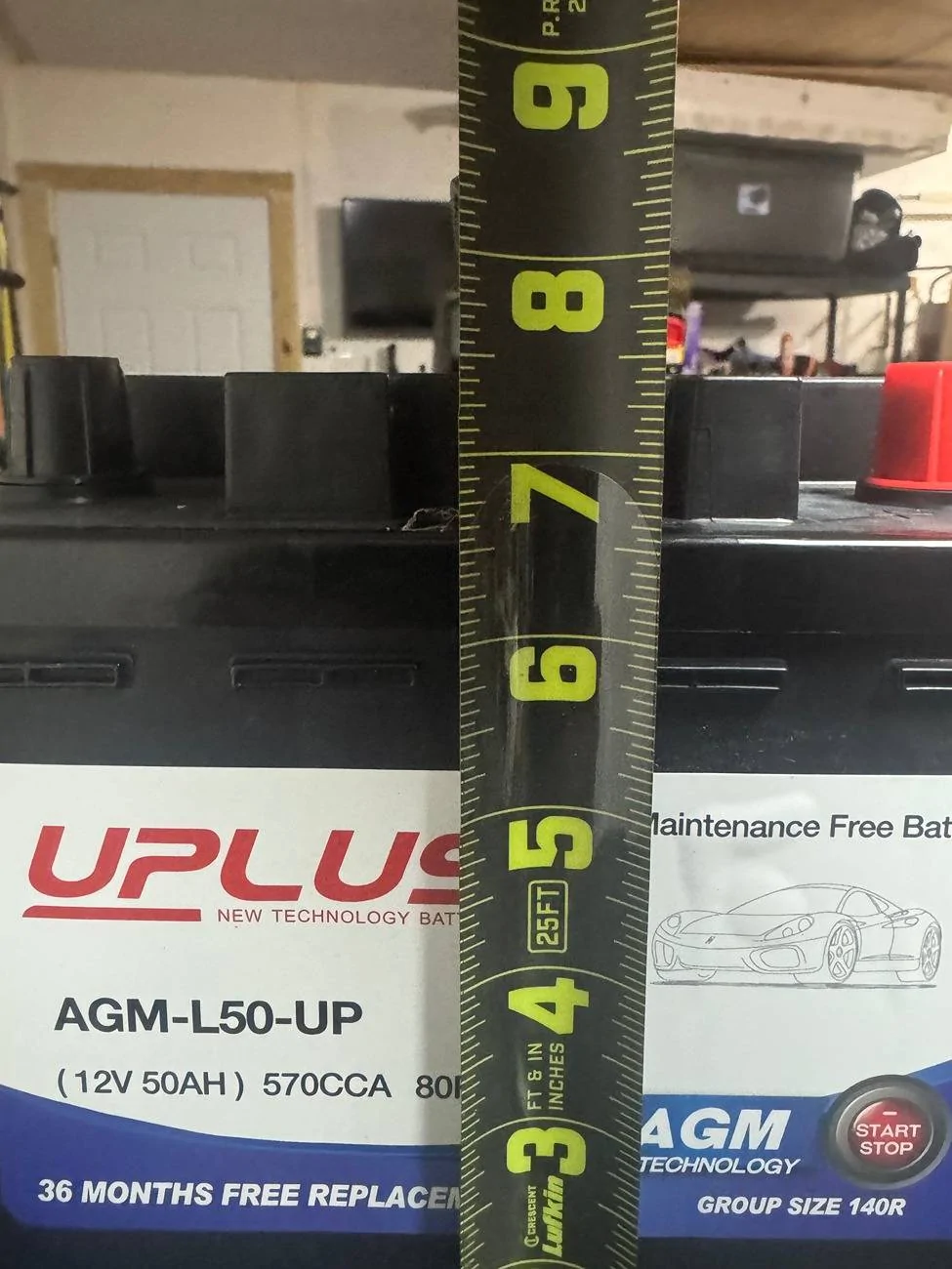

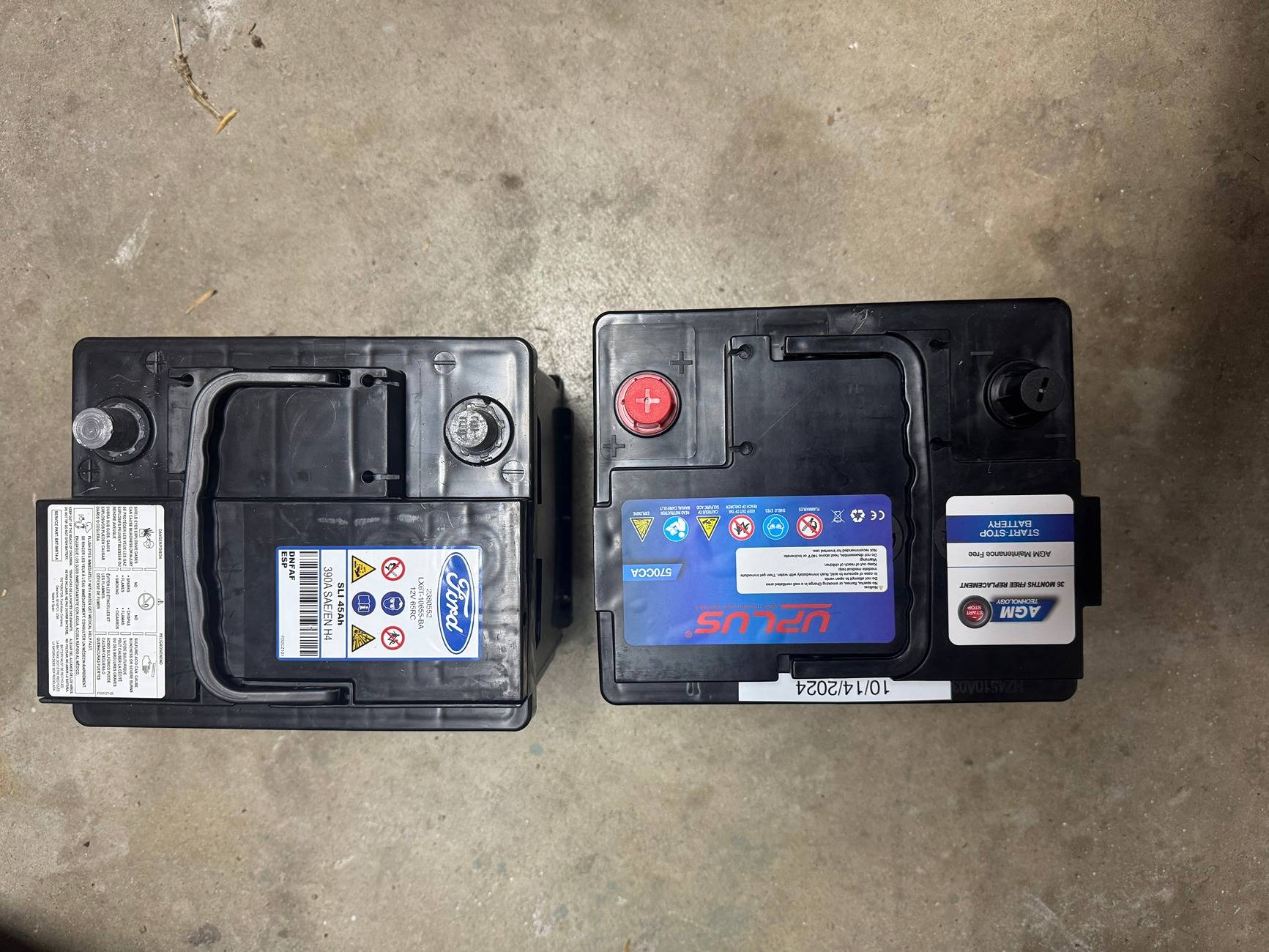

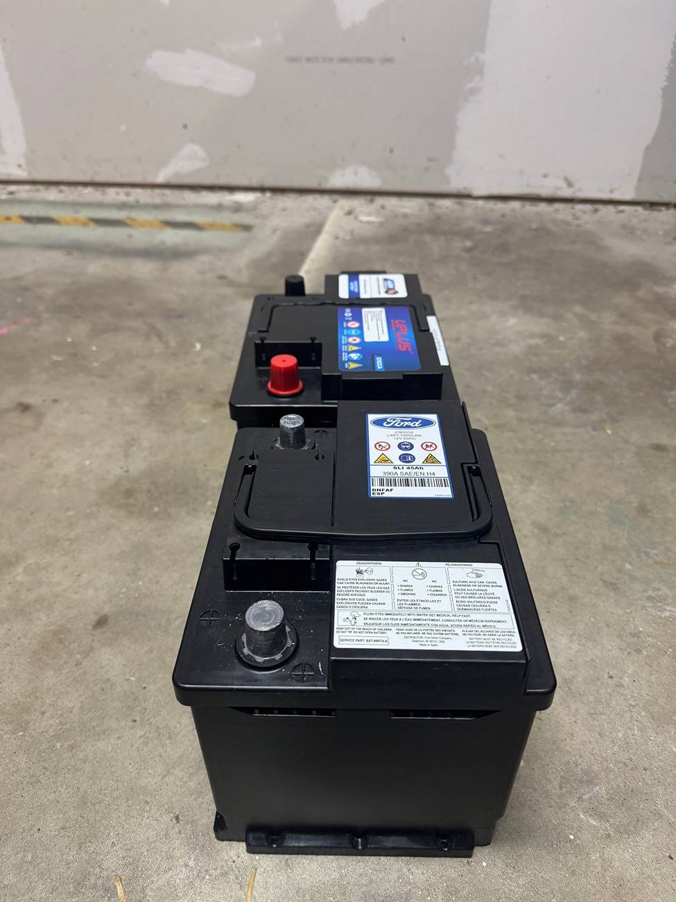

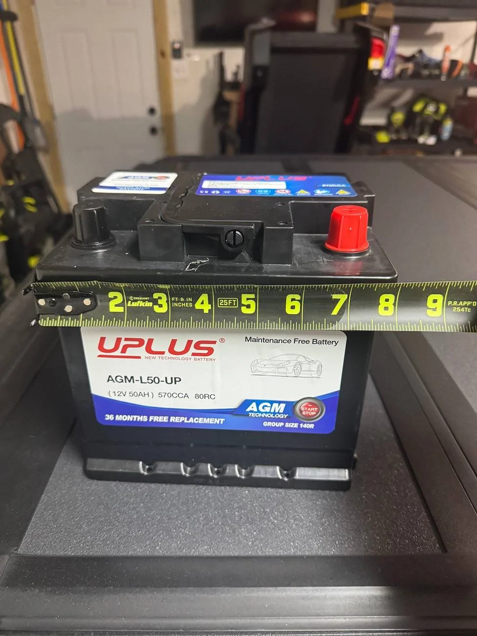

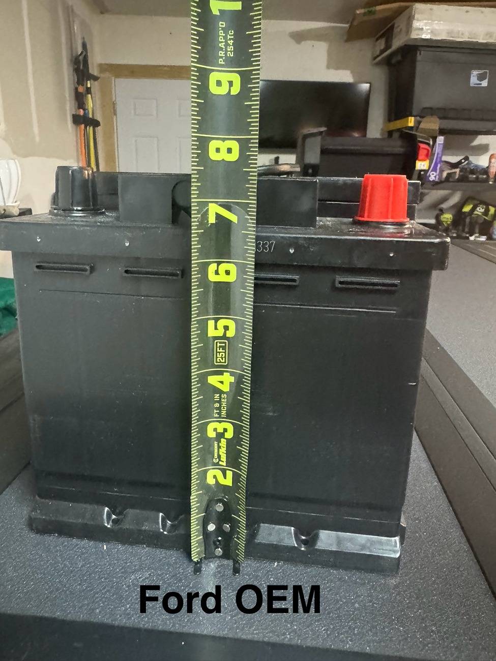

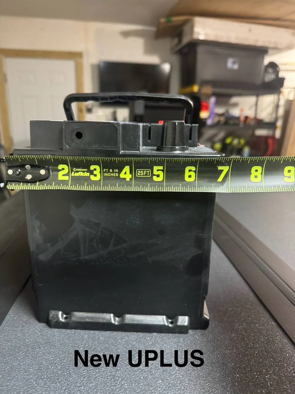

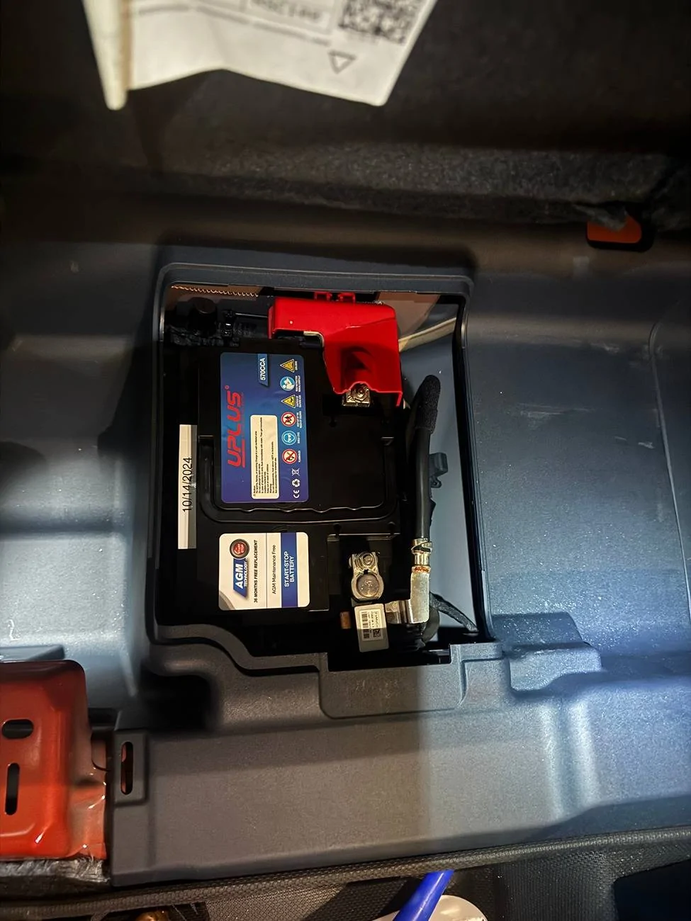

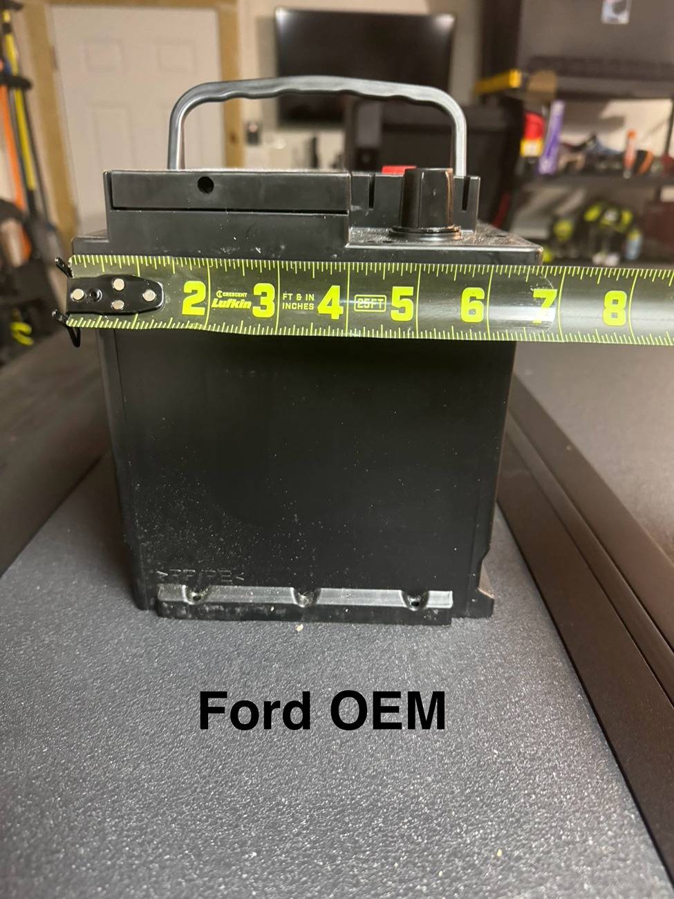

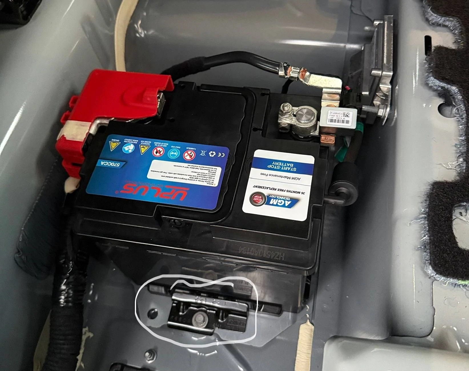

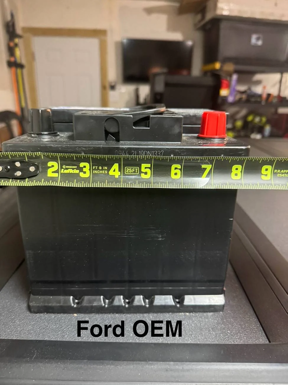

Thanks to everyone that recommended the UPLUS, I was able to snag it on Amazon for $111.
Of course PITA to install, I did a mix, I loosened the plastic trim but didn't fully remove it, to get enough space to fit my fat fingers in to replace the clamp.
Fit perfectly, zero fitment issues. Attached are a few dimension pictures for anyone on the fence.

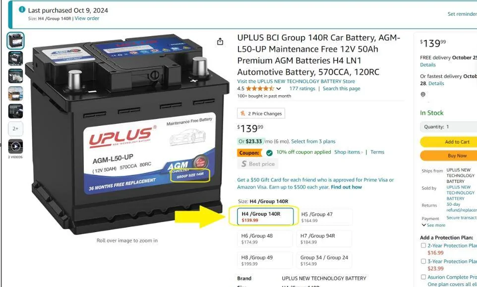

Does this battery -
AGM-L50-UP
fit in the 2024 Hybrid Maverick ?
Amazon shows me "Does not fit 2024 Ford Maverick"
I didn’t have any problems removing the plastic and I wasn’t extra careful. I just pulled up at every attachment point and everything popped out. Less than 5 minutes to pop out the 2 plastic panels to give wide open access to the battery and make the swap super easy.

No site is going to show the valid alternate sizes as fitting the Maverick.
Because only the R99 / T4 is listed as OEM.
As far as that size whatever it is - why deal with a size that isn't drop in ready that may require some sort of mod's to fit?
Did you see the list of valid sizes in several posts?
