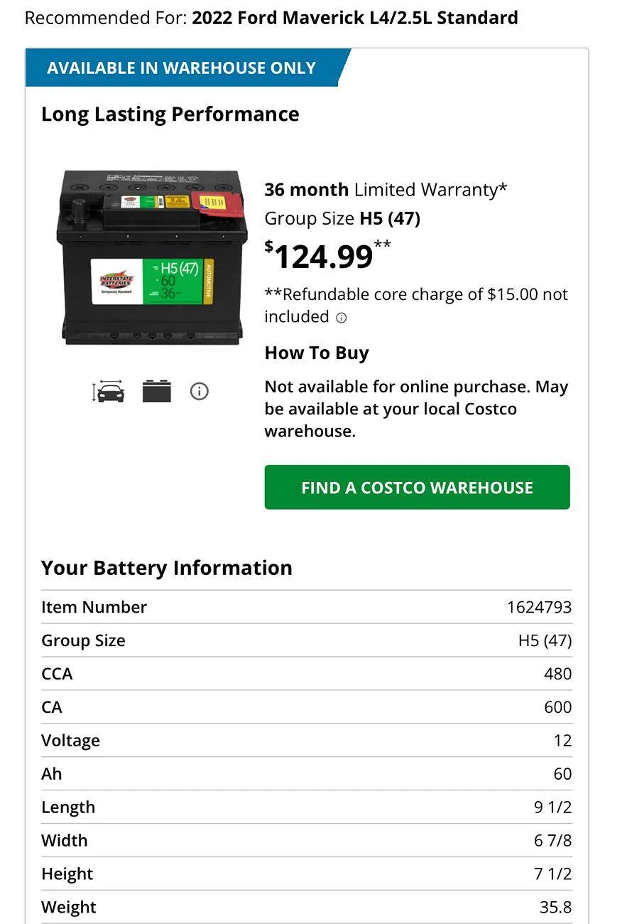

FYI : I was at Costco today exchanging a battery out of my 2010 Ford Taurus and I asked them if they had an AGM battery for a 2022 Ford Maverick hybrid. His first question was, you need a battery already? I kept the story short and he looked it up and said yes and I wanna say he said about $160.00 but when I looked for at the Costco site it was for 124.99
The battery you posted is an H5. The “drop in” battery size for the Mav is H4. The H4 is about 8” in length, the one you posted is 9.5”. It may take some mods and you will definitely have to pull and reinstall the trim to get the H5 battery in. The H4 I got could be put in without removing the trim or needing any mods.

Also, I do not think the Costco is an AGM

Crap, you're right! The Costco guy gave me the part number and I wrote it down on my battery receipt. I will post the part number tomorrow evening....stay tuned for more details

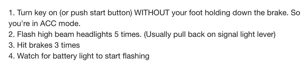

I put in an LN1 AGM after optimizing it with
My Genius 5 then resetting BMS and letting it rest for 8+ hours. Never looked back. Consistently rests at 12.6v to 12.8v and charges at 14.6v to 14.8v as I drive. Two months in and no deep sleep issues. What came out of Mav was a 390 CCA POS …. It was only slightly better than the 350 CCA battery in my JD LX 280 garden tractor!!! I can’t believe Ford would install a “play” battery in good conscience. What did they think was going to happen ??????
How are you resetting BMS? This is way more than I wanted to know for a new truck!
Great - so now they have the wrong size tagged as being an option.
Not drop-in ready, will require mods to fit.
Wonder what database they got their info from.
H4 is the size, or group 140R - for drop in ready exact match.
