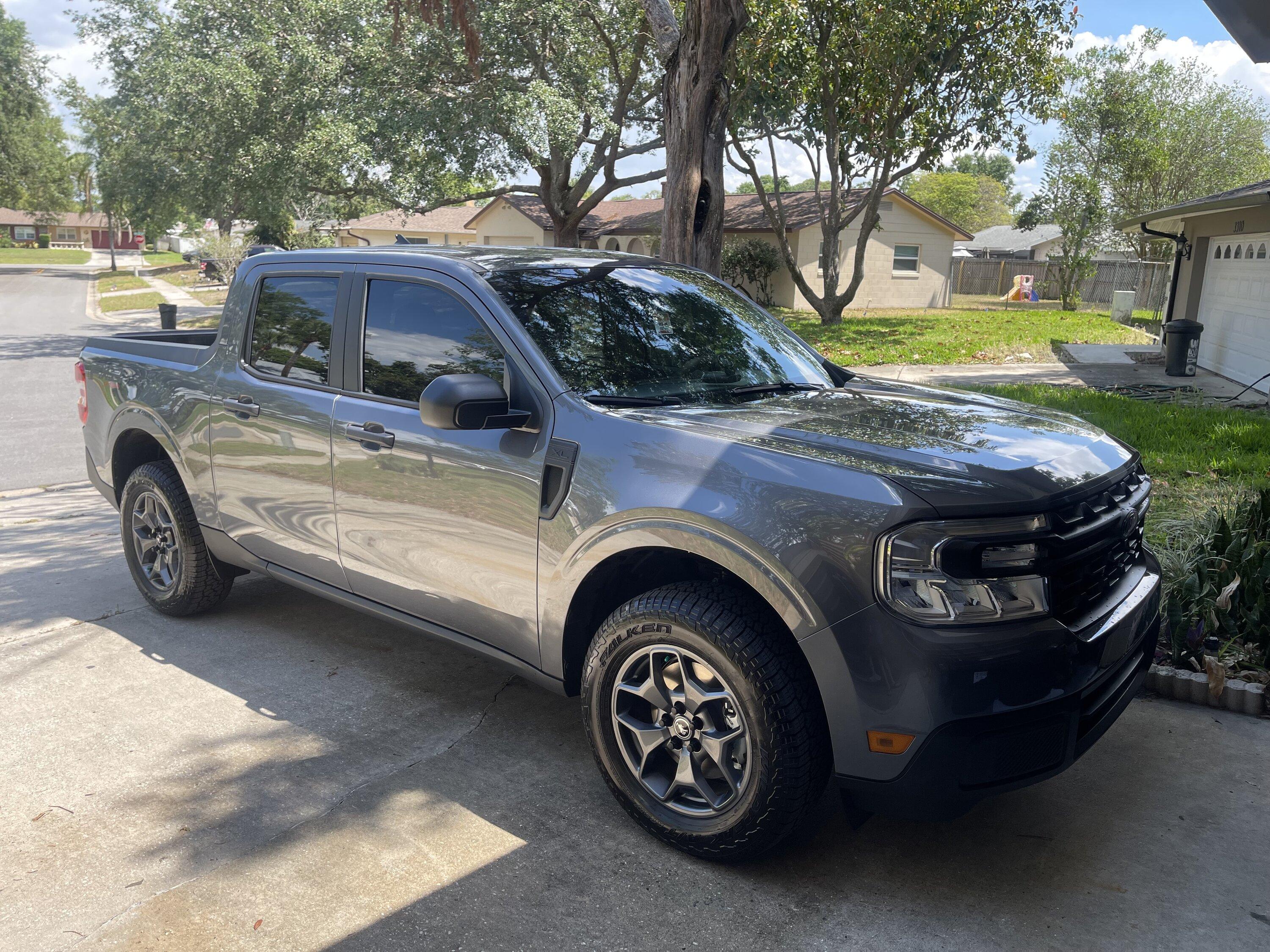

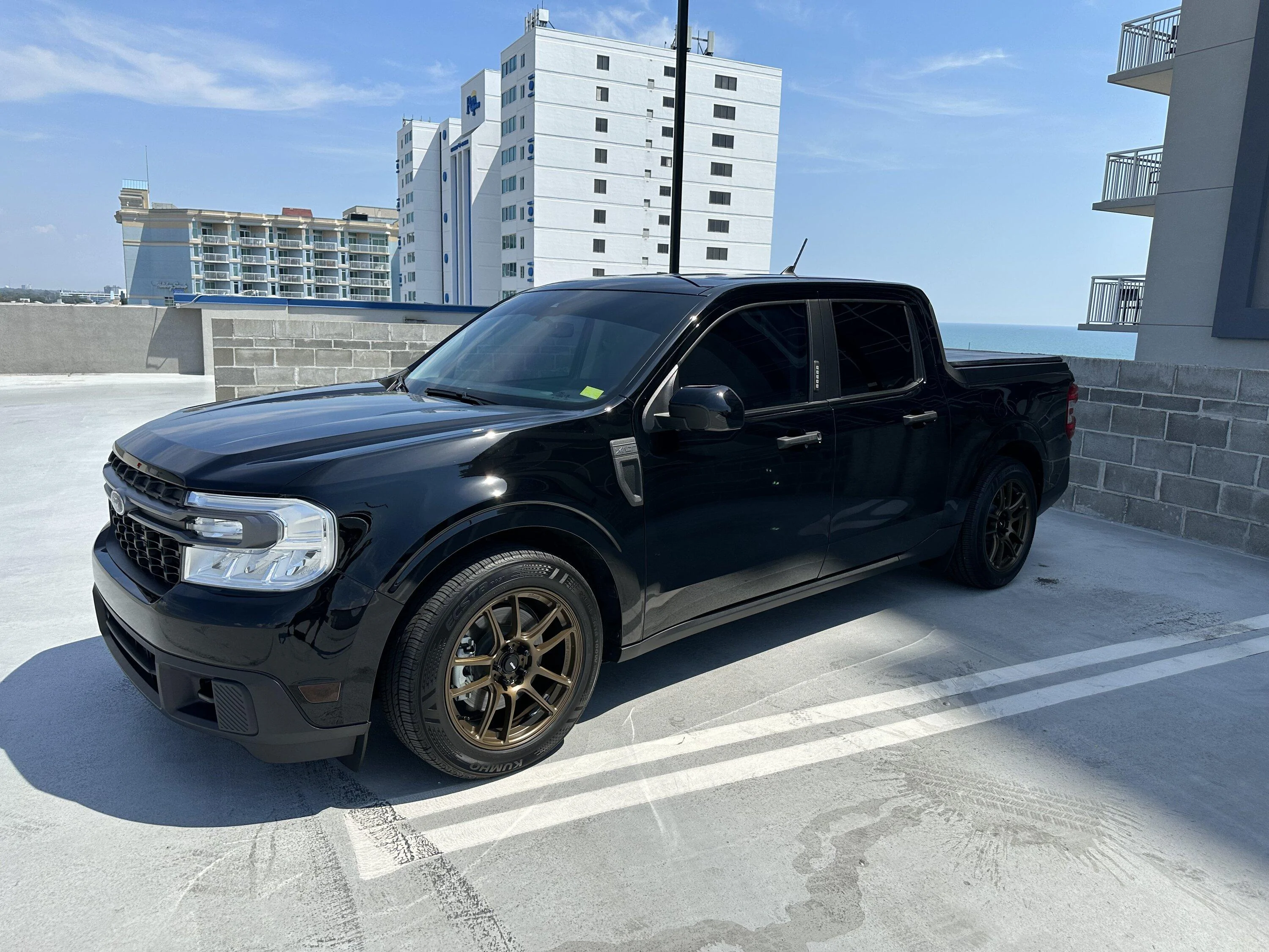

Funny how darker vehicles make the window tint look darker in photos. Mine is 20% on the sides and just a strip on the front. Legal limit in Fla. and still looks dark.
Looks great! This is the exact set up that I want; 20% on the sides and a 5% stip on the windshield. My night vision is too poor to do a full windshield tint.

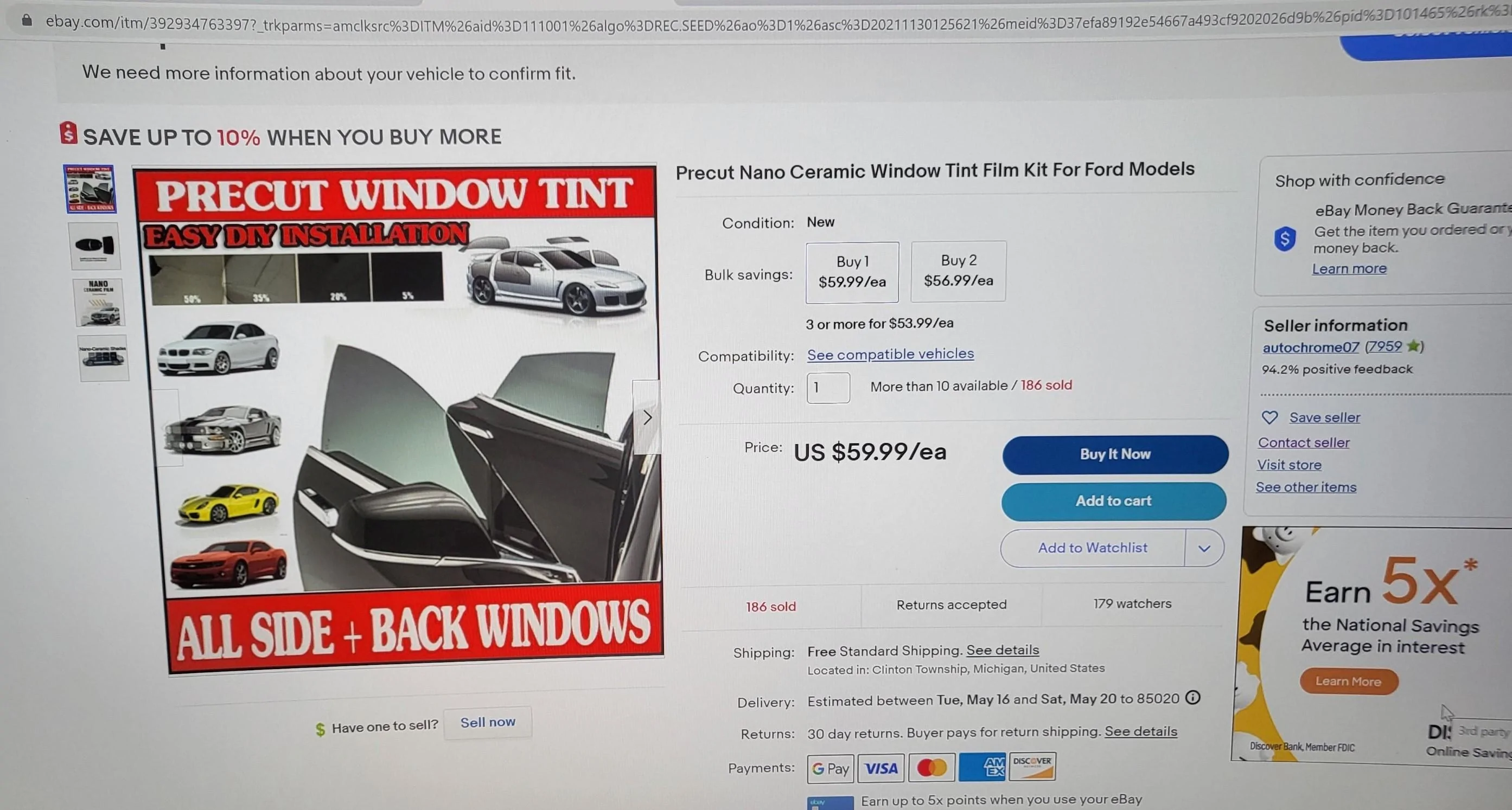

$850 OUCH! - I just tinted my upper windshield tonight. My Pre-cut nano-ceramic tint came in today. I went with 20% for the front 2 windows (35% is legal). I ordered 35% for all rear (factory dyed windows). This is the exact same thing I did to my Atlas Blue AWD XL a few months back. I will install all 5 windows tomorrow.
FYI...I paid $60 for all the Nano-ceramic pre-cut tint. Obviously saving a ton of $$.
Here is where I ordered my tint. (They also have pre-cut Nano-Carbon tint for about 1/2 the price).
Have an awesome day! 🤟

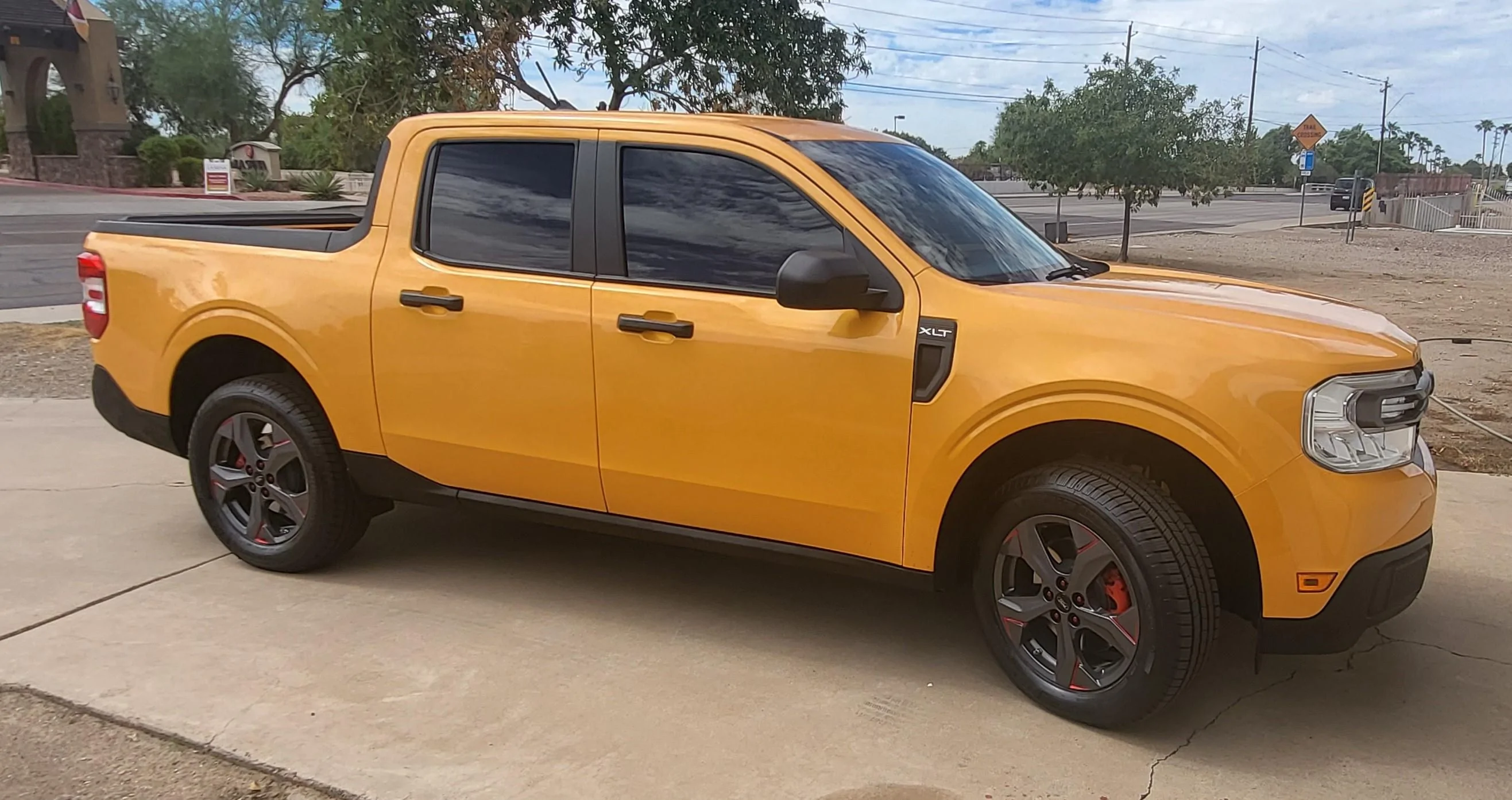

I put 20% on the front because I like it a little darker than the 35% legal limit (in AZ). I did 35% in back because if you add the 35% film to the factory dyed windows it comes out to very close to 20% looking all the way around. I did the exact same tint percentages to my Blue AWD Mav a few months back and it came out perfect in my opinion. I also wanted the uv & heat blocking capabilities in the rear as well as the front. I think next time I will try tinting the entire front windshield. I have never attempted to do that before. 🤟

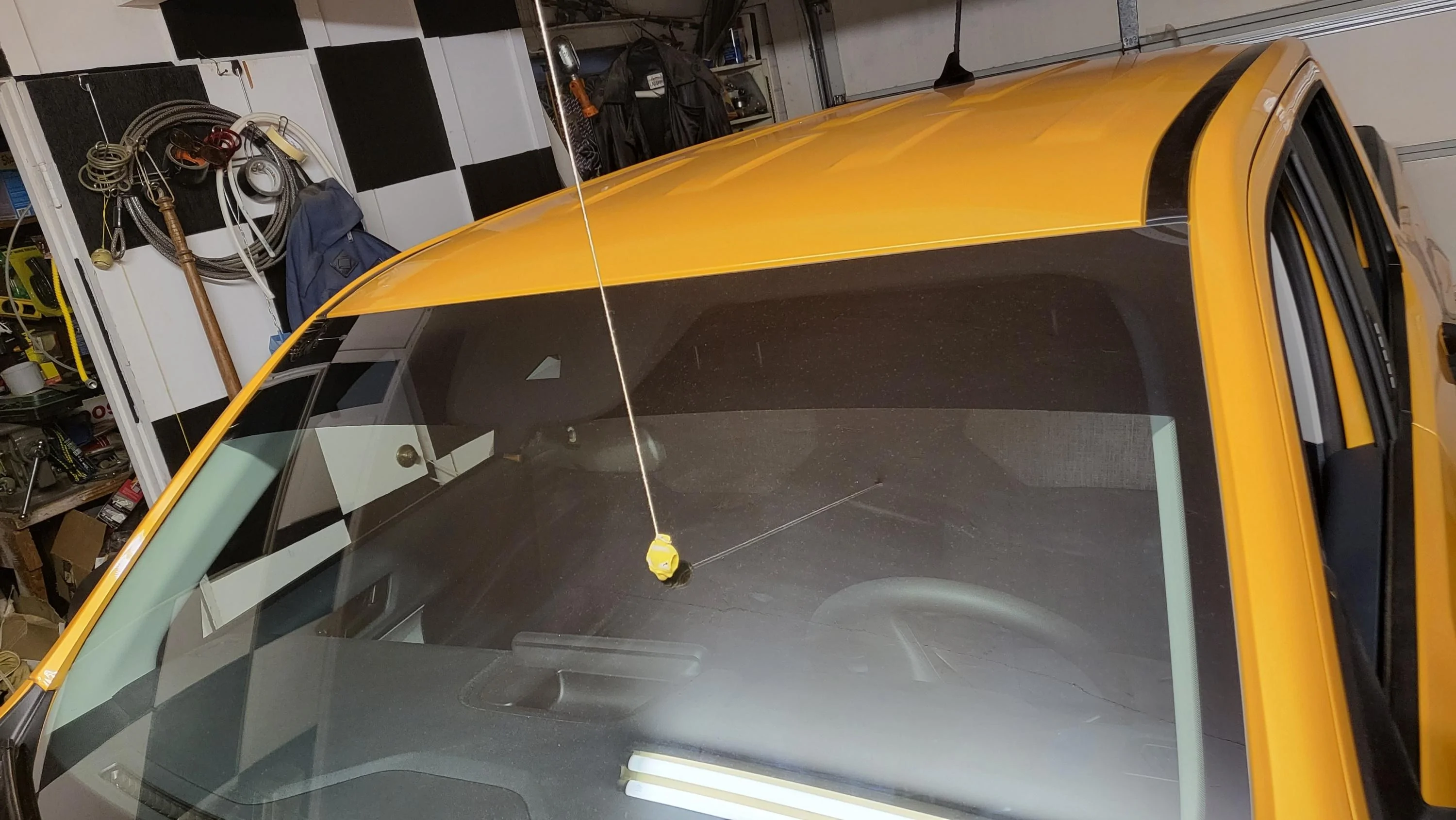

Finished installing my tint last night.

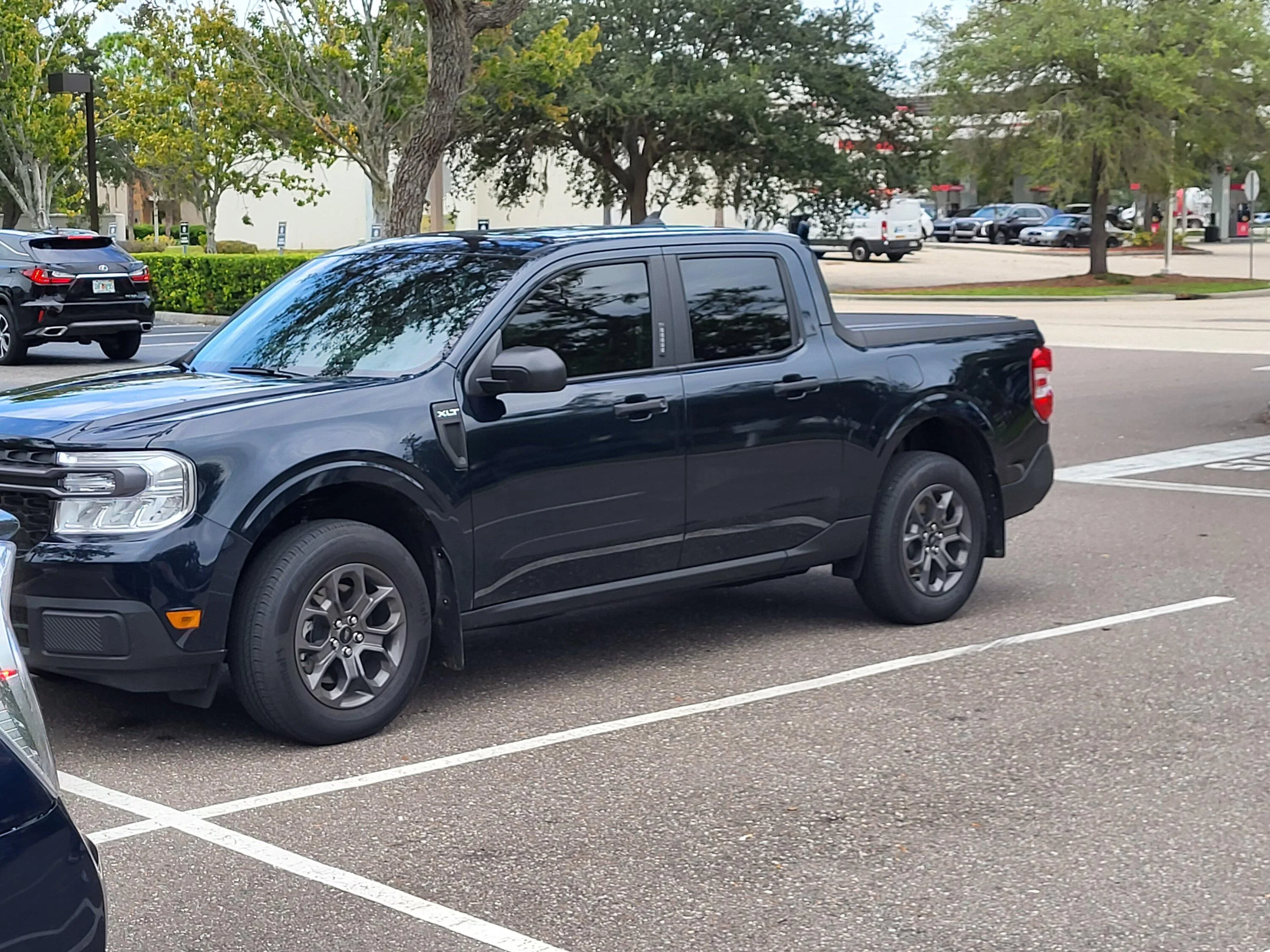

Well tint was not the reason UV and IR heat was. My dermatologist had heart to heat with me, most my issue are windshield time related . The IR heat is big thing in Florida. this was $850

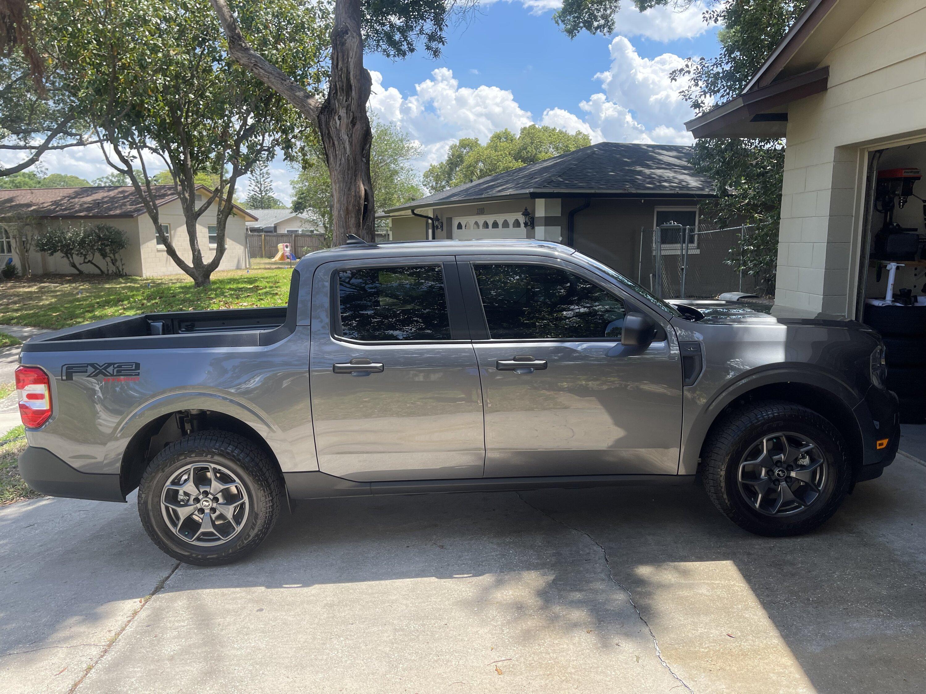

Yup, huge difference in comfort.
I had never tinted the fronts of a car before. I did the same percentage as the rears.
The truck stays noticeably cooler inside, don’t notice any night vision loss, and I can’t help but believe it slightly increases mpg since the AC isn’t working as hard to cool the interior.
I personally think vehicles look better with the side glass tinted the same.
