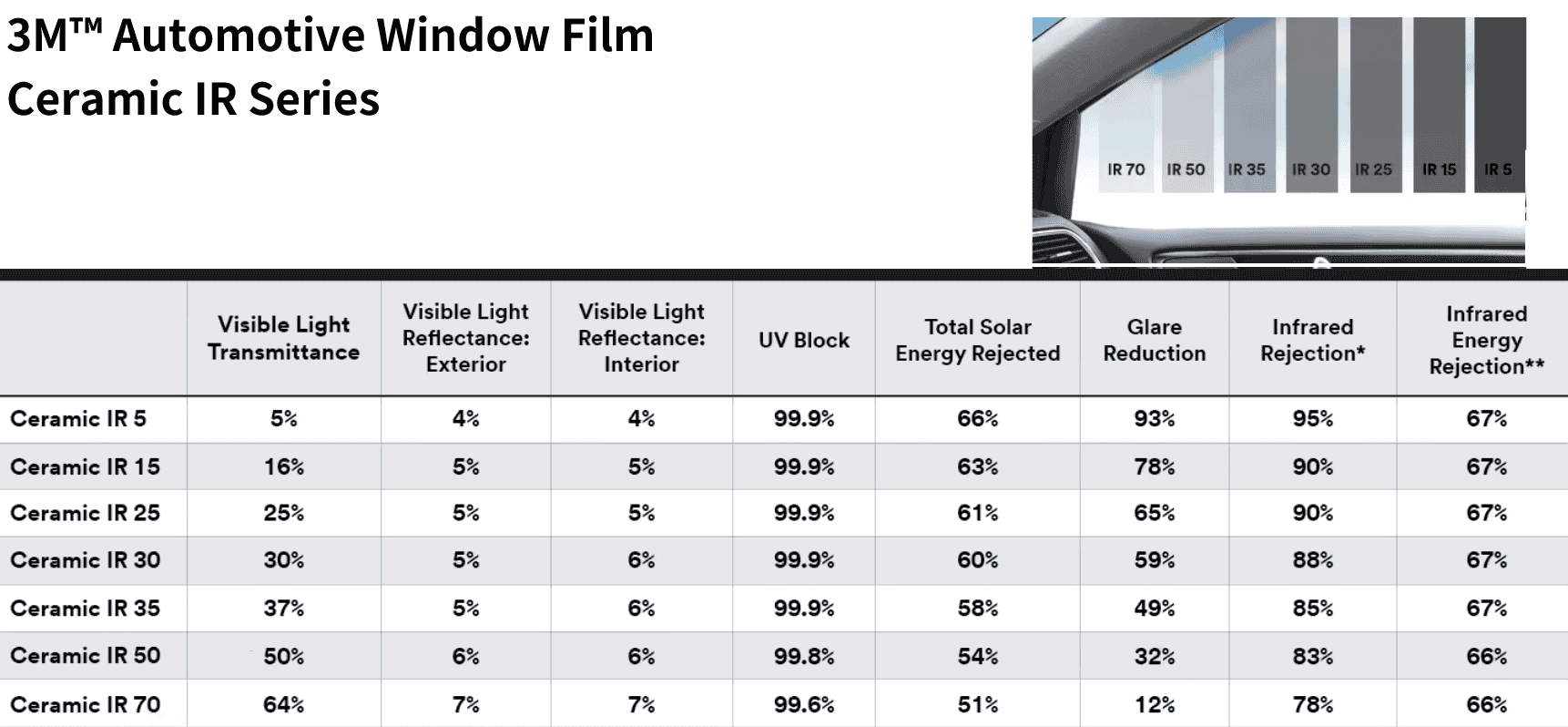

If anyone's interested, here's some data on various 3M ceramic films.
Ford Maverick Window Tint 3M-Ceramic-IR_Window-Tint

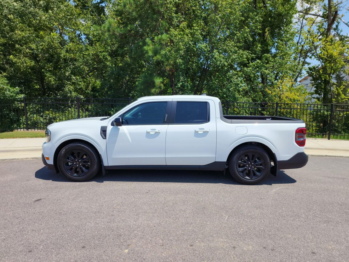

I had mine tinted with Ceramic Pro IR 45% a week ago. Of course, I went in and said "color match as best as you can, within legal limits, which I think is 35%". She said, yes, it's 35%, but all recent automotive glass has an inherent loss (this is where she took me to the black labeling on each piece of glass) and showed me the "at least 70% transmission" printed on it. NC is an inspection state and she said that her customers have had issues with passing inspection with 35% because it compounds with the inherent loss, causing it to fail actual measurements. They worked with the Ceramic Pro manufacturer who ended up creating a 45% tint that compounded within legal limits but close to 35% final transmission.
Personally, I think her story checks out OK.
Edit: She said to check out old school auto glass on classic cars, before all the safety crap came into play. It should be clear as ice and obviously different next to modern auto glass.
Ford Maverick Window Tint 20230806_125351-

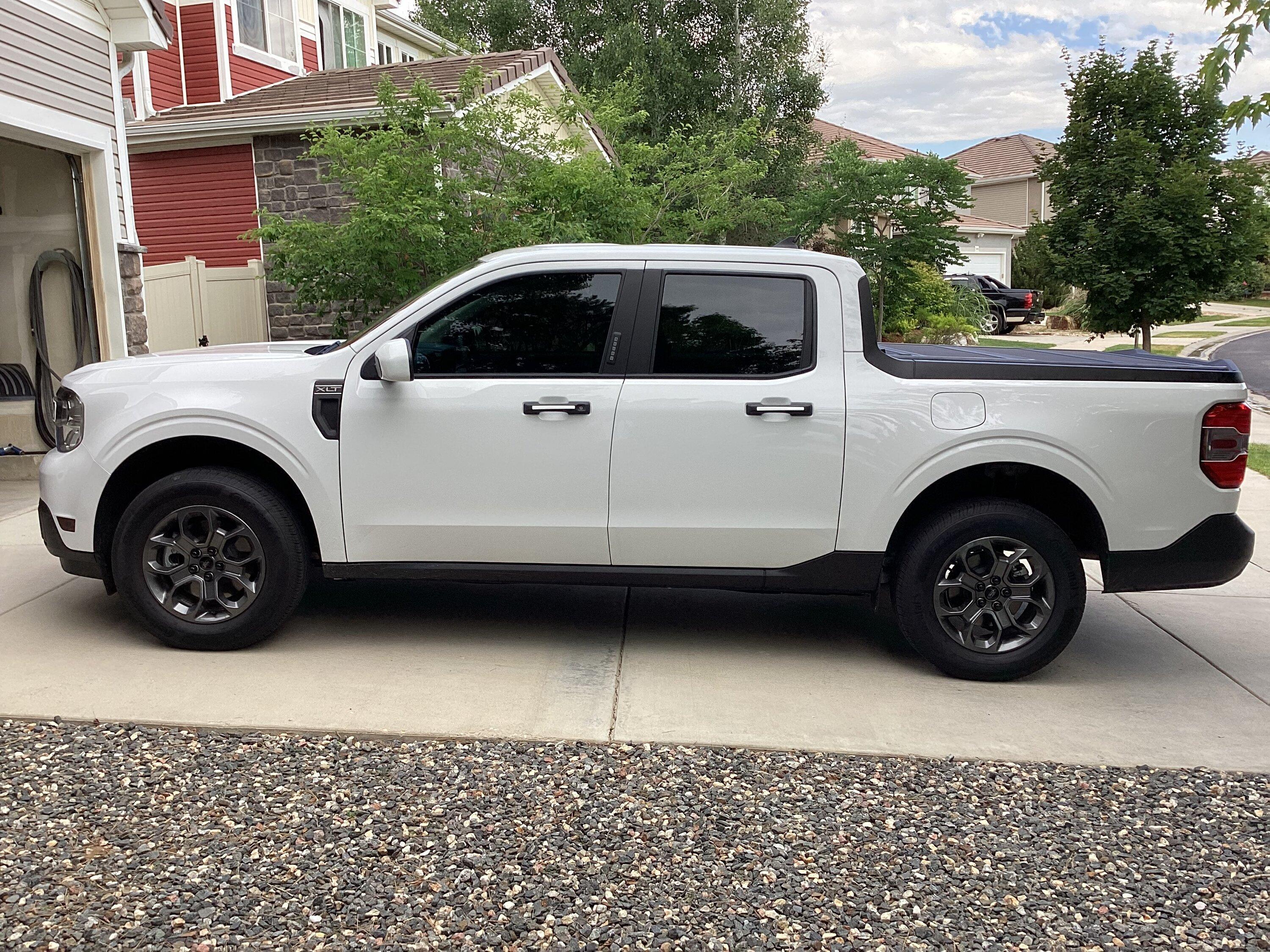

My factory rears measured 23%.
I had the fronts tinted the same percentage with a reasonably good film grade, one of the top brands, don’t remember which one, that is supposed to cut infrared by 65% or so.
I have decided that having the same tint front and rear looks better than just the rear half. The front tint matches the rears very closely.
During the day the tint doesn’t bother me at all, and I don’t notice it at night which was a concern.
Ford Maverick Window Tint IMG_0260
The infrared blocking has been extremely effective, a huge difference in comfort and protection from the suns harsh rays.
