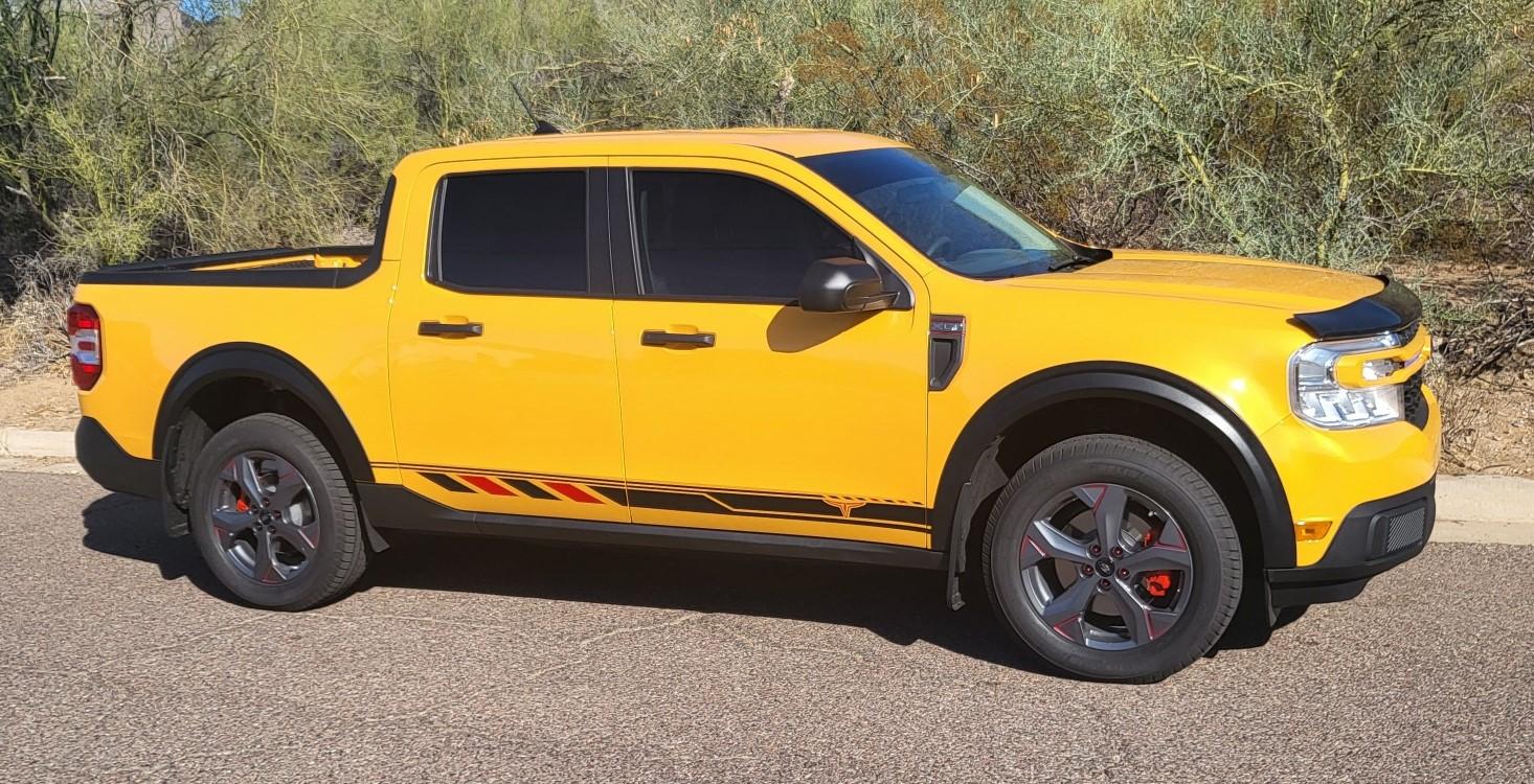

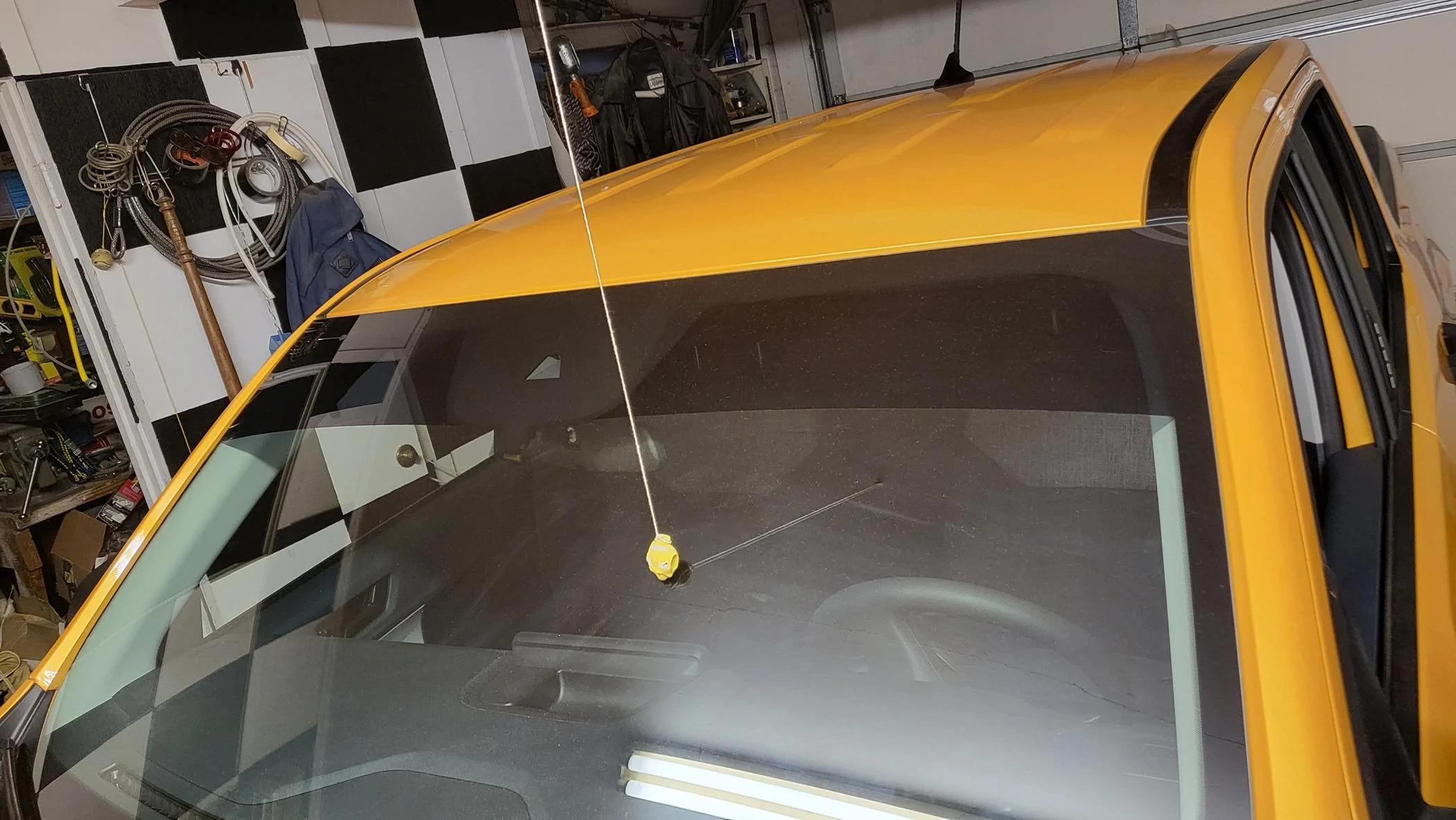

The rear factory windows are dyed in the glass. Yes you will need to put tint on all the windows. I went with 35% ceramic tint on top of all the rear (dyed) windows. Then I put 20% on the front 2 windows. That pretty much matches all the way around. I also did the top of the windshield in 20% (should have done 5%) but that was all I had on hand at the time. Good Luck with your tint.
