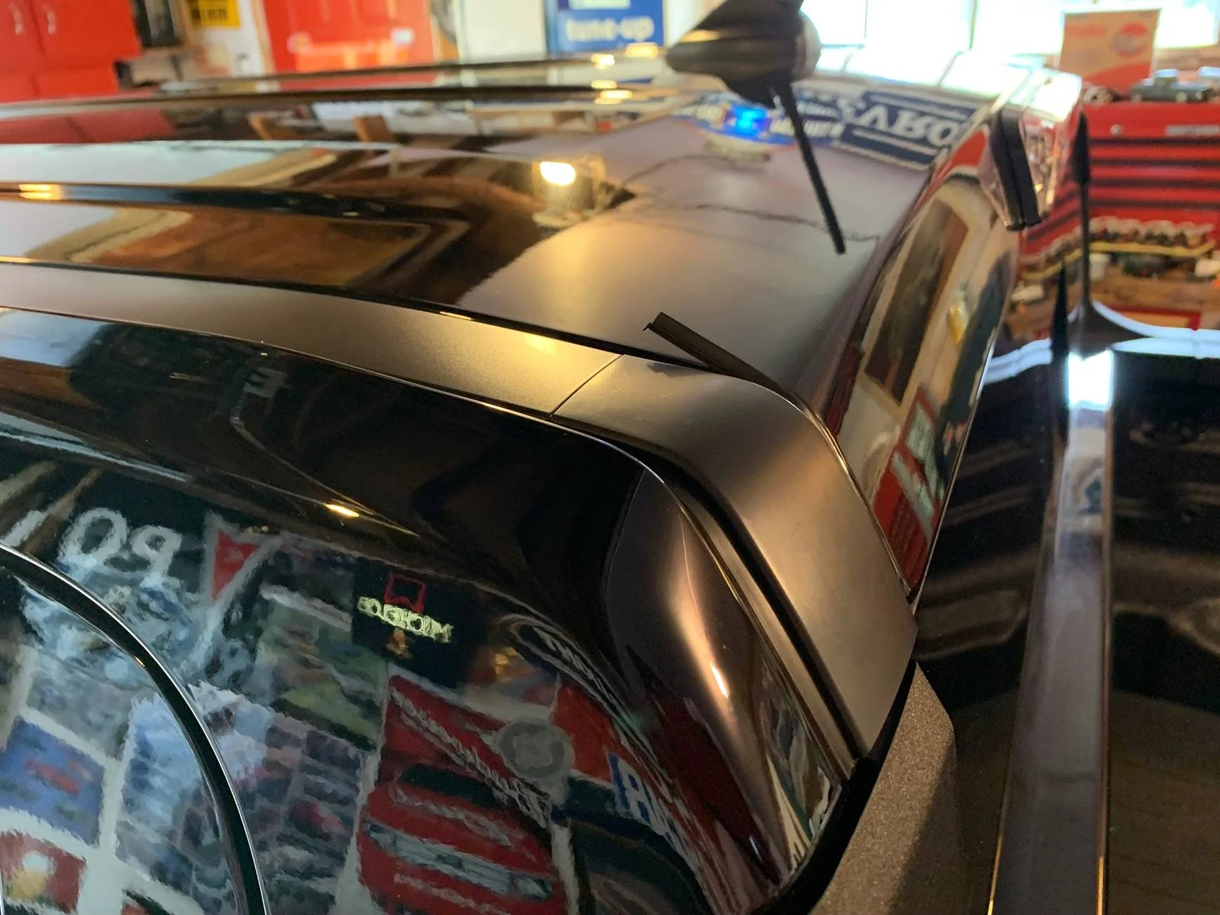

Hi there! I like keeping my new (2022) Maverick XLT Clean. I'm a little worried about automatic car washes. I just drove it through a new Royal Farms car wash. It's the kind where your car stands still and the rollers, waters, etc work around you. When I got home I noticed a small sliver of rubber sticking out on the roof. It looks like the large blow dryers at the end of the car wash were so powerful it lifted out the little rubber trim piece in the right rear corner of the roof water track. Has this ever happened to anyone? I pushed it back in, but it is not very tight. My guess is a special tool is needed to push the rubber strip in tighter. It's really only a small, cheap, black strip 2-3 inches long and 1/4 Inch wide. Anyway, seriously thinking of hand washing at home. I love my truck, but I really think they cut corners on some things. I'm seeing a lot of car washes pop up everywhere these days. My guess is some vehicles are just more delicate than others when it comes to high power water, brushes, air, etc.

Mine happened within the first few months and they had to remove the headliner and a few months later the other side did it & never fixed it so I always use car washes (1 still is fixed and the other isn’t) and I’ve gotten over 92k miles since I bought it new in 2021. So if you get it replaced under warranty shouldn’t be an issue but yes they did have early problems.

I had a issue with that piece as well as some others on mtc . It wasn't caused by a car wash but a manufacturers issue . I pushed it back down in slot and put some clear silicon caulk on it to keep it down . problem solved . you can get it fixed at dealership under warranty .

I don't use the automatic washes but the same thing happened to me with the hand held sprayer and I'm not tall enough to spray the high pressure directly on it. I just push it back in when I'm done.

Use the Permatex adhesive - will expand contract in weather and lasts a very long time
I fixed mine too. Unfortunately the black piece at the end snapped in the removal process but I was able to glue it back together.
