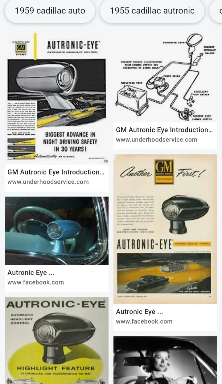

Since it's been pointed out on another thread that I'm old.😲
I wonder if, something like they had in luxury cars of the 50s and 60s could be used with the cheap 12 volt relay system?
Ford Maverick Can I tap into the highbeam circuit for ditch lights? 20260716_120259

I like this idea but I agree it does not fit with the OP intent.
Haha! Remember seeing those on cars when I was a kid, always thought they were cool!
