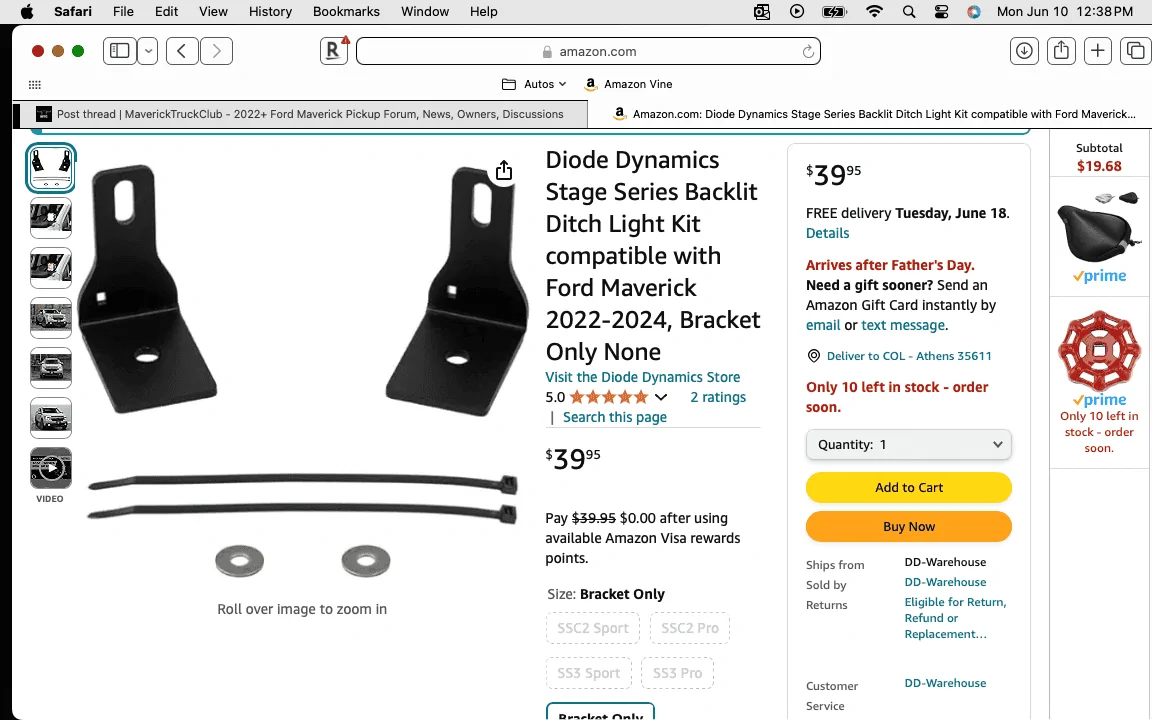

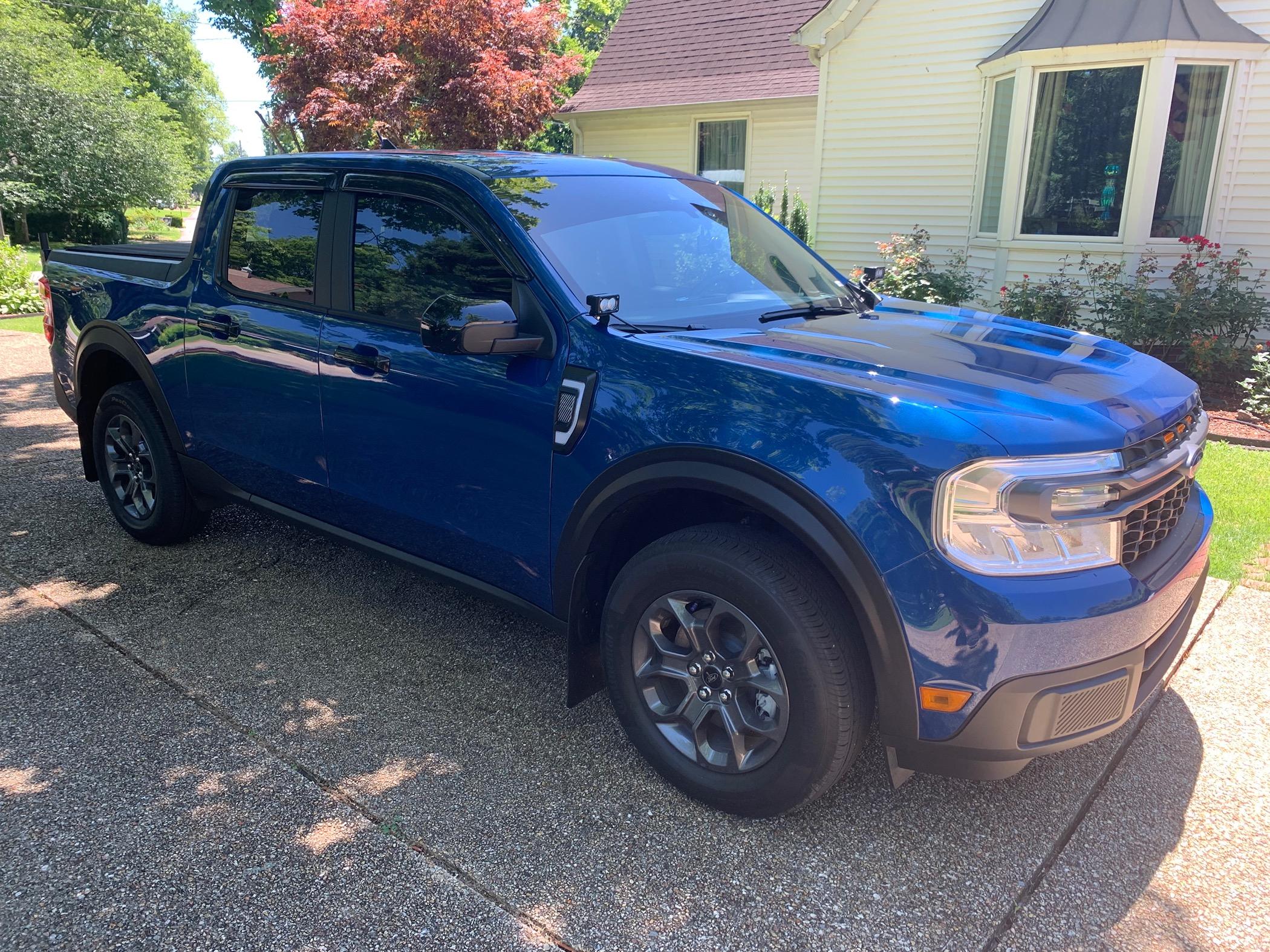

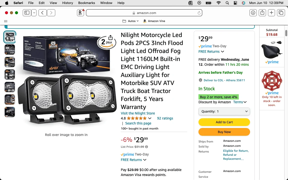

I just completed the installation of a pair of ditch lights on my ’24 hybrid XLT. Wiring goes to my under the hood control box for my interior switch panel.
Ford Maverick Ditch Lights Installed IMG_1683
Ford Maverick Ditch Lights Installed Screenshot 2024-06-10 at 12.38.10 PM
Ford Maverick Ditch Lights Installed Screenshot 2024-06-10 at 12.39.37 PM

I found one set just a coupl of dollars cheaper on Amazon. They would have placed the lights about six inches further toward the centerline of the hood. My thought was that would mean a lot of the light reflecting off the hood. I preferred the outboard position of the mount I bought. I’m giving these lights a try. If they don’t work out, I’ll step up to something else.
