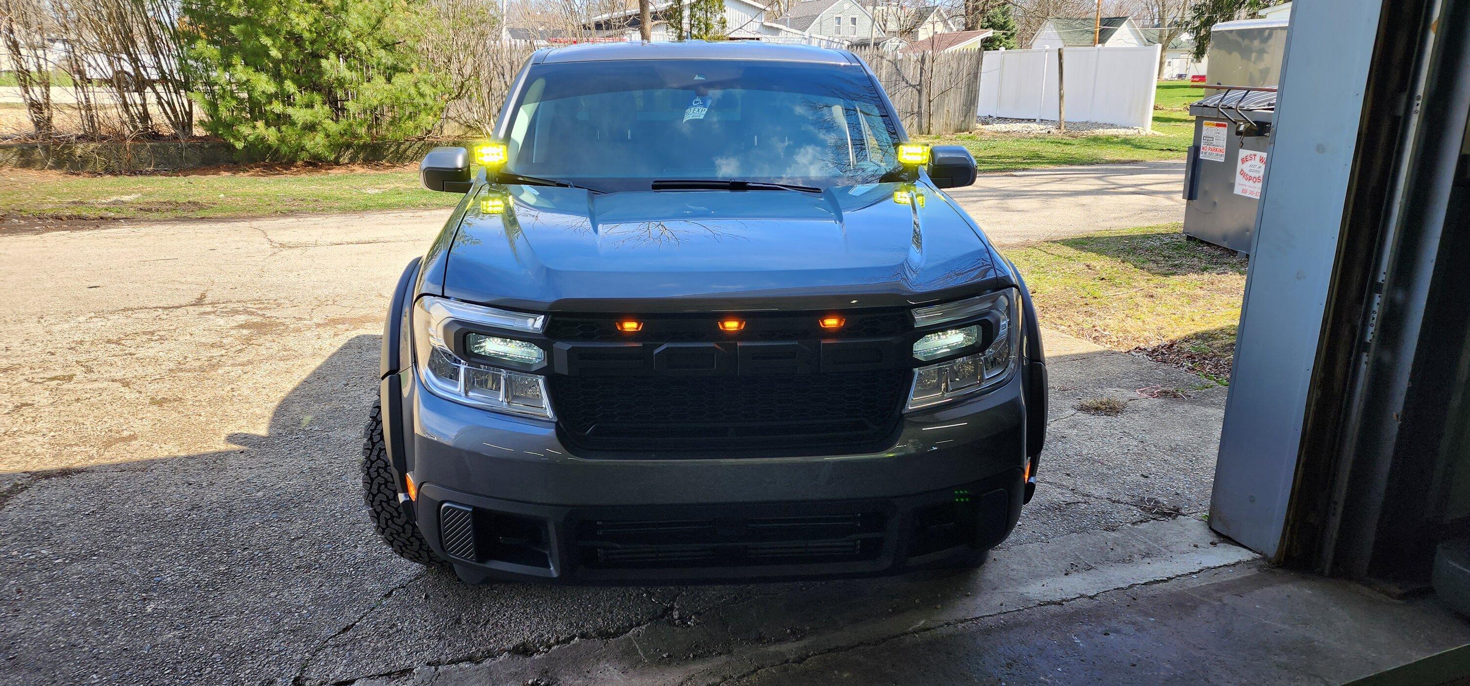

I just installed the cree lights from f150 led's recently. I don't have any issues with hood clearance.
Just so you know, Cree does not make lights. The make the LED chips in the lights.

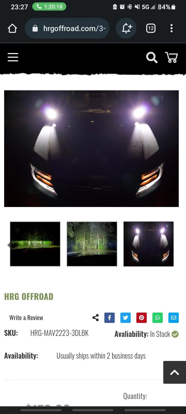

I've had these in my cart for a while but havent pulled the trigger yet.
They dont look safe for the paint and I'd be worried if the hood can still open or not.
I've been patiently hoping to see more aftermarket LED solutions pop up for the Maverick
I purchased a set of them . covered the area with 3m clear tape . They will not work in my view ,took them back off after fiddling with them for hours trying everything to make them stable . The Maverick hood if you look has a round bulge about a quarter in from the edge . The mounting plate and screws fall on top of this . So it just rocks back and forth or try's to slip off when tightening . They are sitting in a box in my garage.

I have these. Can't recommend them. My lights are heavy, but even still the steel is not thick enough to minimize vibration. It's thinner than the JJC brackets.

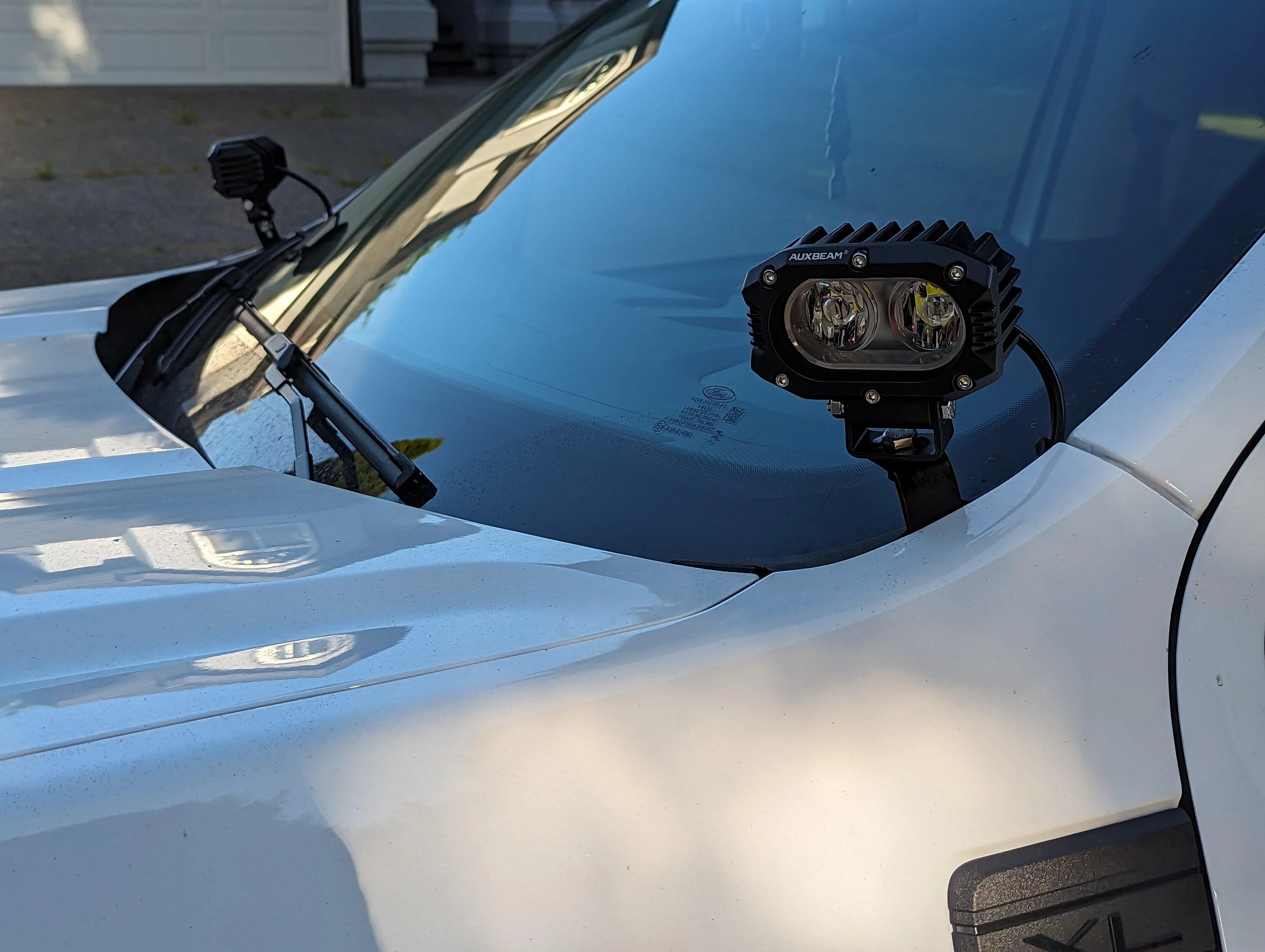

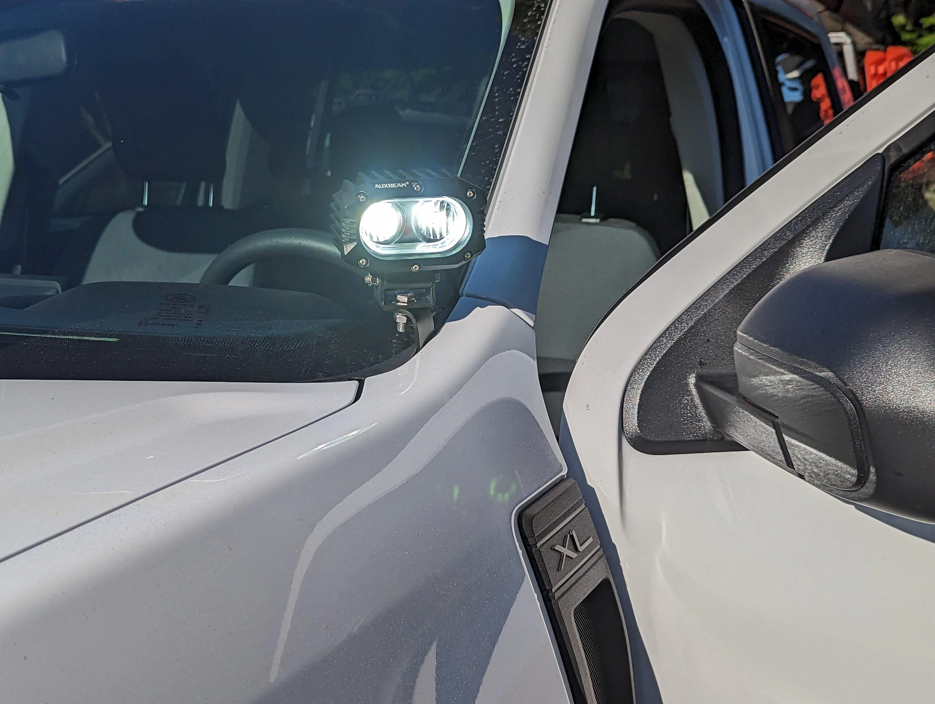

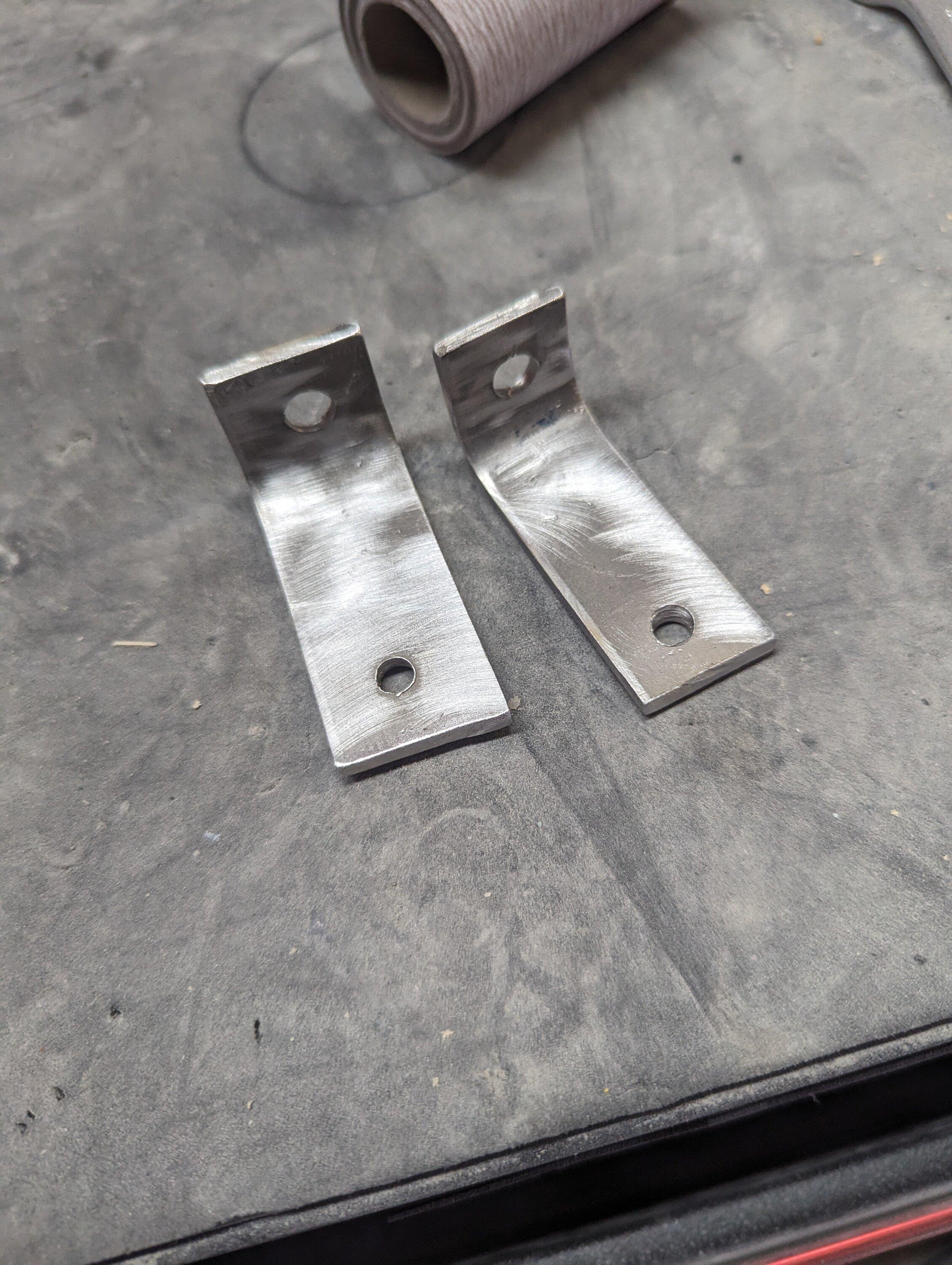

Here are some diy brackets I made for the fender, 3/16th steel pretty small lights but haven't noticed any vibration or bouncing with them.
