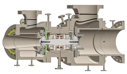

The exhaust just acts as a turbine nozzle. High pressure/heat gas in the turbine inlet gets converted to mechanical energy as it drives the wheel and then expands through the exit. You need a change in pressure for flow, so the idea is to minimize exhaust exhaust restriction to extract the most energy possible in the volute. A constricted exhaust can even lead to premature thrust wear on the turbine bearings.
That's just the basic explanation. Then you have to consider turbine volute and exhaust nozzle geometry for spool and efficiency.
Check out this industrial turbine cad with the diverging exhaust nozzle (left).
