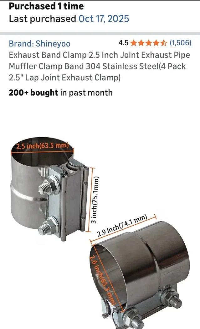

Was this the resonator you used? https://amzn.to/3KtHro7
Did you have to use a 2.25 to 2.5 adapter for the catalytic converter side? I'm asking because the install instructions say to use a 2.25 clamp on that side, so is the front pipe 2.25"?
Thank you for this write up!
[/QUOTE]
Yes, that is the resonator I installed (Great build quality on the outside).
The clamps I used are pictured below. However, I did not clamp to the 2.25in OEM pipe - I clamped to Borla 2.5in pipe on both sides.
You will need to find a clamp that steps down to 2.25in.
Enjoy the nice sound. The name says “ultra quiet”, but is more of an ultra quiet loud low rumble if that makes sense!
