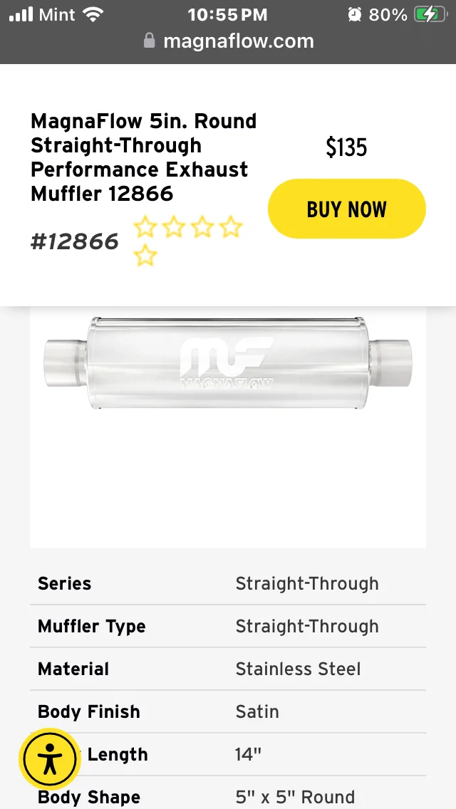

Just measured my MRT:
14" inlet to outlet.
Straight through.
Oval, 5"x6"
At least your not going with the Old-man Suitcase Magnaflow, your solution should still allow it to make some noise. ;)
Is that a 2.5" in and out to fit your pipe?
Straight through.
Oval, 5"x6"
Yep, 2.5 in/out. The muffler shop ordered it & will weld it in. I’ll listen to it before they weld - but I expect an improvement.

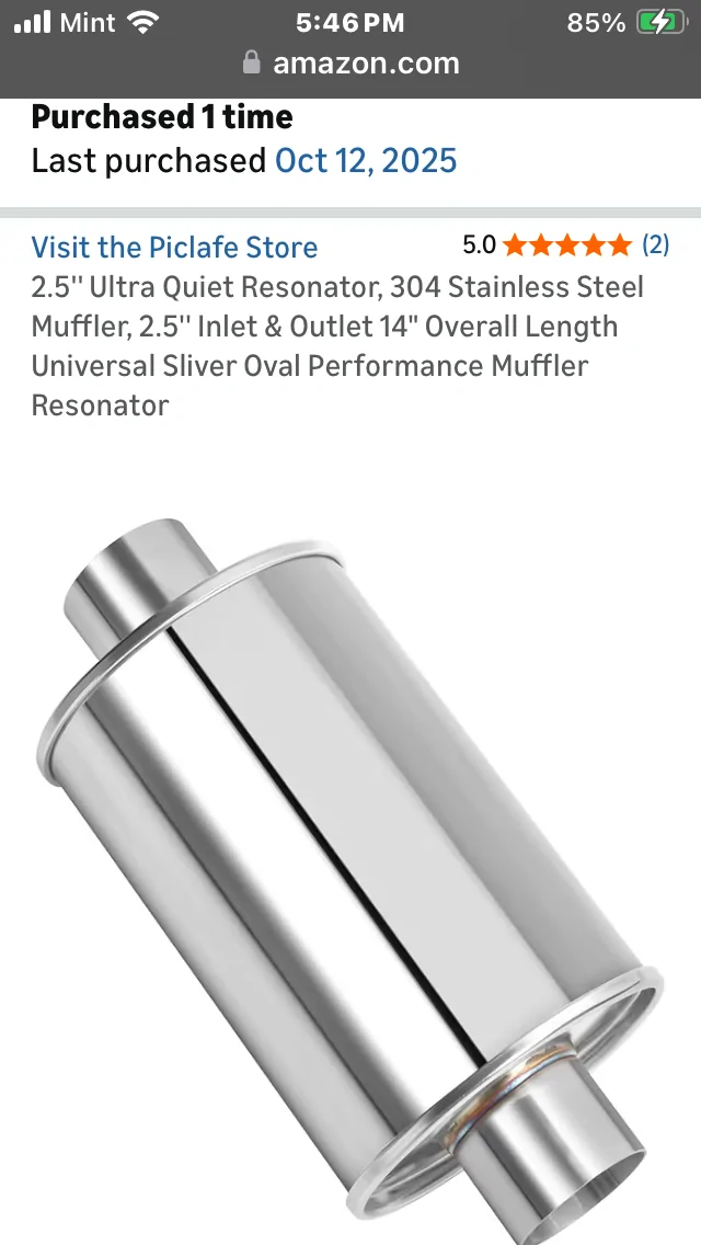

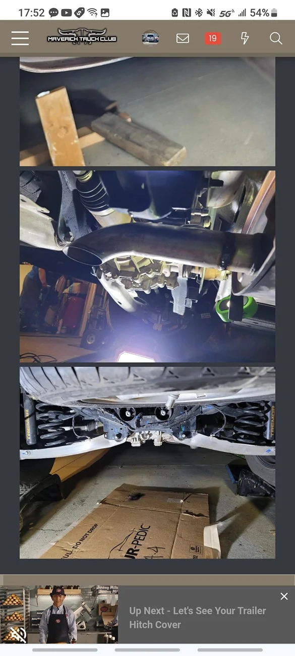

Ok, my final verdict on the Borla Type 3 clamp-on catback exhaust I installed: Thumbs Up! (with a modification)
Alone it was WAY too loud & droned painfully at most rpm’s. Two neighbors politely made note - so I can only imagine the chagrin of the other dozen neighbors who did not confront me.
So I clamped on an additional small resonator/muffler and now it sound wonderful. Deep & low pitched not raspy LOUD. I can now hear the blaring radios of other drivers as I accelerate from a stop again. Traffic sounds are now audible & I can hear my fake engine sounds again yay:)
The 5in wide/22in long Magnaflow muffler was too long to fit on the Borla - so I used a smaller one found on Amazon. Pic below:
Ford Maverick Borla Type 3 Catback installed IMG_9681
I do not have the equipment or talent to weld, so I clamped it on. Probably will visit a muffler shop to weld into place someday.

I'm glad you found a muffler that would make this livable, in the past I've had really good luck with the Vibrant Ultra Quiet Resonator (it really isn't ultra quiet) for killing drone and taming obnoxious noise levels.
The Vibrant Ultra Quiet was my choice but could not find a 2.5in. This knockoff looks like it is a Vibrant though. Good quality.
Ford Maverick Borla Type 3 Catback installed IMG_9711

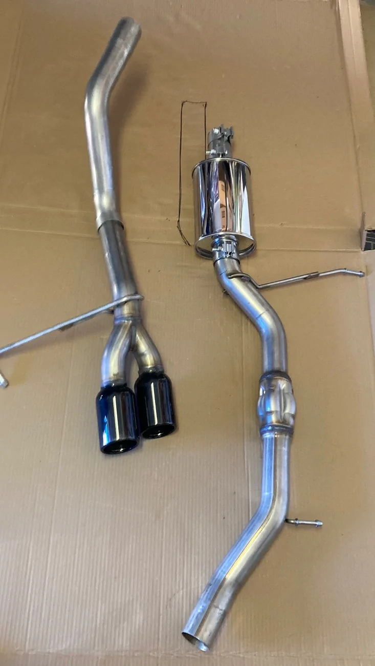

Finished the install of the Borla Type 3 catback today - and the days of hearing “fake engine” sounds are over. Delete the muffler = real engine sounds take over.
I drive in silence (no radio etc) and have enjoyed the “piped in” engine sound. I drive almost entirely in manual mode using the paddles. The cool fake engine sounds I heard were not the sounds the folks outside heard. They heard the quiet regular muffled Maverick.
No longer. Both me & the folks outside hear the “Polyphonic Harmonizer”. It is like my private fake engine noise is now on external bed mounted speakers.
I’ve only done a short couple miles of traffic lights so far. This setup may be too aggressive sounding for shy little me. I’m taking a long twisty turny ride tomorrow out in the sticks - I’ll see how that goes!

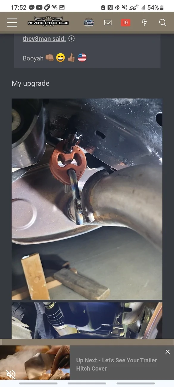

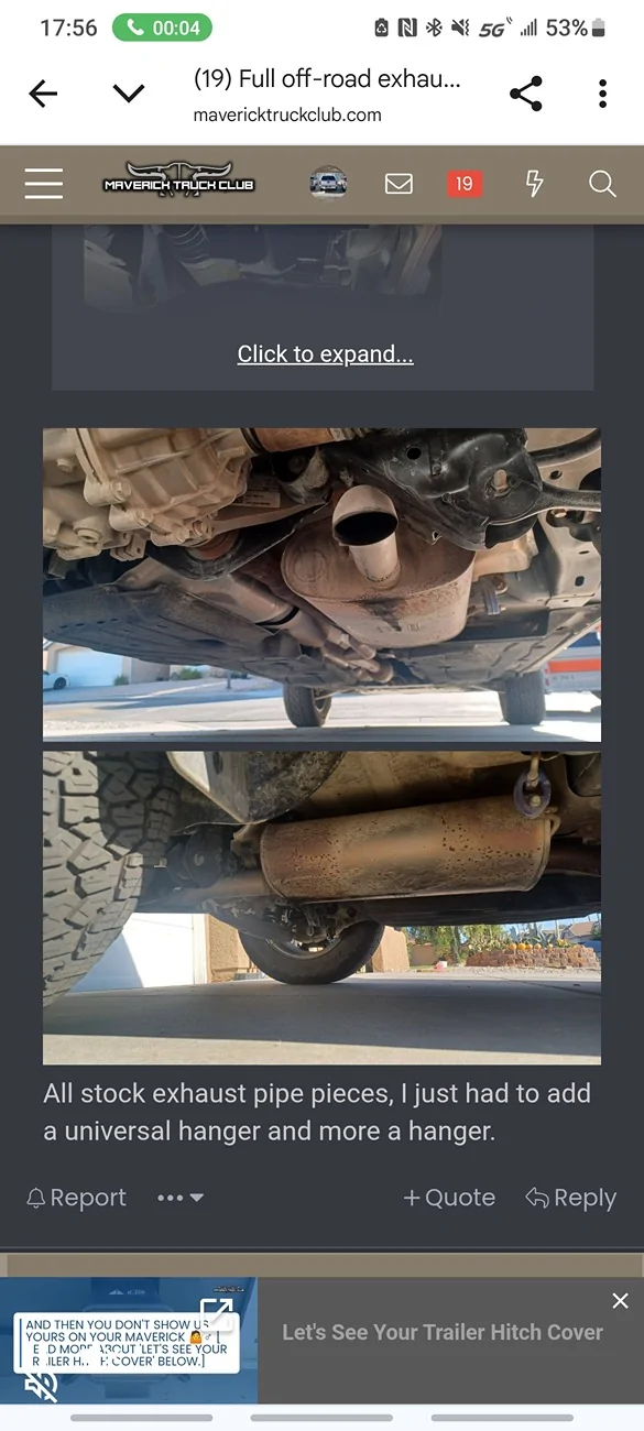

I just chopped my stock exhaust and it sounds fine 🙂. I know my 5.0 / 7.3 aspirations don't match my pocket book.
